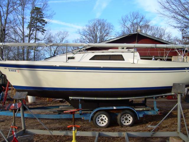

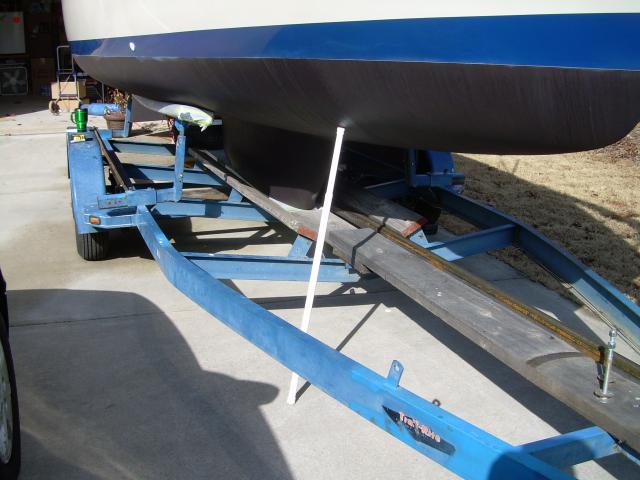

on my modified trailer I measure 162" from the back of the front axle to the upright of the wrinch assy. the hook is 52" above the frome and the bow support roller is 56" up from the frame. add 16.5" if you want to measure from the center point between the axles ( twin axles) See my post for jpg of my 26 trailer ....kdssail@hotmail.com
