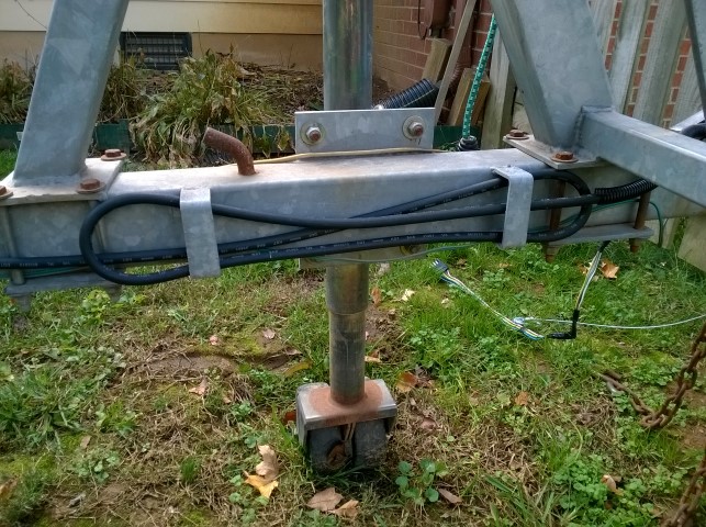

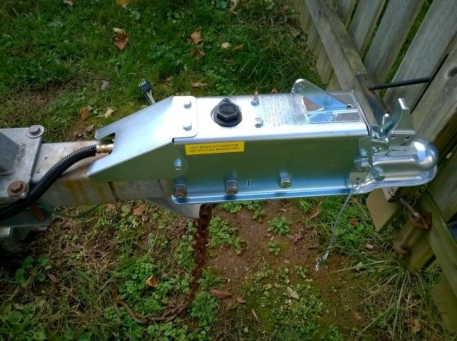

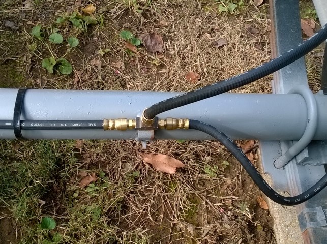

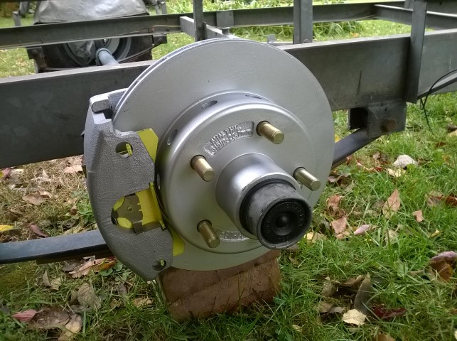

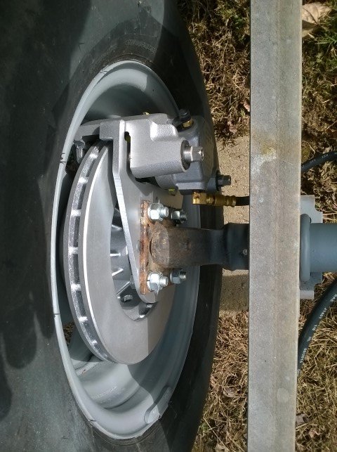

Just reporting back on the trailer brake upgrade. Not a bad job- glad I did it with the boat off the trailer. I replaced all the brake lines with flexible rubber lines for ease of installation. I measured for the long hose with the tongue extended so the extra length could be folded up. Flex lines worked well folding into tight radius. For future reference for other H240 owners here is the part list I used (sourced from Eastern Marine, total cost about $450):
- DeeMaxx 10" disc brake set with integral hubs (plated version, not SS, since I'm in fresh water (3,500 lb. axle)
- Titan 60Z disc brake actuator with solenoid
- DeeMaxx flexible brake hoses: 260", 72", and 16"
Replaced the bearings since the hubs were new. I used the old brass "T" fitting that is welded on the axle as it was in good shape. I also repainted the rusty axle while the brake lines were off. I had to rotate the brass hose fitting on the calipers to clear the trailer frame- I was able to turn them about 45 degrees to point down. Also had to re-wire the trailer lights to a 5-pin connector for the backup solenoid, and on the tow vehicle, patching into the backup light circuit.
