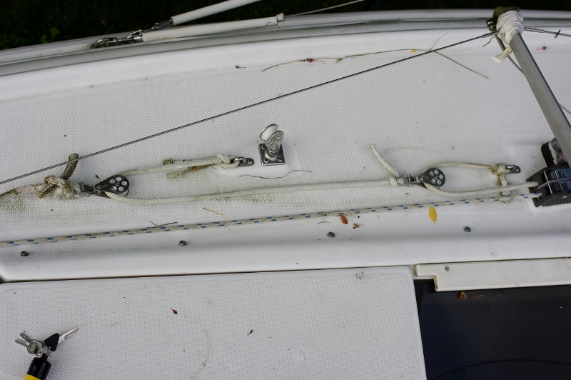

Does anyone have pictures of a 3 block configuration? My book & all the pictures I can find only show two blocks. Also, is that a 3/8 or 7/16 line for the on deck pulleys? I replaced my uphaul line with 7/16 amsteel blue. I now have the centerboard with full range of motion, and the haul is free (when there is no load on it), but the centerboard cannot be raised on the topside by hand & my old line was too short to use the winch. Thanks

3/8 line on top. I suggest one line 18 to 20 feet long. Take a photo of the deck and let me look at it. Then go from there.

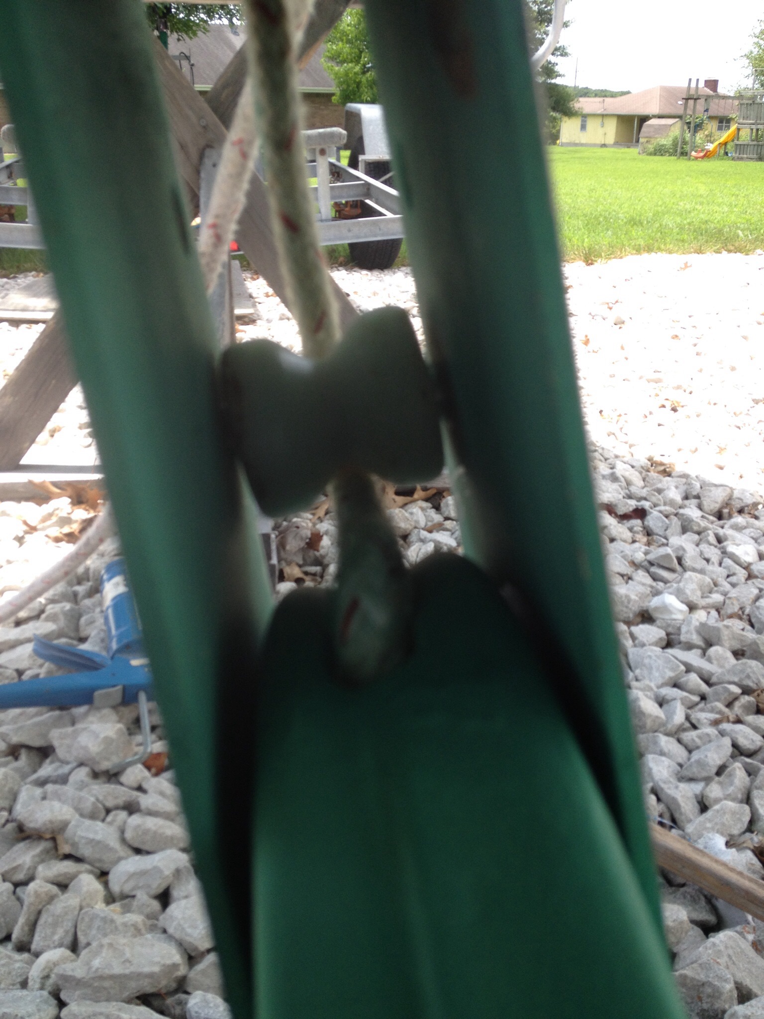

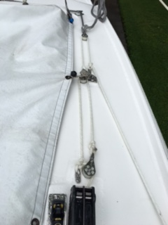

This is a picture of how my uphaul system was configured before I changed the centerboard haul line. I think I have it back the same way though I am sure it needs adjusting. The 7/16 line to the board travels freely, and the centerboard has full range of motion. I went under the boat (it is still on the lift) and manually pushed the CB into the trunk (trailering position) while a friend used the line stopper on the deck to cleat it off. When I took my hands off of the board, it slowly swung down about 6 "- 8". Could my new 3/8 braided nylon (not three cord) line have that much stretch? Also, the uphaul system (even with the winch handle) doesn't move it. Thoughts? Thanks

image.jpg The board will sag with no support under it out of the water. This is normal. In the water; although it's heavy, there is enough buoyancy to help it come up. You'll hear a "thunk" when you raise it quickly while in the water. It's a class III lever with with lots of stretchy line and flexible fiberglass.
Here's how the assembly looks on the older version the 23.5.

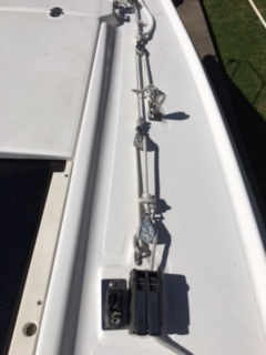

Interesting that your uphaul seems to use 3 single blocks in a cascading arrangement. My '98 240 only has 2 blocks- see photo below. I think you have 6:1 purchase with that setup vs. 4:1 for mine. If there is sufficient travel for all the blocks I think you should be OK.

It worked! Thanks to all, especially Dave Condon, Caverun, and Dennis Kitchen. I was able to use the three pulley system and with just a little push from underneath (equating buoyancy) it seemed to do fine. Fair winds & following seas.

This is very close on my adjustment, but I may have to tweak it once it is in the water. Thanks again to all, Don
