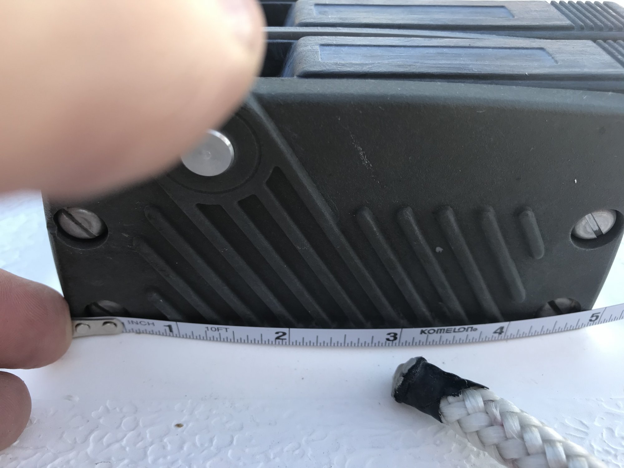

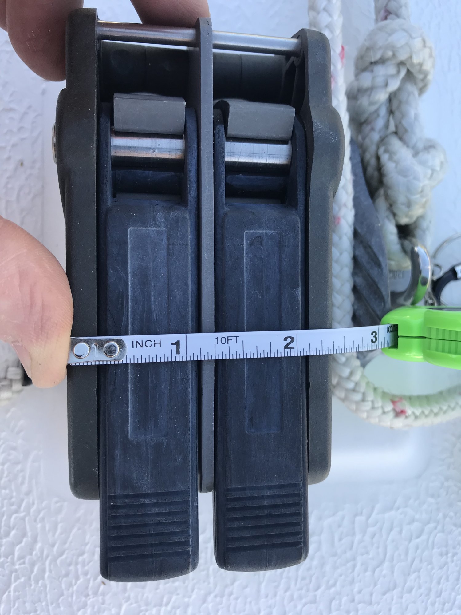

Yes I've done it. I added three additional clutches on my port side. Which made room on my starboard side for the lift line. I ordered the clutches here from the SBO store. Take a measurement of the space you are going to put your clutches and then contact @Dave Groshong. He is very patient and will talk you through ordering the right part the first time. (Thanks Dave for your past help).
