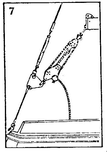

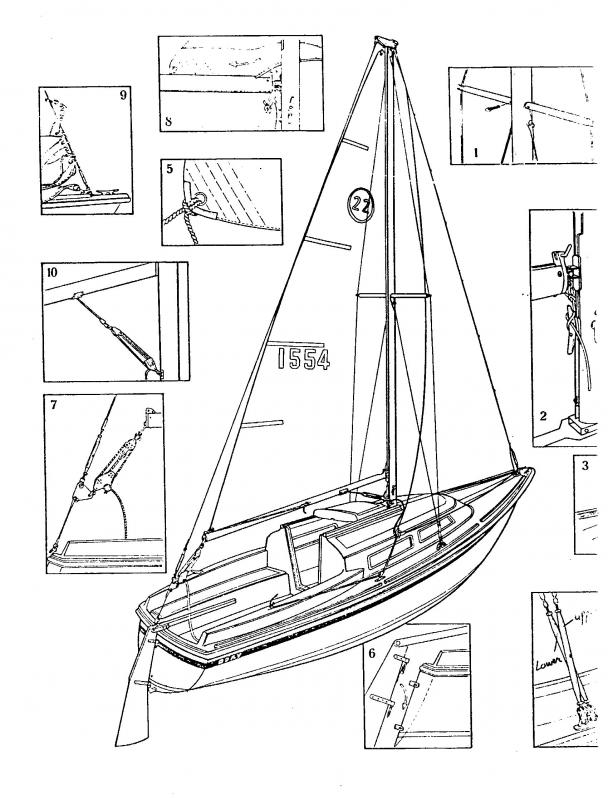

Excerpts from the Owners Manual:
Attaching Boom to Mast
Slip the gooseneck, which is on the forward end of the boom, on to the track on the mast (See Fig.2). To hold up the after end of the boom, attach the Boom Hanger (short wire on Backstay) to aft end of the boom.
Mainsheet

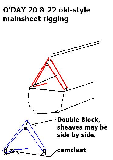

Old style (1972-74): Tie or shackle the end of the mainsheet to the becket on the top of mainsheet block (near stern). Thread the other end through one sheave of the double block on the end of the boom, then through the block near the stern on the other side, then through the other sheave of the block on the boom, then through the first block and the attached camcleat. Tie a figure-8 stopper-knot in the free end of the sheet.
Newer style (1975-83): Take the free end of the mainsheet, thread it through the upper sheave on the block attached to the triangle plate on the Backstay, bring it up through the block on the boom, then back down to the bottom sheave and through the camcleat. This type of mainsheet arrangement frees up the cockpit considerably. Tie a figure-8 knot in the end of the mainsheet so you won’t lose it.
(See Fig. 7)
To Hoist or Raise Mainsail
To raise the mainsail insert battens and then starting near the gooseneck, feed the foot of the sail, clew first, into the slot on the boom. The pin in the gooseneck slips through the tack of the sail to hold it in place. Draw the foot of the sail out along the boom until the foot is tight. The Outhaul line should be attached to the clew of the sail, then passed through the hole in fitting on end of boom, then cleated on boom cleat which is located approximately 2/3's of the way up on the starboard side of the boom. The cleat is located here to permit the crew to change the tension on the foot of the sail while sailing. A "Block-Action Outhaul” is a help here as it greatly reduces the friction on the Outhaul line. Next, fasten the main halyard to the head of the mainsail and feed the luff slugs of the sail into the mast slot cutout. Hoist the sail fully and cleat it. Located in the sail feed slot in the mast is a cotter pin on a short length of line. This is inserted through holes drilled in mast groove above the sail-feed slot and will prevent luff slugs from falling out when sail is lowered. (See Fig. 8)
Downhaul
Tighten the luff of the sail by pulling down on the line attached to the gooseneck, and then cleat it to the Downhaul cleat. The position of this cleat on the mast may be changed by loosening the two screws, moving cleat, and then tightening screws again. (See Fig. 2)
To Hoist Jib:
Fasten all the snaps on the luff of the jib to the Headstay and attach the shackle on the on the tack to the stemhead fitting. (See Fig. 9) The jib halyard is then attached to the head of jib. Tie the center of jib sheet to the clew of jib (See Fig. 5) and then run each jib-sheet outside of the Sidestays, and then through the block mounted on deck, approximately three feet aft of the chainplate, then to the jibsheet cleat provided. (See Main drawing) Tie a figure eight knot in each end of the jibsheet so as not to lose it. The jib is now ready to hoist
Mainsheet
(See Fig. 7)
