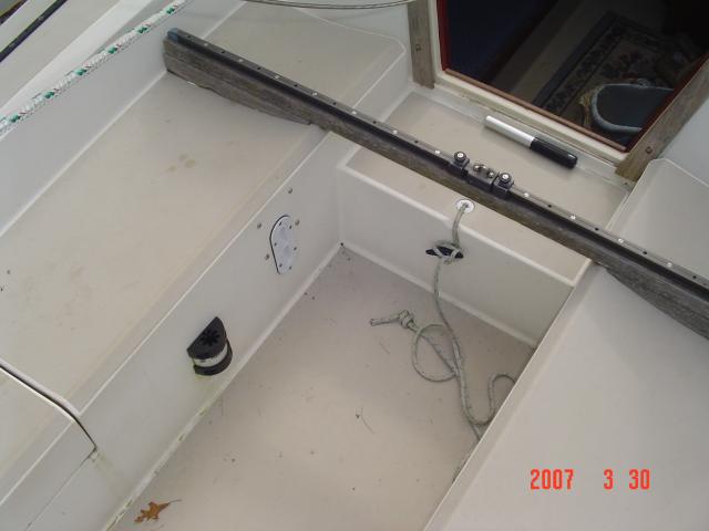

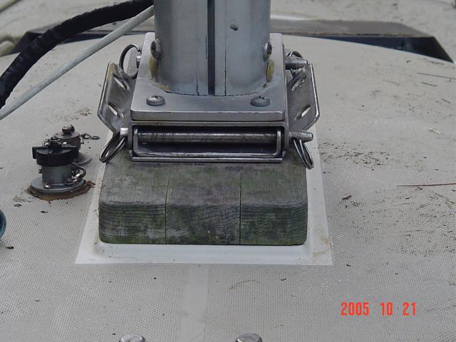

I own an 86 O'Day 222 that I bought new in the Boston Boat Show back then and I have to admit that I don't know what's going on with the slack that you're getting in the back stay on your boat. I remember that a girl in Columbus OH, with an 88 O'Day 222 had the very same problem. She would email me quite a bit and ask questions about her boat, but I haven't heard from her in a while. Anyway, I always hated that main sheet attachment with the triangular plate on the back stay, so what I did was have it removed and I had a used Johnson Handy-Lock installed and had the open turnbuckle moved up a little. That way, I could remove the back stay from my mast. I bought a cheap traveler and installed it in front of the companionway. I have Z-Spar with internal halyards. When I lost my mast in the 90s, I had a stainless steel mast hinge installed with a utility plate. I mounted the mast hinge and plate on a block of Teak on the cabin myself and the rigger did the mast work. He talked me into going to thicker stays which was a big mistake because I think that it caused my "L" bracket on my Starboard chainplate to break. So looking back now, the Handy-Lock was a great idea and so was the traveler, the Tabernacle, and the block under the Tabernacle which made a big difference in mast raising/lowering, but I probably should have stayed with the 1/8" stays. My advice to you is to buy some kind of a stay adjuster similar to what's on the Mac boats, or bite the bullet for a pricey Handy-Lock. Leave the turnbuckle on your back stay for fine tuning, and buy a decent traveler. I wouldn't mount it on the cabin though. I'd rather step over it than have to duck under it myself. If you replace your stays, stick with the 1/8" stays but keep a watchful eye on the "L" brackets mounted on the main bulkhead in the cabin. I use a Loos Gauge for adjusting my stays. Actually, once you adjust your side stays, you never have to touch them again. The Handy-Lock will loosen your fore stay so that it can be taken off when lowering the mast. Check out my photo album on this site under O'Day 222, Trinkka.
