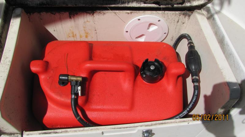

It had a poly tank, but both the fuel level gauge, and the fuel line fitting are leaking. Both fittings are cracked. So yeah, steel rusts, plastic cracks, aluminum corrodes. No free lunch I guess. Between them all I like steel. If you keep fresh fuel in them they dont rust internally. Keep them clean and painted and they wont rust externally. My poly tank looks similar to yours in the pic, but it also has a gauge.

I have three Dura-Tanks. My first one leaked at the gauge so I bought one without a gauge. That's the one pictured.

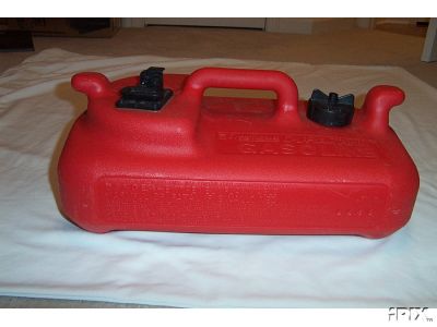

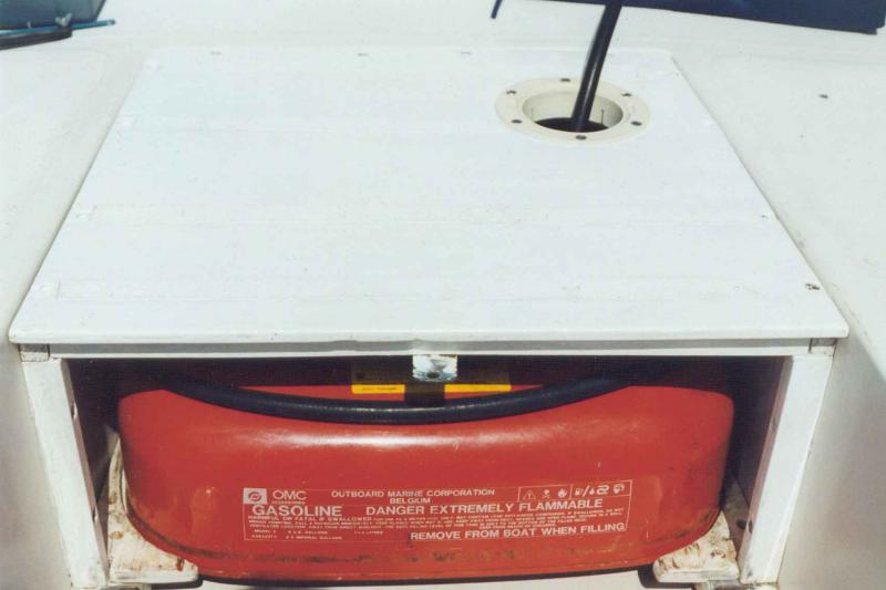

We used to have a metal OMC 3-gallon tank (original to the 1981 and 1989 Johnson outboards we had) They remained rust free or nearly so (well, the 1989 tank did) despite being in the cockpit all summer. However, the tank was under a cover and raised about 2" above the cockpit sole. There may not be room to place some kind of spacer under a 6-gallon metal tank in the 222 fuel locker, but something like the old, plastic deck-clips (for want of a better name?) that OMC used to sell to hold their 3 and 6 gallon tanks in place on a deck would raise the tank just enough to keep moisture from being in constant contact with the botto mseam of the metal tank. I've attached a couple of pic of our homemade gas tank locker (on our old CAL 21) for referance to one reason that I see for our lack of rusting over the 8 seasons of use. The picture shows our 1981 tank I think, slight rust but not bad yet. The plastic tank isn't mine, but is a pic that I think I found on eBay prior to buying my tank at a local Evinrude Dealer.
