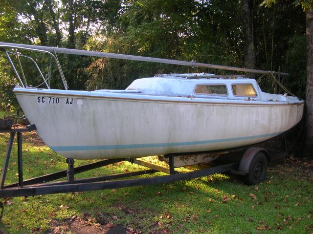

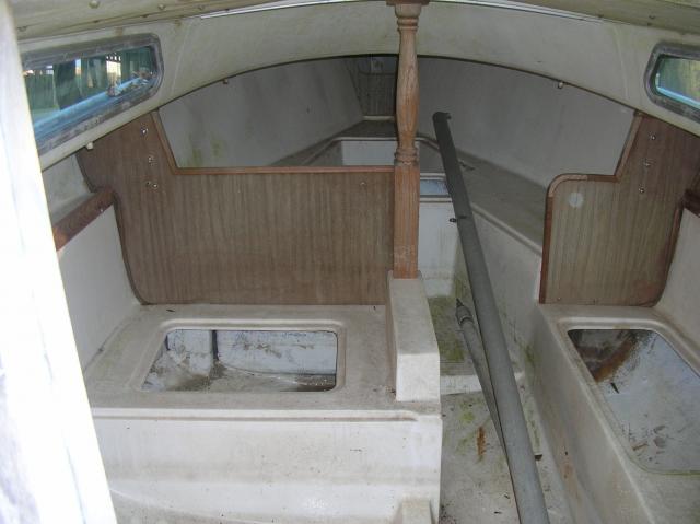

Heres the deal, I know a guy who has a 22' Catalina thats in apparent good condition, but its mast and trailer have been stolen. I came across a 22' Catalina on craigslist with trailer, mast the whole 9 yards minus the sails. Apparently he had 5 others look at it and no one wanted it because theres a part on the deck that is soft, so he told me I could have it for 300$ (talked him down to 250$ :D). I didnt hesitate because I knew I had a decent one floating that I could just throw the mast and trailer at. I went and took a look at the donor Catalina today and was surprised to find that its not near as bad as I thought it was going to be. With the inside being in good condition and the outside paint not to shabby. The only thing I noticed missing were the teak slats that slide in the companion way door, even with this there wasn't any water inside the boat.

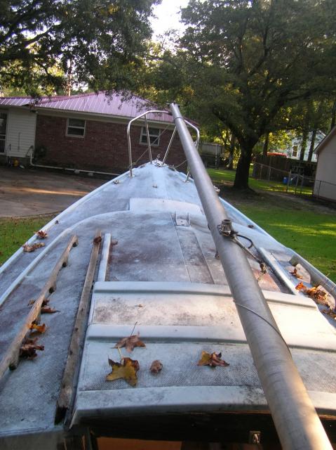

SO my question is, how big of a deal is a soft spot about 9in long by 5in wide near the bow of the boat, and would it be worth fixing? I actually stood on it and felt safe, it just moved down some is all. Ill take some pics when I get it this weekend.

If that's all that's really wrong with it...sure. I'd check all the critical spots, chain plates, keel, mast step, transom, etc...but as presented it sounds like a deal. Nothing structural in the bow that concerns a soft spot, and something that small is very fixable anyway. Send pics.

love the catamaran idea!!!! but seriously, don't worry too much about the soft spot. I bought my boat with a small soft spot at the bow and it hasn't gotten worse in 4 years; and would be relatively easy to fix if I felt like. I walk on that area all the time and never notice it unless I bounce a lot on the area. $250.....what a deal!!!

Where is this C22? While I'm not interested there others that might be. What is the sail #?
It is the coveted none pop-top that C22 racers are looking for. It does however have the front hatch but it's more than likely an added item for this year model.
The foredeck while seemingly intimidating can be repaired from the inside.
It also doesn't appear to ever have had anything done to the bottom, another good thing.
