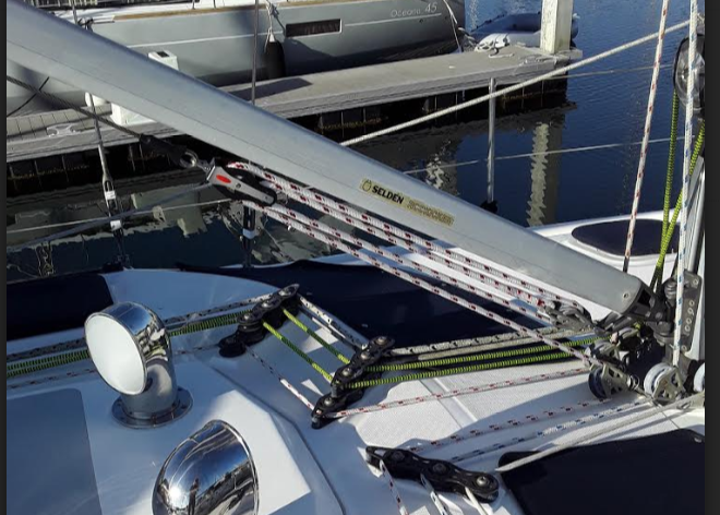

...................One more question - does anyone have a note of the correct way to rig the boom vang tackle?...............
Like this.........you can also do an internet search for rigging your specific vang.

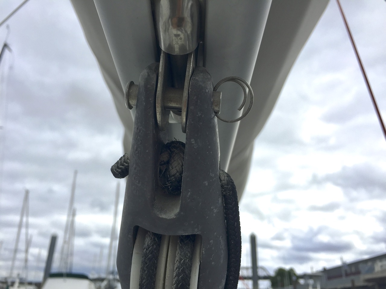

Here are a couple of photos of how my vang is set up;
End of line at the top of the vang, below the boom.
Then run down the outside of the vang and through the sheeves
Exiting from the base of the vang, through a deck organizer (next to the mainsheet), and back to a line clutch in the cockpit.

Great info, thanks very much. I can see now that I have my vang set up incorrectly which would explain why I cannot compress it more than a few cm.
