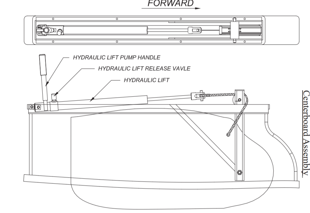

A it is, I can't myself even get to the stirrup fixture / bolt going into the centerboard that the cable attaches to in order to free it. Its too far down inside the surrounding hull structure to even see what the screw head is or get a socket in there. I may not, obviously, be the most mechanic person, but I can't see how you would even be able to replace this cable unless the centerboard was fully down. Could be wrong there so if anybody knows better, help!
So, to conclude, my repair plan was to buy a new cable, gently trailer the boat with its centerboard resting on a ratchet strap to the marina fortunately just across the street, call it their problem and hopefully write not too large of a check!
I can probably get close on the length just by putting the two pieces of the shredded cable end to end, but I'm not sure how precise this length needs to be or if an inch or two error one way or another really matters. I do have an email into Marlow Hunter technical support so we'll see if they respond as well.
And yes the centerboard / cable design looks like the diagram you posted. The small variation being that the cable does not go threw an eye hole on the centerboard itself as the diagram might imply, but goes through a stirrup fixture that attaches to the edge of board.
