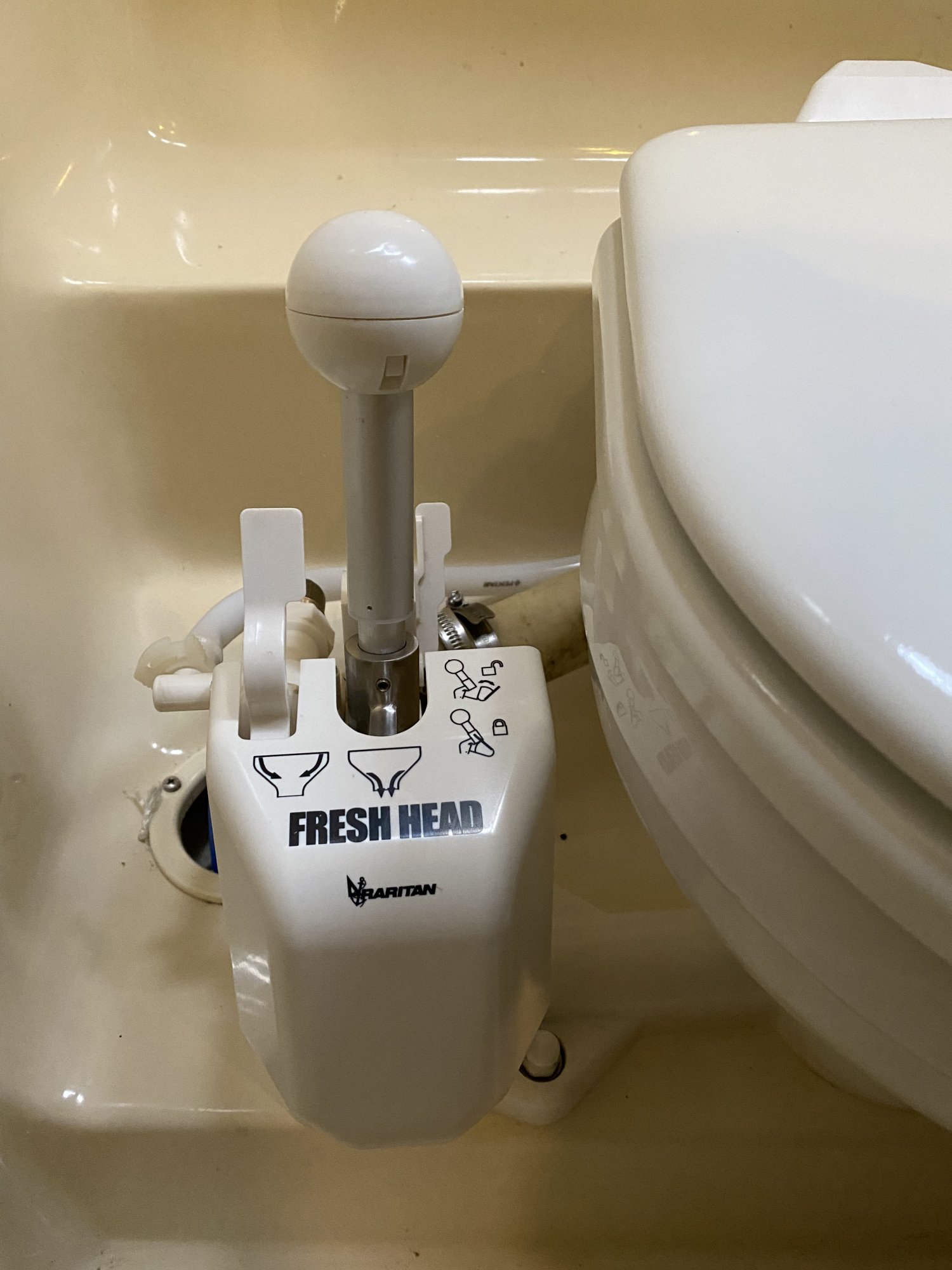

Jabsco needed rebuilding again, so decided to replace entire head with a Raritan Fresh compact marine head. We never cruise enough for freshwater use to be a problem, and getting rid of seawater smell is a bonus. Plus - Raritan vs Jabsco.
Peggy recommended this head, and the bolt footprint is identical to the Jabsco, so that also made it easy. It also requires no power, using a manual pump and pressure water.

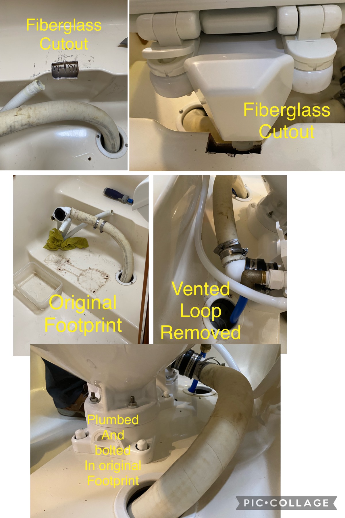

As the pics show the H36 head space is tight - only a compact bowl will fit, mostly due to how far back the bowl fittings go and that the bolt holes are already pretty far forward on the platform. So I chose to cut out a little of the shelf to accommodate rather than try to fill and redrill bolt holes. The cover hides the shelf cutout.

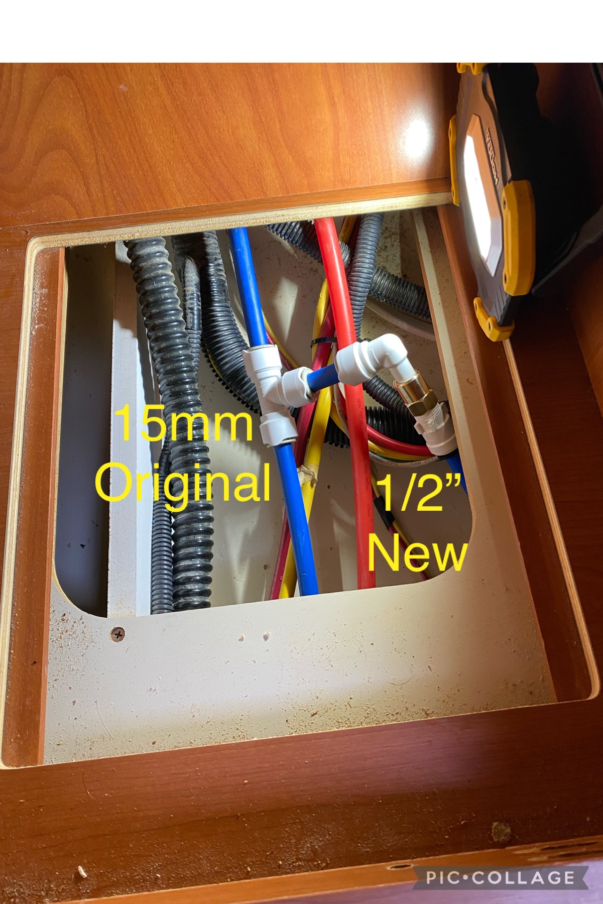

because you’re using your freshwater tank you can do away with the vented loop. The next issue was the boat is plumbed with 15mm pex and the toilet connection is 1/2”. That took some googling but I found a Whale 15mm push fitting to 1/2”NPT threaded fitting, so the conversion went easily (see photo).The simplest would’ve been a push fitting 15mm Tee to 1/2” output push fitting but couldn’t find such an animal, so that’s why the three fittings for the conversion.
Peggy recommends replacing the sewage line to the holding tank while you’re at it. I did that two years ago with the high quality line she recommends. No need to to it again so soon. I closed and removed the handle from the seacock and will cap it with a bronze cap.
Using this head is easier, and I’m sure the odor factor will be lower. Wanted other folks to see how it fit and what modifications/conversions were required. Not a drop in, but easy enough for a moderately skilled DIY job.
