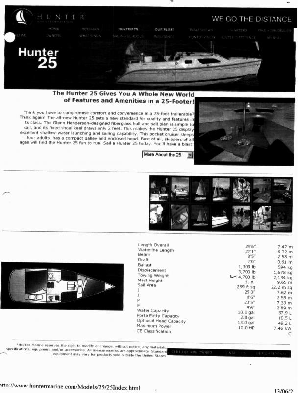

My 2008 H25 came with a brochure from Hunter Marine that indicates a CE Classification of “C”. The specifications currently listed on the Marlow-Hunter site show this model as Class “D”. Would anyone know if the classification of this boat was originally “C” then changed to “D” or vice versa? The description of each classification is as follows:
Category C – Inshore Voyages on coastal waters, large lakes, bays estuaries, or rivers, where wind force of up to force 6 on the Beaufort scale and significant wave heights of up to 2 meters may be experienced.
Category D – Sheltered waters. Designed for voyages on sheltered inland waterways, including lakes, rivers and canals, where wind force 4 and significant wave height of 0.5 meters may be experienced.
Thanks
Andre

I thought it was a class C to satisfy the european market criteria. Not sure why it is showing a D rating. However, class D would be more appropiate.

My understanding is that a manufacture tests for a particular level, and if it passes they claim that. Marlowe may have wanted to back down from the C level for any number of reasons. They may have also changed the boat in some way that warranted that, but I doubt it.
It can also happen the other way. The first year my Beneteau First 260 was available, it was tested at C and passed, so Class C. The next year they tested it at B and it passed there, so from then on (till now) it is a Class B boat.
