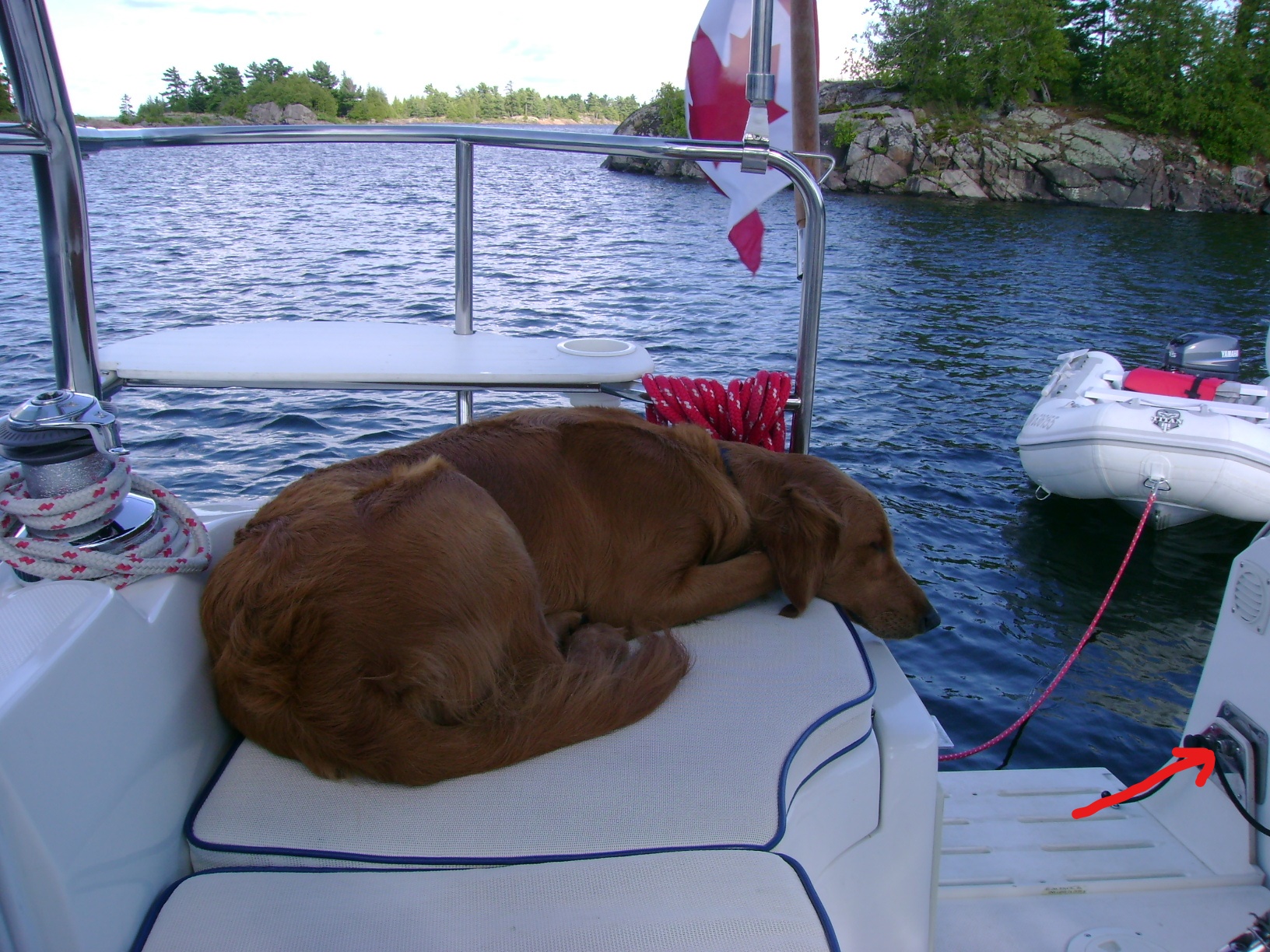

Just went to tell the third response, "Nice" and then noticed it was from you Scott B. I also just noticed the Red Arrow. Thank you again for your help and also, "Nice"!!!

I would check the 2 hinge pins that they are tight. The 3rd pin is only to lock the seat in place so it doesn't swing, but yes definately check all three are tight. Can't exactly remember how the seat was with the bent pin, it was 15 yrs ago, just remeber it ddid not swing properly.
When you say wobble, is that side to side or does it swing fore and aft when you step on it.

If its swinging fore and aft, the third pin is not engaged. The third pin with the knob & spring should lock into a hole when the seat is down and up. You should have to pull the knob to release the seat. Check that knob and that will stop the swinging.
