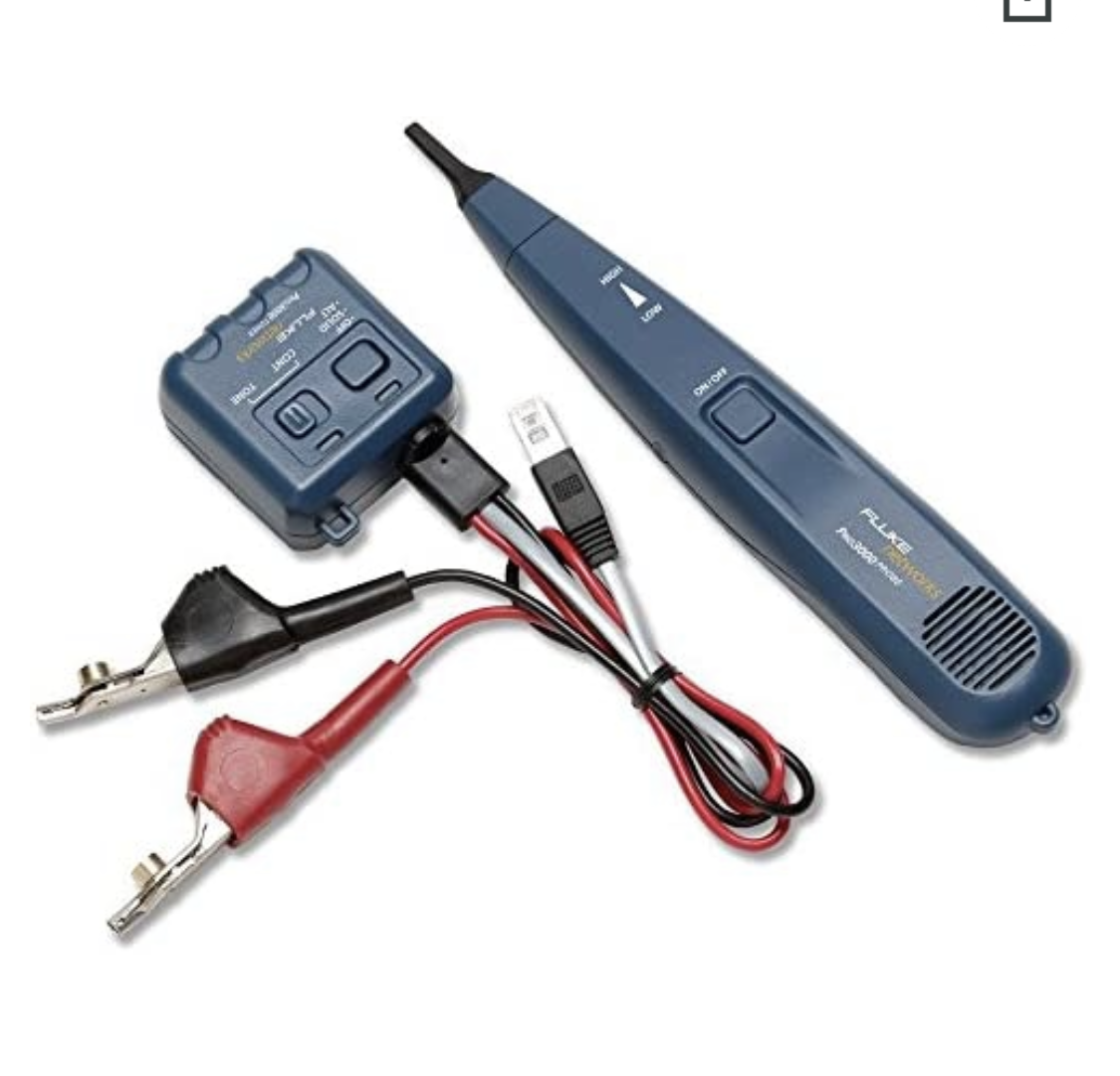

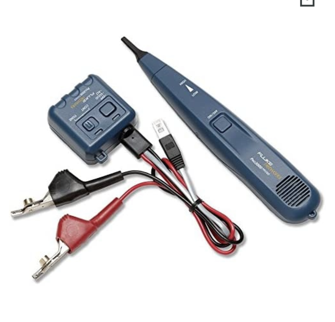

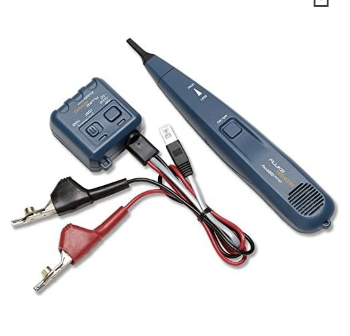

The phone industry has used tone generator’s to trace unidentified lines for eons. Put it on a yellow line and see where it leads. The tone receiver can be a no contact or a contact design. Use yellow because it is more likely to be connected to ground and the red wire just maybe attached to the battery.
It is a tedious but sure way to locate wires that you cannot visually trace.
This one is a Fluke. Found on Amazon

Thanks John and yeah, I figured lol. Thought I'd try though. These are original wires, installed neatly in conduit and properly capped off.
I have one of those things, sometimes works, sometimes doesn't. I tend to have better luck just wiggling things :)
