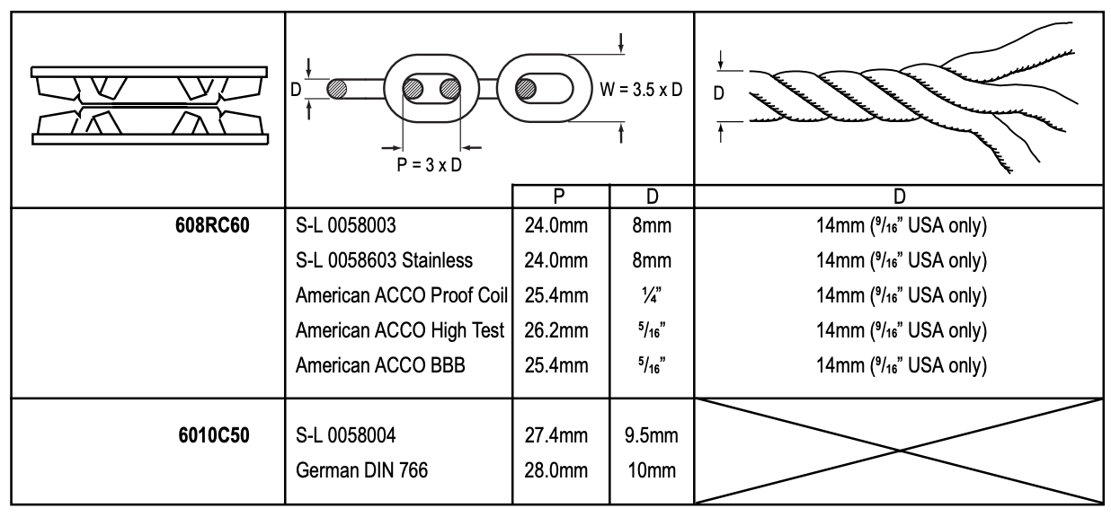

Congratulations on the new boat! I just bought a 2006 H38 in December. Moved up from a Catalina 30. Love it. It's a great boat for creature comforts and sails very well.
Below is the page from the S-L manual for chain and rope rode dimensions. It assumes you have the Hunter-installed windlass and the standard gypsy.
As others have said, if it were me I'd want to see and touch the existing chain to make sure I got the right stuff.

On the boat now and just checked the windlass and chain. The gypsy has 7 pockets, there's 100' (really two 50' sections with some really manky looking link to join then) of 5/15" BBB and a few feet of 1/2" 3-strand nylon.
It looks like G43 will also fit this gypsy, so I'm going to get a foot and double check. I may go to G43 and 9/16" 3-strand nylon.

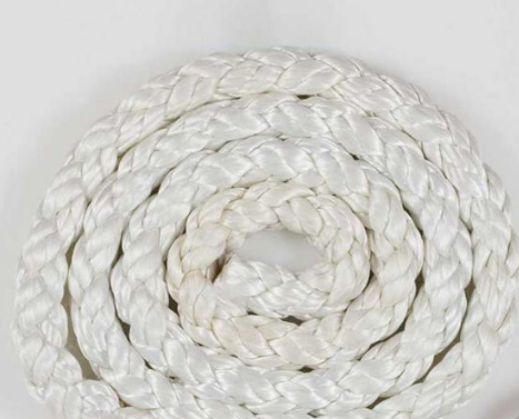

Good plan to purchase a foot of chain to verify the chain diameter that will be compatible with your windlass. That is exact;y what I did BEFORE I replaced my anchor chain. You probably know that Grade 43 (G4) hot-galvanized, high-tensile anchor chain is the industry standard and is a good choice. That is what I installed, in my case 5/16". I also replaced the rope with New England 8-Plait nylon rope, in my case 5/8".

FlightLead404, the 8-Plait will be easier to handle and lie more flatly in your anchor locker. 3 strand tends to hockle and twist out of shape leading to frustration and angry words. It is a sturdy line for anchoring.

I'm still confused by the chain specs. Perhaps I've been doing too much research. I thought the RC172 gypsy specs said 5/16" G43 would work, but other places I read say that a different size G43 would be compatible with the 5/16" BBB that is on there now.

ok picked up a couple feet of 5/16" G43 and ran it back and forth in the windlass a few times, tied a bungee to it so it was loaded up a bit, works great so that's what I'll buy.
