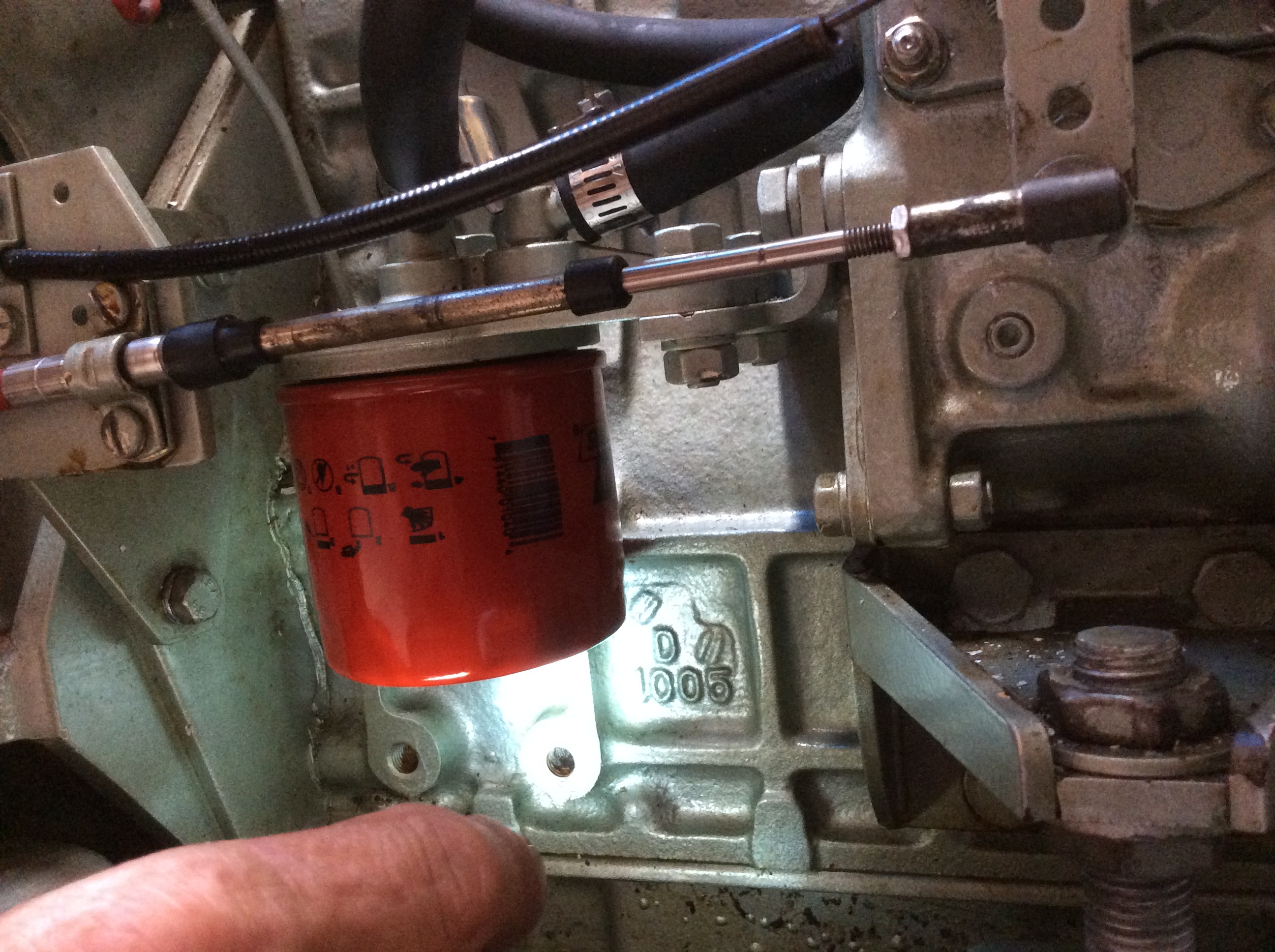

Here is pic of filter I am presently using. It's from a reliable source that I found locally. As you can see there is tight quarters where there is a flange on block and the Kubota filter won't fit in here. Not enough room. I'll take my tape measure when I go looking for the next filter. I have 3 1/4 in.

That doesn't seem like something universal would modify to turn a Kubota into a universal marine motor. See if you can find a photo of the Kubota motor or visit a tractor dealer to see if you can look at one. Maybe the bracket is bent a little or maybe you can shim the bracket to get a little more clearance.

Looking at the parts list your bracket uses a spacer under one side of it and two different size and length screws to mount the bracket. See if the spacer is there, that might give you the clearance you need. Keep in mind this unit does not interact mechanically with the engine, it just uses the engine as a means to hold it. You could just as easily mount this off the engine by screwing the mounting bracket to the side wall of your engine compartment. http://www.westerbeke.com/parts manual/201021 parts manual m25xpb-m35b-m40b revision 2 final.pdf
