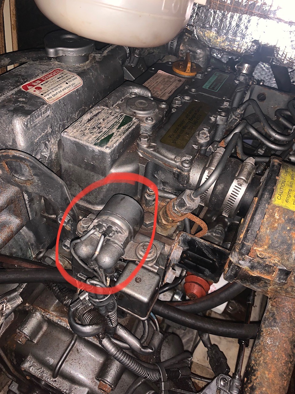

Thanks alot. It's hard to tell, given the previous owner spraypainted everything grey, but this is the starter solenoid, correct? You can see the small white wire coming down out of the rubber covering near the bottom of the pic. Thanks.
The PO was covering the rust and sprayed it Yanmar Gray.
Typically the solenoid is near the starter or attached to the starter, but I'm not familiar with the 3YM30.
The white wire goes from the postive connection on the starter to the key and then back to the solenoid. It is this long run that cause the problem. When I replaced mine, I removed the wire from the starter to the ket and powered the circuit from the battery, this cut the wire run in half.

On my '08 h36 3YM30 the power at the key gets sent to that relay in your photo. Engaging that relay sends power to the solenoid on the starter. The control wire from the start switch to the relay in the photo is smaller gage than the wire used to/from the relay contacts to the starter solenoid. There are 4 connections on that relay. Two are barrel connectors for the key switch (coil power and ground) and two are ring terminals for the heavier wires that send power to the starter solenoid. Check/clean all connections. One of the ring terminals picks up power from the starter cable on the starter solenoid and the other ring terminal is a white wire that connects to the end of the starter solenoid via a 1/4" spade connector. Clean that connection - but you may need to remove the alternator to do so . mine had lots of rust on it due to a raw water pump shaft leak that was untreated by the PO. I put a double connector there to send the start signal to my BSS ACR so it separates the house and start batteries so starting current is not drawn from the house battery through the acr while cranking. Amazing that it's not a screw terminal for the white wire on the solenoid.
Reference the starting relay in figure 9 of the manual. This is a great figure to understand and will give you more confidence to troubleshoot engine electrical problems. You can see one side of the starting relay goes to the solenoid on top of the starter. People have added this starting relay in the past (not to be confused with the starter solenoid). It appears your engine has the starter relay. cleaning the connections on the key switch is useful as well. In this case, the starter switch contacts may not be rated to carry the starter solenoid current if you wire directly from the key switch to the solenoid. Finally, check the two harness extension connections near the rear of the starter motor area that come from the instrument panel. One connector has 3 larger wires and the other has about 8 smaller gauge wires. Clean and remate. Cutting those two connectors off and replacing them with individual waterproof butt splices is on my to do list, assuming there is sufficient slack to do it.
