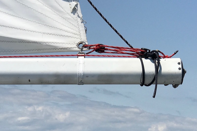

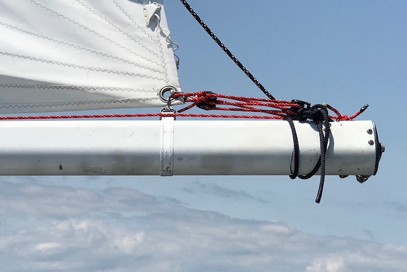

I tried building my own internal system and it never worked. I ended up going with an ugly but usable external outhaul with the line cleated at mid boom. If I could figure out a better attachment point at the boom end it would work well.
