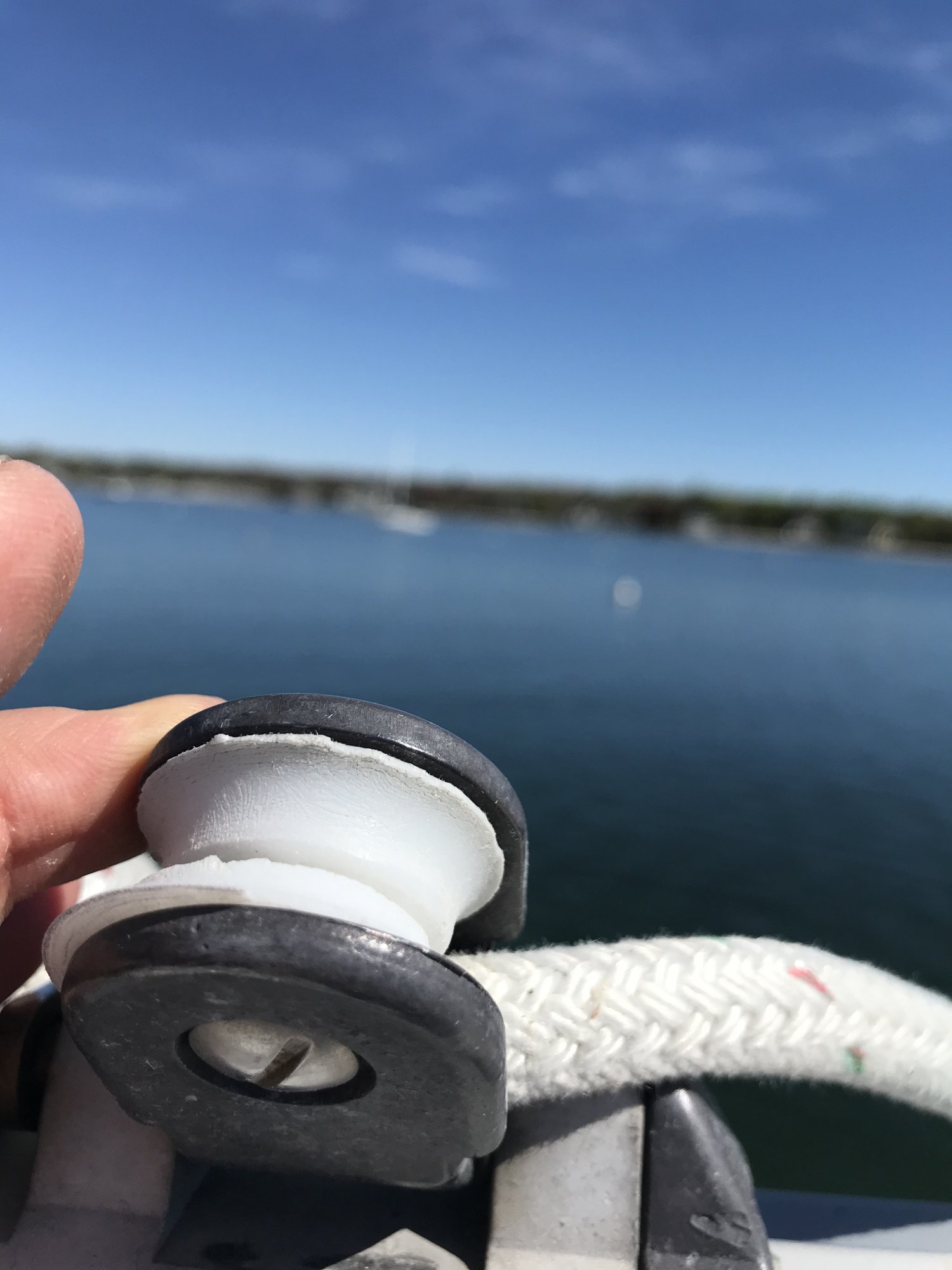

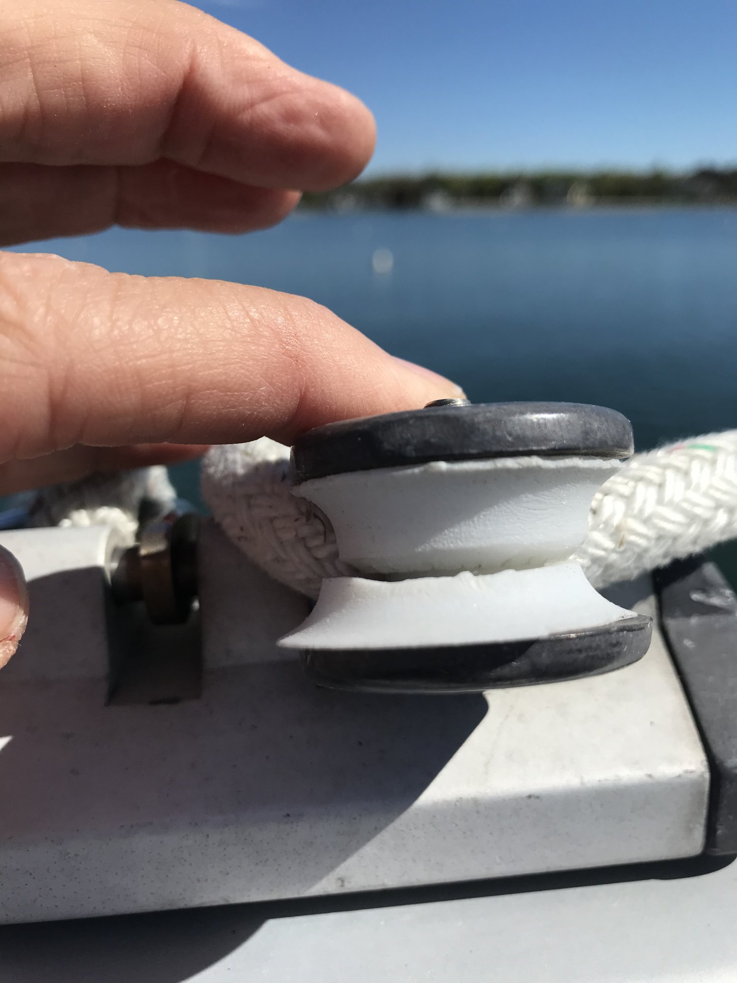

You should be able to take the block apart and replace the sheave. If you cannot find one of the correct diameter at a marine supplier, try McMaster Carr... You may find what you need in their online catalog.

Looking to replace a piece of the traveler car for a 2000 Beneteau Oceanis 461. If anyone happens to know the make and or part number I would be grateful! It’s just literally the plastic spool the needs to be replaced but will replace the entire piece if need be. Thank you!
The P/N is 1617 35 mm dia X 16mm wide x 8 mm hole $ 5. 60 I believe, from US spars and is the supplier for Z spar masts . You have access to all parts catalogs
