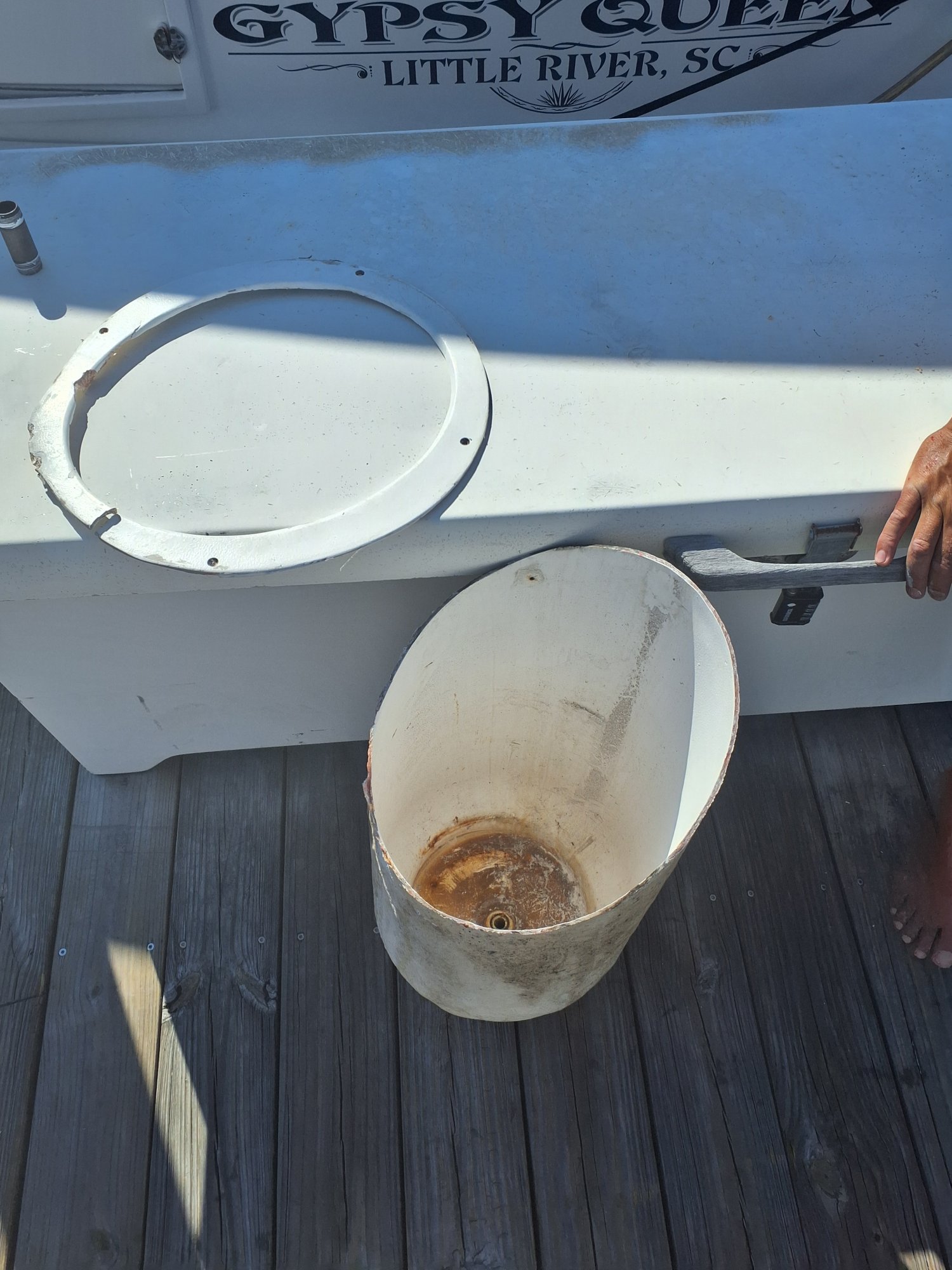

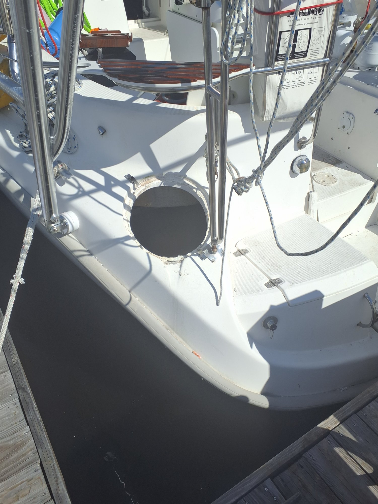

Hello Sailors. I am looking for a port side aft propane locker tube. I had to cut mine out to get access and the repair cost is astronomical. looking for a serviceable unit. or new if that is the way we have to go. any feedback or leads of who to call is very much appreciated.

I'm trying to understand the two pictures you posted. Is the first picture the hole where the parts shown in the second picture came out of?

I'm no fiberglass expert, but I'd use the existing one as a mold, as suggested above. $1600 is enough motivation that it would be worth it to me. No way it would cost as much as $100.
Do a couple of layers inside the existing tank. Pop it out, and add more layers to the outside. The flange is certainly a complication, but I'd still try to do it myself.
