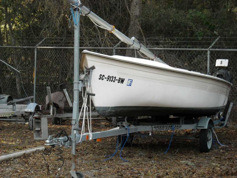

So, the guy seems to be sincere, but I have read enough horror stories on the ACP cracks that I am leaning towards backing out of the deal. I am going to post a couple of pics of an American Sail 18 that is for sale in Myrtle Beach that I am interested in. If anyone has any comments/suggestions about it they would be appreciated. American Sail is a small company out of Charleston SC and the seem to have a pretty good reputation around here. I am thinking it won't have the performance of the Hunter 170, but I'm in my 50's and don't want to be turtleing boats.

You are correct on performance but again if you know any boat very well, it can be competitive as with the American 18. You will find that they build solid well built boats and stand behind their product. Dave Stanton who sells the boats while his son builds them is highly recognized and they are some of the few I trust even with my life. Go for it. Alot will depend on how the current owner of that American 18 took care of it.
Precsion is antoher good company as well.

Thanks for the information. I am actually in Knightdale just up the road from you... I think I will take a shot on the American 18, the guy has added roller furling equipment and several other add ons. I did notice that he painted the bottom of the boat and I did not think that was necessary with fiberglass. Is that a saltwater thing?

If the boat was moored in the water, bottom paint was necessary but if trailered only, I am surprised. Anyway, you do not need to apply paint if trailering the boat. I am in the phone book
