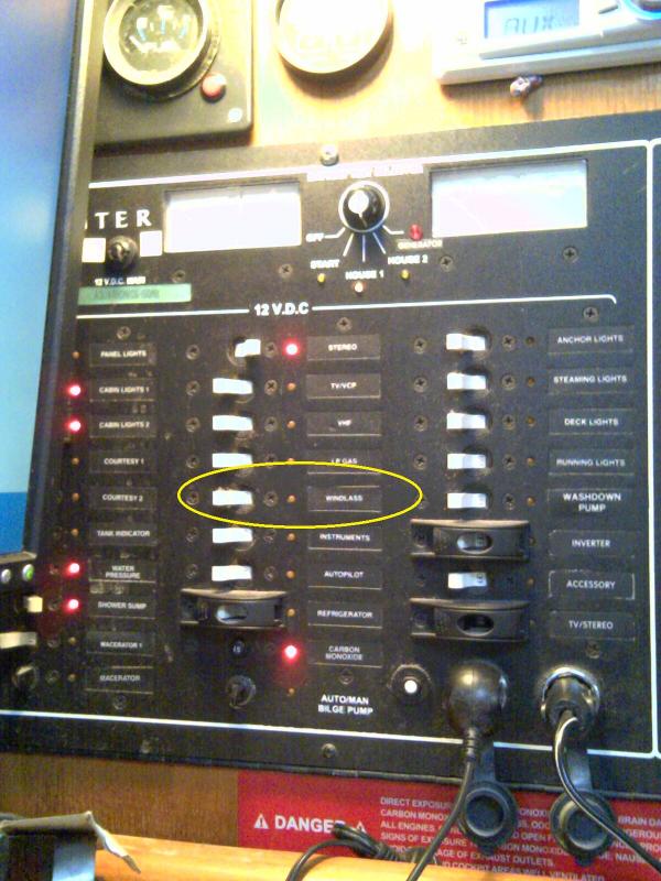

I have 2 questions about the windlass on my 2007 H36.
The "manual" from Simpson Lawrence is a joke - the most useless piece of documentation I have seen in a long time.
1 - there are 2 holes in the top of the windlass. The center hole is for the clutch and seems to work as I would expect - use a winch handle and you can either let the winch run free, or lock it down. What is the purpose of the second Offset hole ? It fits a standard winch handle and I thought it was for manual retrieval - but no matter what I do to the clutch, I can't budge the winch with a handle in this second offset hole. The manual totally ignores this - so - do you guys know what the second offset hole is for ?and if it is for manual retrieval, how in the heck do you use it ????? The manual is clueless on this.
2 - despite having fully charged batteries, connected to shore power and a charger,unless the engine is running, when I push the UP or DOWN buttons for the windlass, all I get is a CLICK but no movement from the windlass. If the engine is running - no problem - but no engine = no power windlass. Is this normal or Is there an electrical problem ? Again - the manual is totally useless on this topic - so I hope you guys can shed some light on this.
Thanks,
Paul

Paul:
I would guess that there is some type of a relay that prevents one from engaging the windlass unless there is a charge going to the battery.

Check the dedicated high amp breaker switch
Looks like I have some detective work to do. There are 2 battery banks - 1 starting battery under the aft bunk, and a bank of 4 Trojan T105's in the port lazarette. I would think that the 4 Trojans would run the windlass no problem - so there must be some odd wiring arrangement preventing the windlass from running without the engine.
But.....the fact that I can hear the solenoid click when I push the up or down buttons would seem to indicate a lack of current. Need to do more snooping on the new boat I guess.
Nick - so the offset hole is only to remove the drum, and not actually useful for manual retrrieval ?? I always like a manual backup - but in this case it sounds like the manual backup is......my back.
// Paul
Sorry did not think about this the first time I posted.... Check the dedicated high amp breaker switch..... I have two breakers one on the nav-electrical panel then another down under the nav-desk next to the 1/2/both/off battery selector switch.

Actually, I am researching the same issue on my 450. However, on my panel, the windlass breaker is a 5 amp which clearly only provides power to the relay (click click). A mechanic friend told me that he expects that the relay closes which in turn provides the 2/0 cable power to the windlass. Makes sense to me since the windlass draws 78 amp on my boat which is clearly not handled by the 5 amp breaker.

Ours runs fine without the engine running. I would guess there could be a bad electrical connection between the battery bank and battery selector switch. If you connect a voltmeter between the battery + terminal and windlass breaker you will see how big the voltage drop is when the windlass is activated. Obviously if that turns out fine then the test needs to be done on the -ve side.
Does the alternator output go to the battery selector switch or direct to the house bank ? If it goes to the selector switch then a voltage drop from the battery bank would allow it to run off the alternator but not off the battery bank.

The bad connection was between my eyes and brain.
The breaker under the NAV table tripped. I had just pushed the red button in and thought it was ok. I didn't see the small black lever that also needed to be flicked.
Now it works fine - even on the hard with no engine running.

I had a feeling that's what it was going to be ! :eek: Ask me how I know.:D
