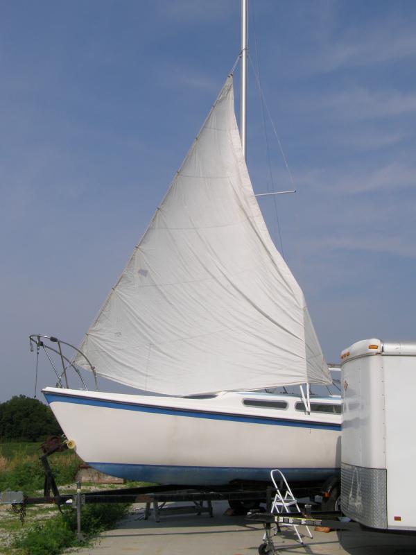

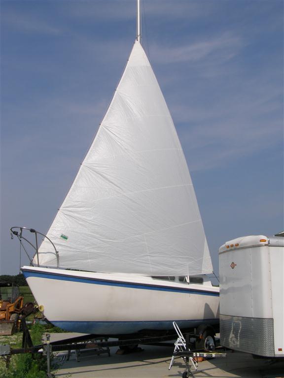

Here are a couple of the geneoa's that I have. I'd like to have the smaller one on the furller, and be able to carry the big one.
