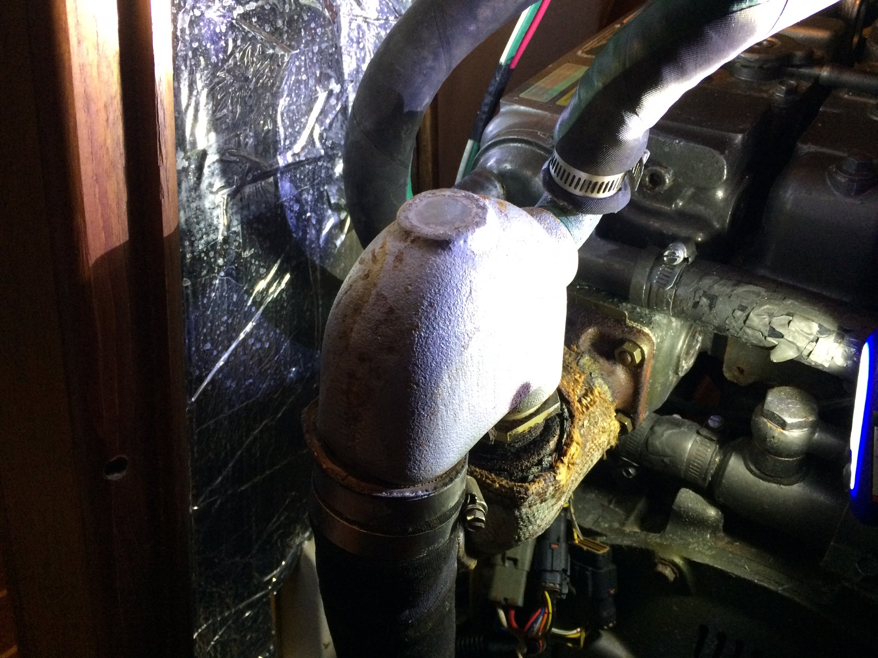

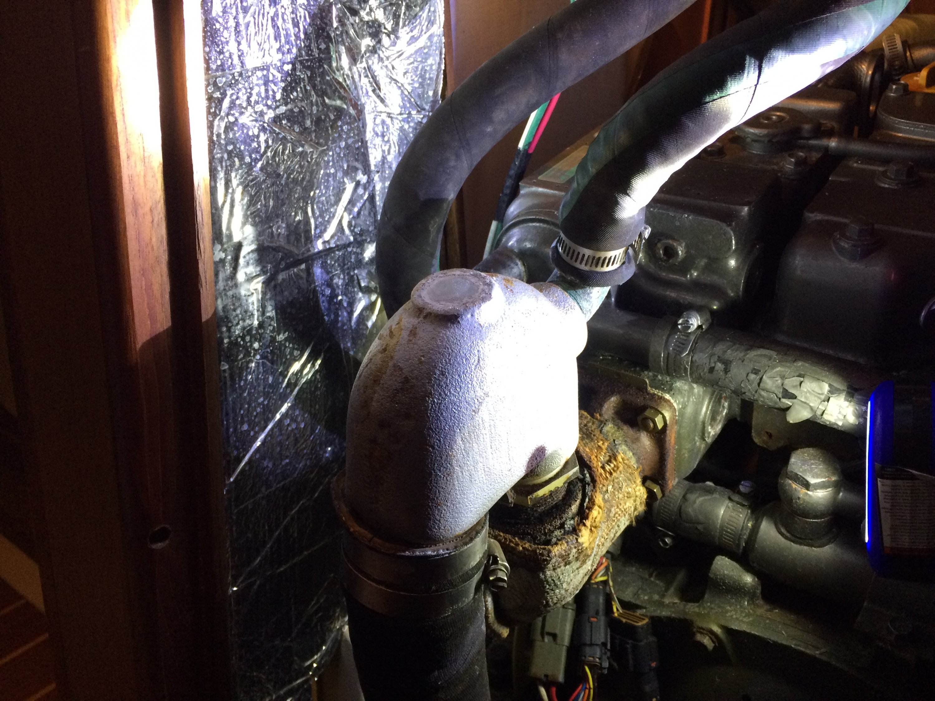

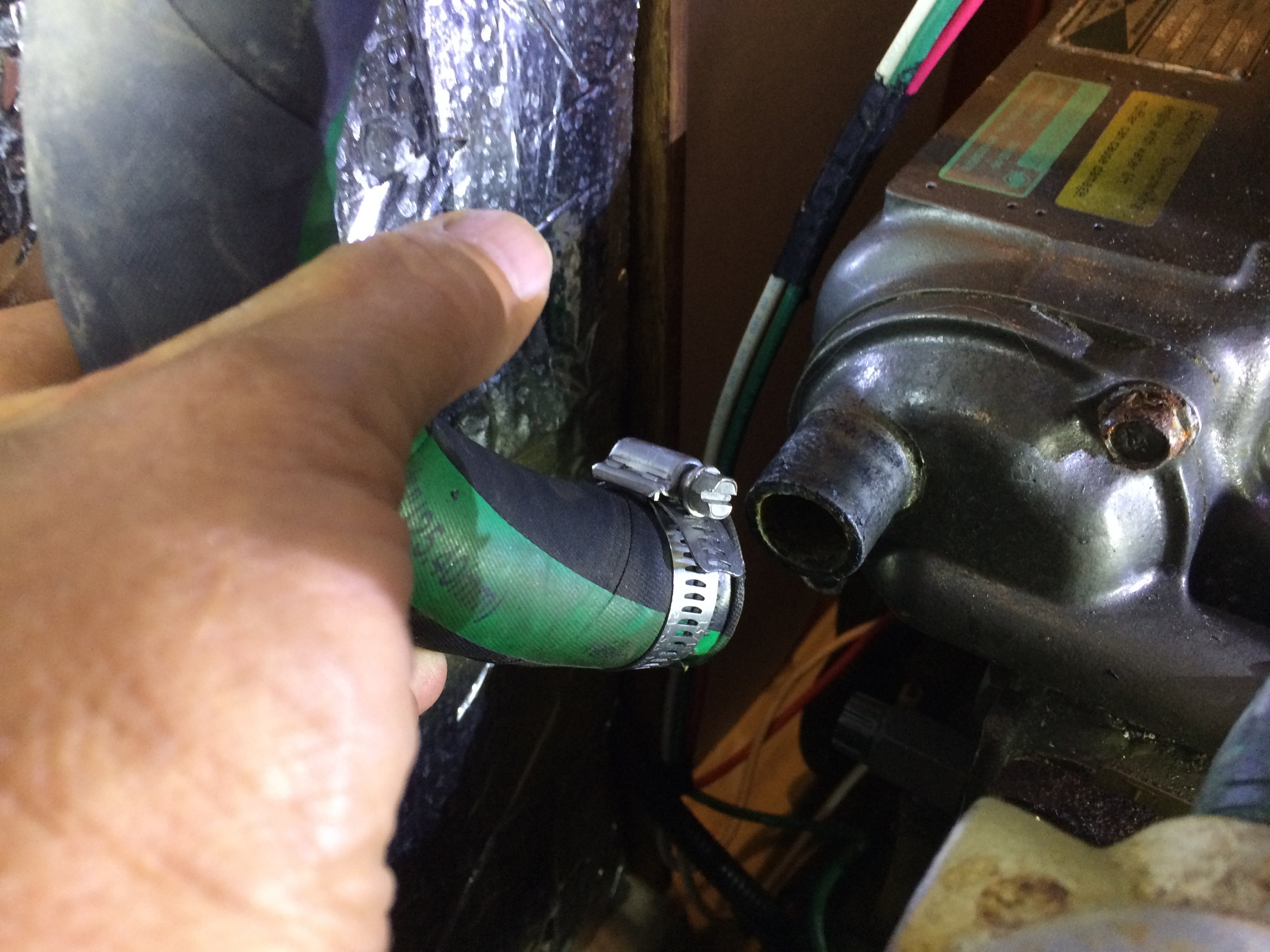

Appears I may have another problem. Or Maybe it's part of the same problem. My raw water hose outlet keeps popping off my heat exchanger. This is also happened when I was out in the water 2 weeks ago. I replaced with new Stainless Steel hose clamps. But it keeps popping off.
I'm wondering if the exhaust mixing elbow is clogged. I heard you have to clean them. Even though I'm a newbie. It appears the raw water exhaust is spitting out the back of the boat on higher rpm's.
Can this be back pressure from a clogged mixing elbow causing hose to pop off the heat exchanger outlet. And how do I test for clogged mixing elbow? Appears the elbow is threaded on a rusty 1 1/2"- 2" nipple before it connects to the flex exhaust pipe. LOL.

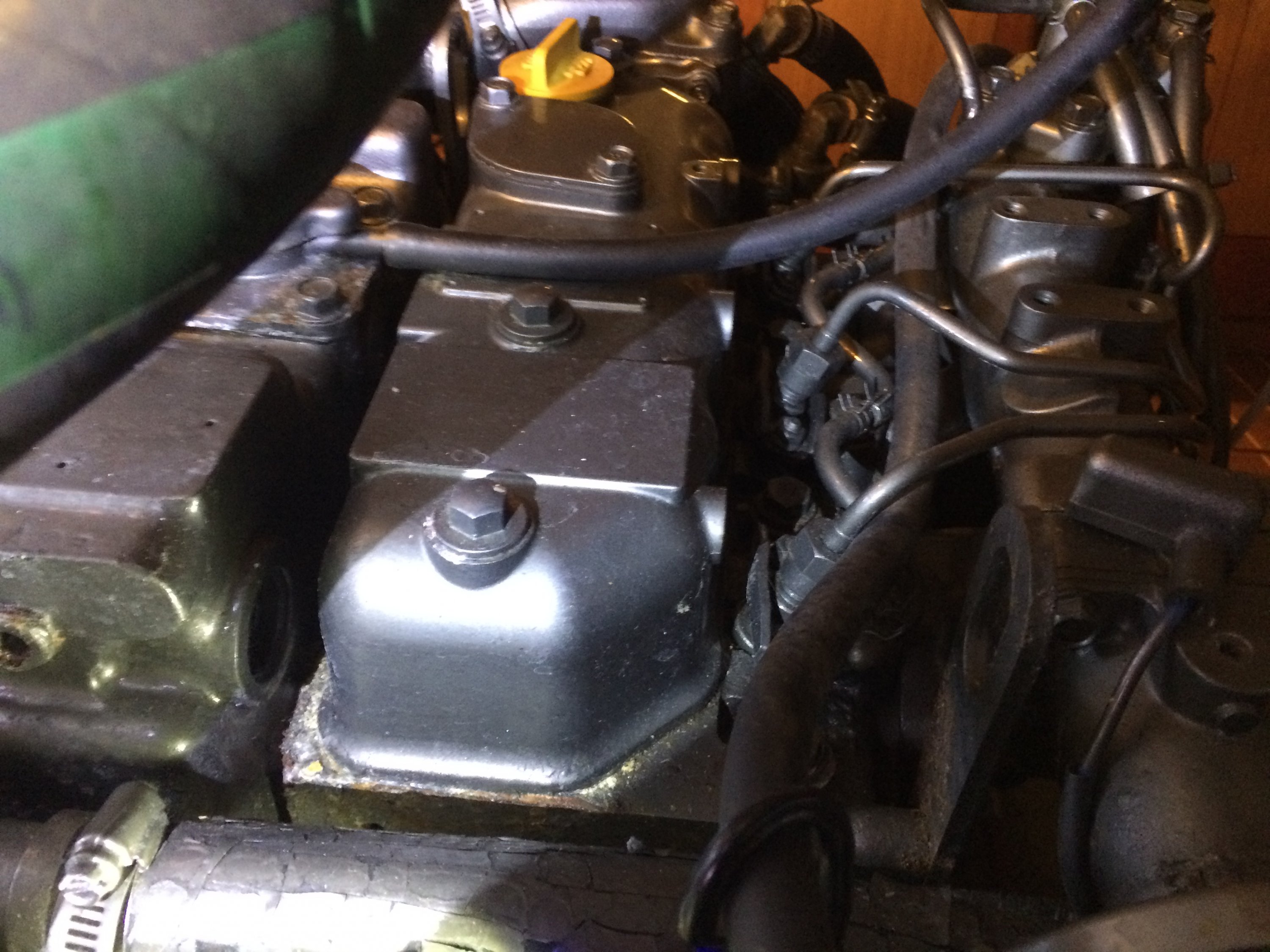

Attached is pictures of my heat exchanger hose, mixing elbow, and my 1998 371 hour Yanmar 3JH2E engine.

For less than $250 change your exhaust elbow. I do this with every sail boat I've bought. The exhaust bluish white can often be water vapour... your elbow and heat exchanger needs a bit of looking after. My mecanic takes the heat exchangeur and cleans it with electrons in a special liquid bath. A new joint and a few hours of labour... it's well worth it especially if you don't use the boat that often :)

Hmmm.... I will check out the thermostat. I do have idiot lights for Temperature. The only time the idiot and alarm went off was when heat exchanger outlet hose keeps popping off. Which I believe is do to back pressure from clogged exhaust mixer elbow. I will find out as I begin removing elbow. Where is that Thermostat on a Yanmar 3JH2E anyways. I guess I will trace that down too.

I have taken off my mixer elbow, exhaust manifold. Looks like elbow is definitely clogged. Looks like I'm getting my parts from https://hdimarine.net/ out of Washington state. A fellow sailboat owner member told me about this site. Thanks Charles. :)
