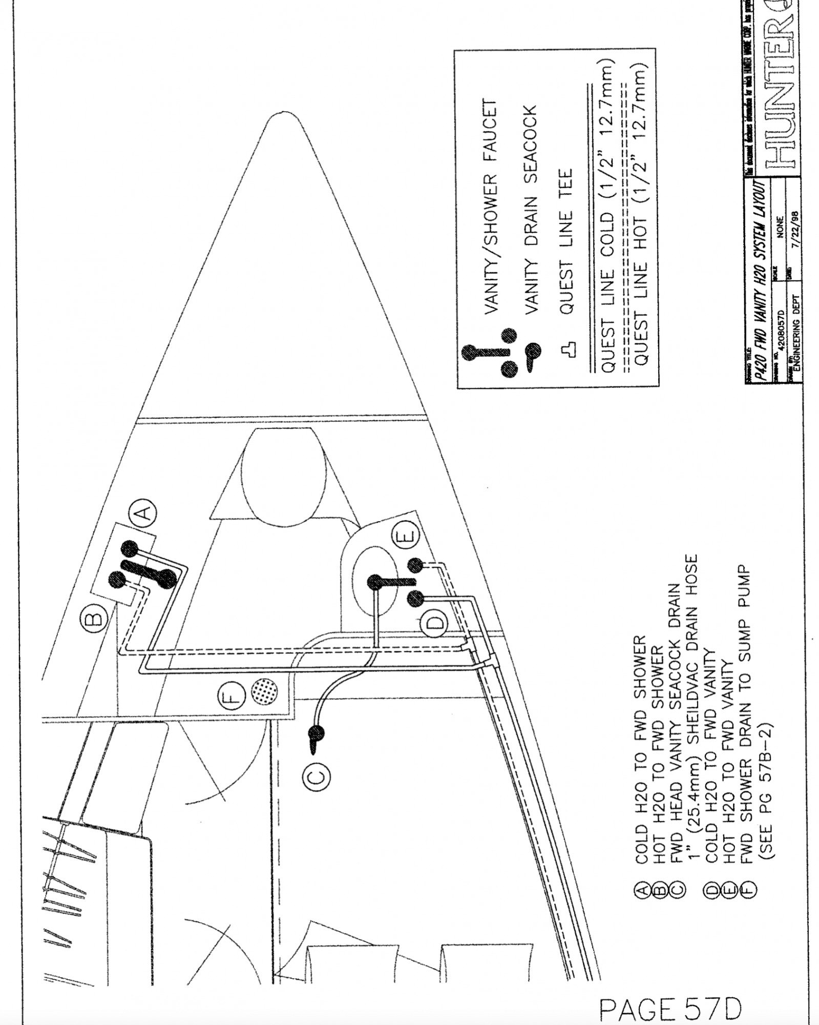

Is this the layout of your H420 front Head?
Jim...
