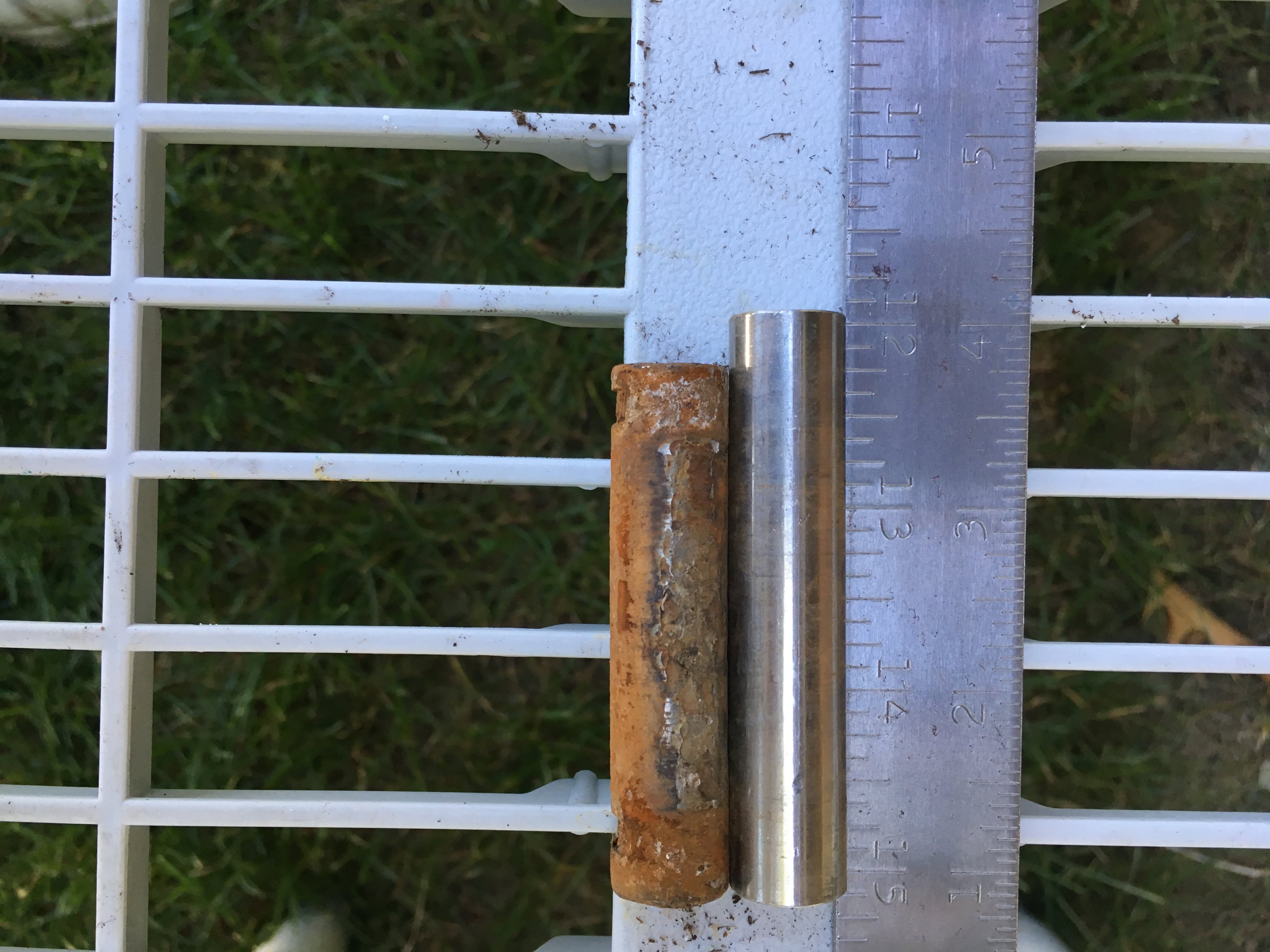

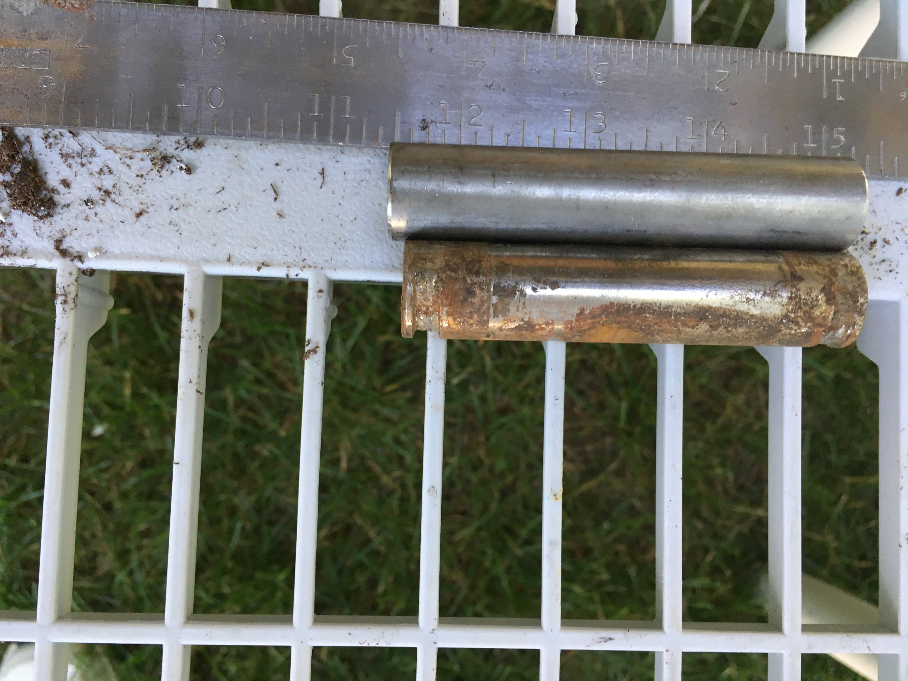

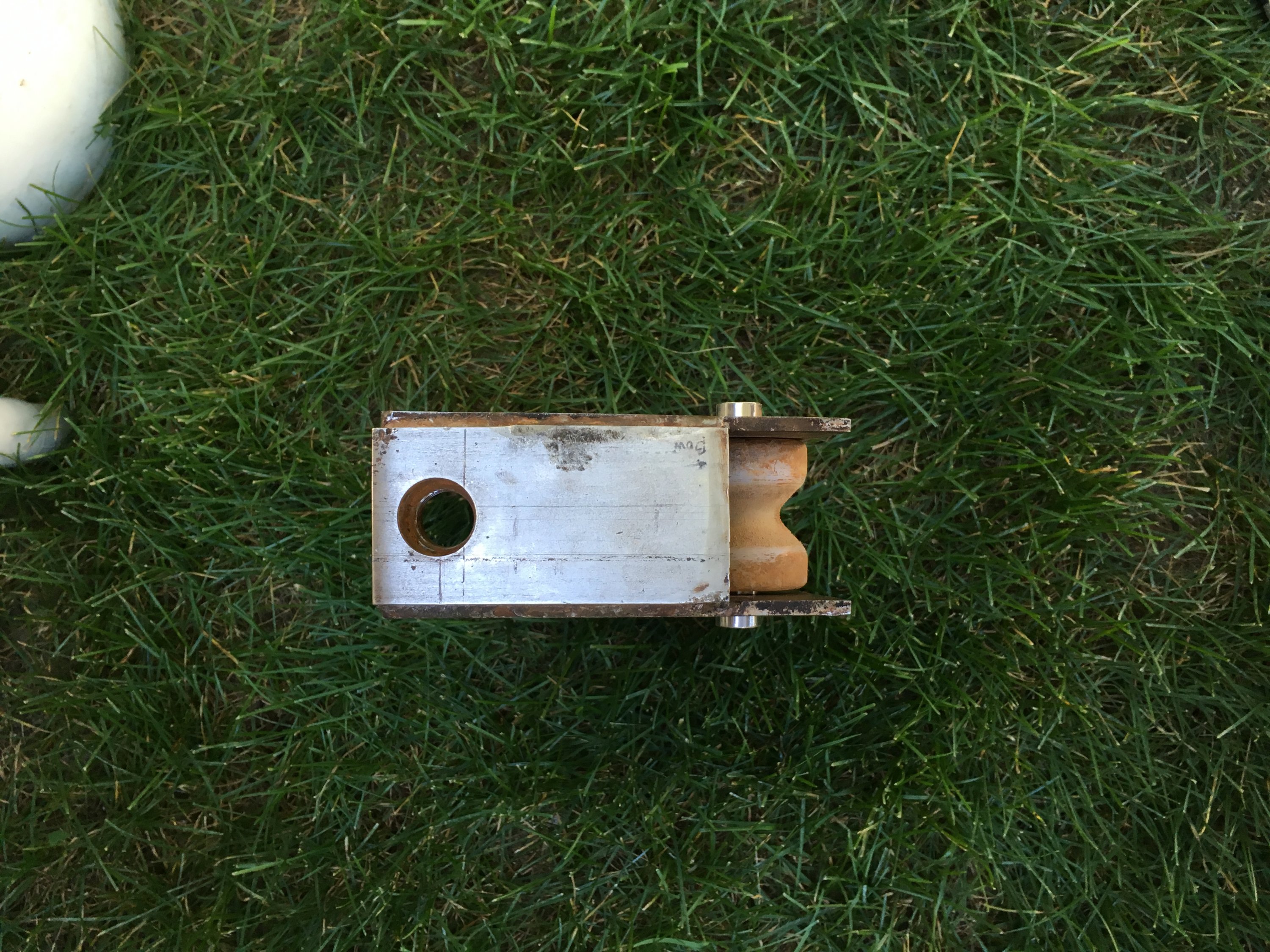

I've received new centerboard and roller pins from the Hunter Forum store for reassembling the centerboard after having elongated holes in the centerboard bracket corrected. Please see images, attached.
The new pins are a little longer that the old ones, the roller pin is about 1/8 inch longer, and the centerboard is 1/4 inch longer. I believe the bracket has a pretty snug fit in the trunk.
My question is: is the width of the centerboard trunk sufficient to accommodate the longer pins? Thank you in advance for any guidance!
By the way, I had the new holes in the bracket drilled to be a press fit on one side, so that you have to gently tap the pins into place with a hammer. This has 2 benefits: 1) the whole assembly stays together without having to tape it for reinstalling it to the boat, 2) the pins won't rotate, preventing wearing of the pins and elongation of the holes. To create a press fit for a stainless steel pin in a stainless steel plate, size the hole to be the same diameter as the pin. It works very well.

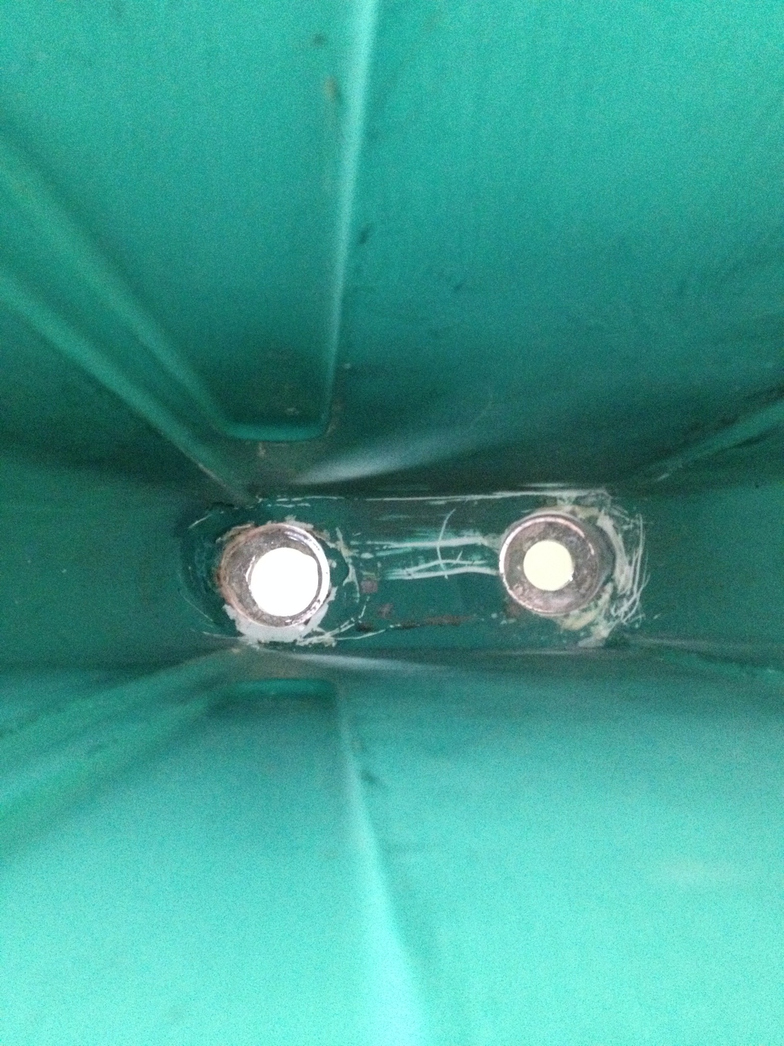

The pins should be wider than the bracket and slide up into the grooves in the trunk. Dry fit the pins Into their respective grooves. They should just touch the sides of the trunk as they near their position in the grooves. The trunk then holds them captive. If they are cut too short they will slide to one side and disengage the bracket on the opposite side and cause the CB to bind.
Looking up the groove you can see the tip of the pin in second photo.

I placed the pins in the bracket and inserted the bracket into the trunk (without the centerboard) and both pins were too long to allow the bracket to be fully inserted -- they jam in the trunk. The bracket is a very snug fit in the trunk. Easy fix, as the machine shop that fixed the bracket trimmed the new pins to the length of the old pins.
