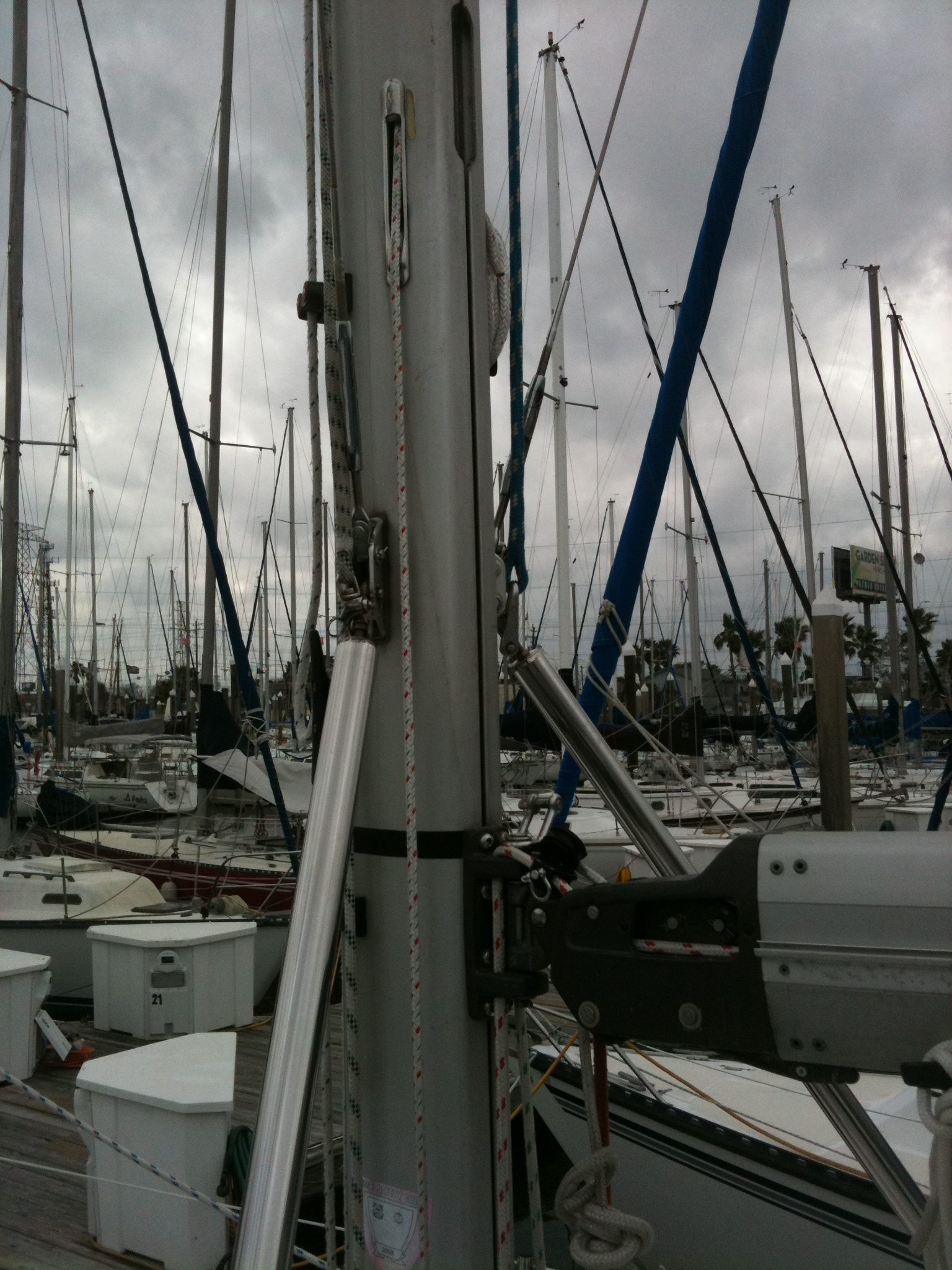

Found this photo of my 340 mast with the mainsail removed. The wider portion of the slot at the top of the photo is opened up by removing a screwed in portion of the mast slot, and the sail slides come out through the wider gap. Don't know if yours is the same. I did drop screws down the slot and had to buy replacements, so be careful, they're still down there at the base of the mast.

The mast on my 2000 H340 is the same as Bill's in the post above. There should be a removeable insert held in with two screws that fits into the wide slot on the mast. Selden # 505-516. BTW, if you stuff some paper towels into the mast slot just below the mast gate, you can keep the screws from falling when you remove/install the gate.
