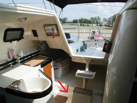

I don't have water on the floor, but the circle drain next to stair fills with water. there bilge is dry. Can the water leak from the water ballast? Is this why the teak sole flexes and is spongy (is there water trapped underneath? If so how to remove it?

What circle drain are you talking about? Can you post a picture? Most of the cabin sole area in the 26/260's is also the top of the ballast tank and should not have any holes of any kind in it.

Maybe I described it wrong. I think it might be factory installed. I don't have a picture from my boat, but a quick web search shows a few others with it. I uploaded a picture and drew an arrow. It is right in the back corner. I can't seem to determine where the water comes from and it is only a small amount, like a few ounces. when I remove it more fills in which is leading to my leaking ballast theory.

No it was not a factory install. I was heavily involved with this boat from the floor up to the first introduced by me, nearly purchased and sold 20-25% of the production line and bought the very last and I can assure you all that the drain or inspection port was not a Hunter install.
