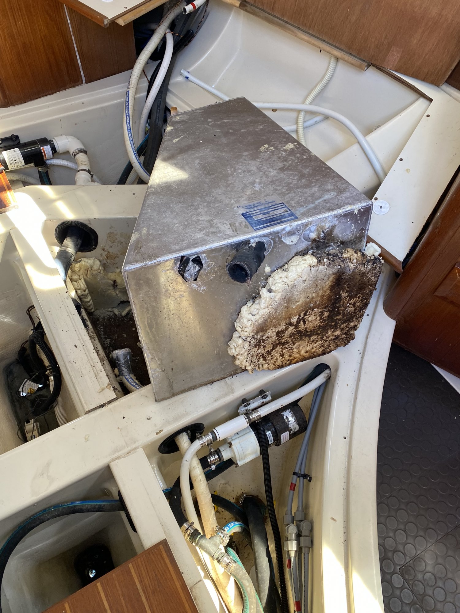

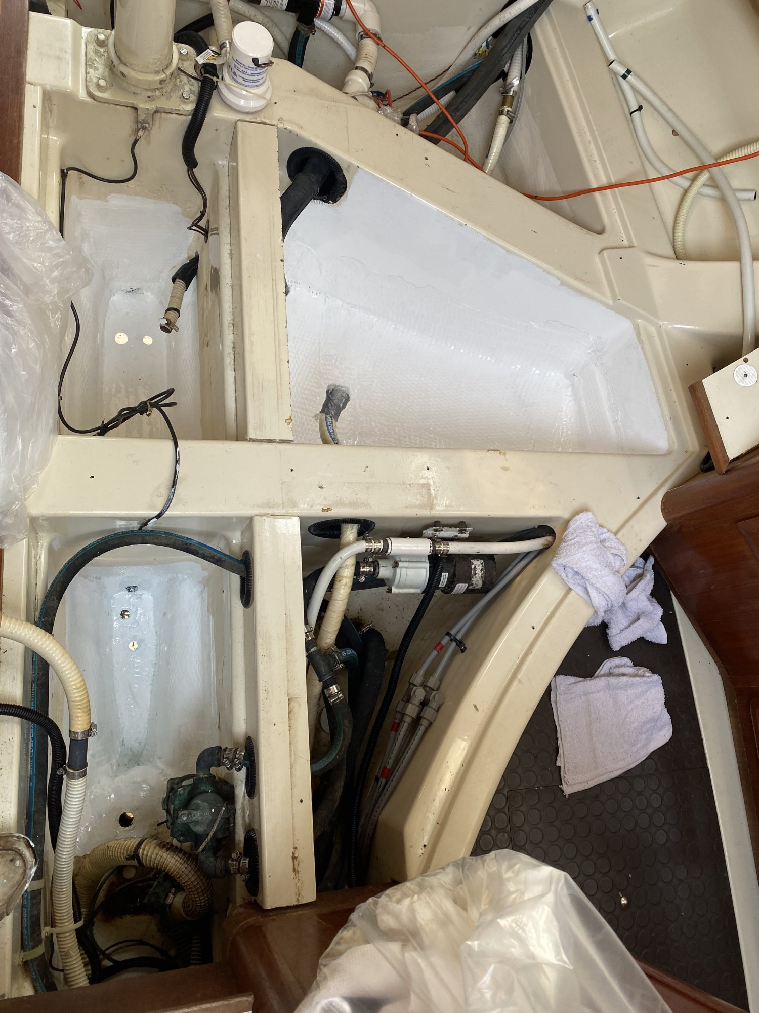

I have discovered the connections to the aluminum holding tank have less the 50% of the metal so I have removed them and I am looking to replace the tank. I read a recommendation for Dura Weld and received a drawing from them dated from1989 for a Passage42 but the waste inputs are listed as 1 inch (not 1.5 inch) and the output is 1.5 inch (shouldn't it be 2 inches?) Any recommendations for a drop-in replacement?
The previous owner sealed the tank on all 4 sides with expandable foam .... never recommended!

I will end up using a plastic tank from Dura-Weld out of Florida, They have the exact mold needed for the space and Ronco does not.
