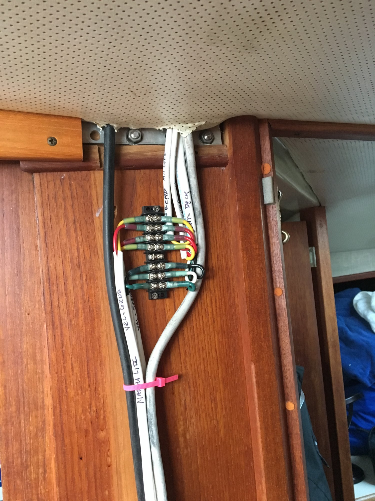

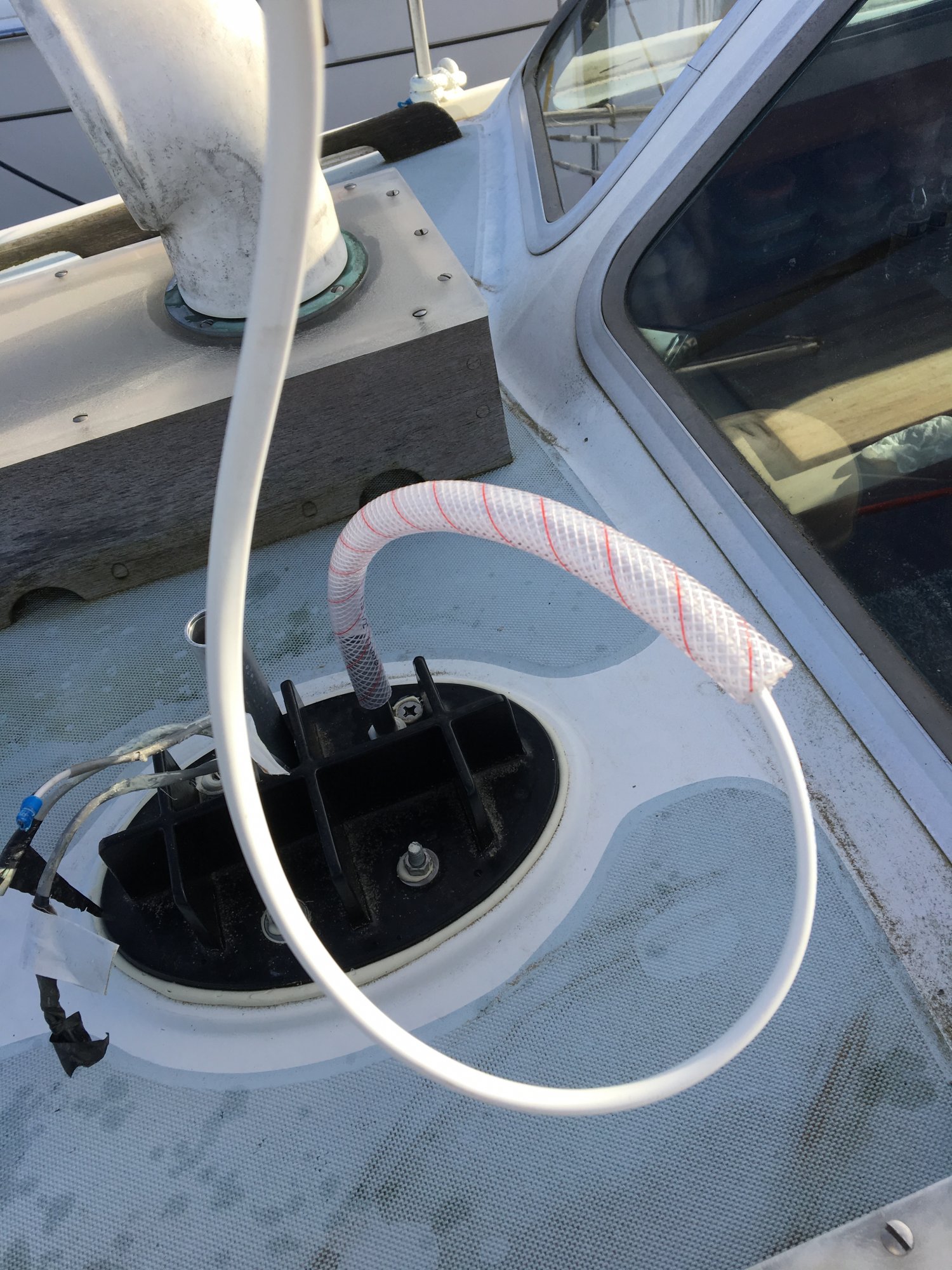

Here are a couple of pictures, what I did on my mast step.
Here is the initial attachement of the mast step. The pipes are aluminum. The wire bundle is the old system and was cut off at the mast step. I caulked the old wires. I caulked the pipes then set them into the mast step.
To add a little extra, I attached hose over the wire end then attached the hose to the pipe. This provided a smooth transition for the wires and made a great drip loop in the mast to deal with the water dripping down the wires.
I also added weep holes for the mast to drain out onto the deck.
5 years no drips.
Inside I used a terminal block to connect to the interior bundle. It allows me too release all the wires from inside the boat should I again need to drop the mast.
