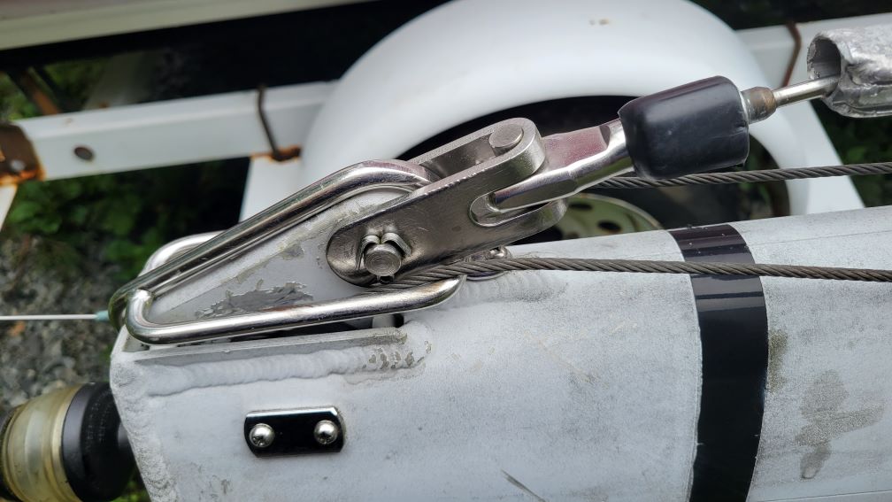

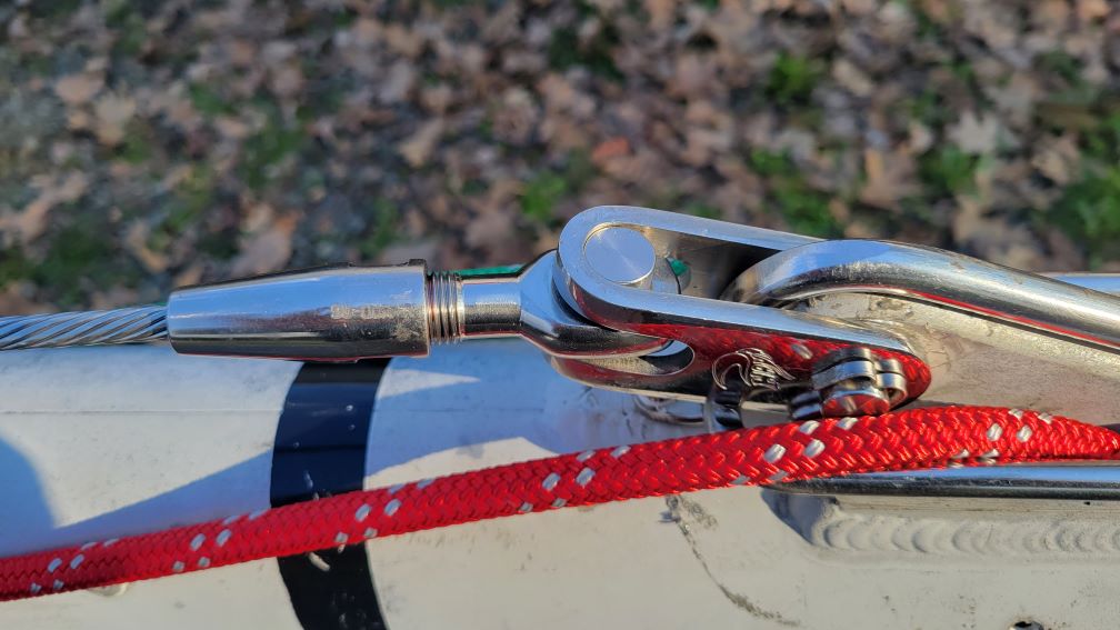

Looks like I did not update what I found at the masthead!! DOH
Both jib & spinnaker halyards were getting "pinched" between the outside of the wire cage and the top forestay connection / clevis pin. One could raise the sails with a some interference, but trying to drop sails/lower the halyards back thru the cage forestay interference was NOT happening. The big issue is the smaller wire moved fine thru this area, but the 1/2" / 10mm Dyneema is too fat to fit thru the same space.
The fix was to route both halyards underneath the cage. HUZZAH both halyards work fine. But the cage is not doing it's job. At some point, I would like to remove the cage and have a horizontal SS bar welded across the cage at the midpoint of it's vertical length. This should route the halyards up and away from the forestay connection. One point is how much force know would be applied to the cage and halyards as they would be pushing down on the cage?
Wear on the halyards?
Also considering getting smaller halyards; switching down to 3/8" Dyneema.
There was no issue with the sheaves; they seem to work fine.

Considering keeping 10mm and fixing cage. Having the halyards under the cage instead of thru is not a good situation. Can you say spinnaker halyard jam!!
Thinking of having a SS crossbar welded to tie the 2 side rails of cage together, above clevis pin and lift halyards over forestay clevis pin.

..I will have to take a picture of my cage in the next month. Yours looks off, though it may simply be angle of the forestay in those pictures as I recall a similar proximity of jib and spin halyard to the cotter pin. I don't recall the cage being so far away from the mast extrusion.
Sorry for confusion.
What I have now is 10mm Dyneema with a polyester cover. I have the option to go to 5/16 inch but I feel it's too small on the hands.
Where the cage is mounted now left enough room to fit the new 10mm halyards UNDERNEATH the cage, which fixes the issue. Note I had to coax the cage onto the mast head with a hammer. BUT still can get a nasty jam with the spin halyard flying upward and to side, to jam between cage & mast. The fix would be to add a small crossbar on the cage to lift halyards away from forestay clevis pin. then reroute halyards back thru cage.

@sheardc I am thinking of a way to make the forestay pin smoother, so I don't worry about proximity and catching. Under the cage, I can see that is not much clearance. I am over the cage currently, and will share pics in a couple of weeks. But 2yrs in, no problems to date with potential chafe and over position.
