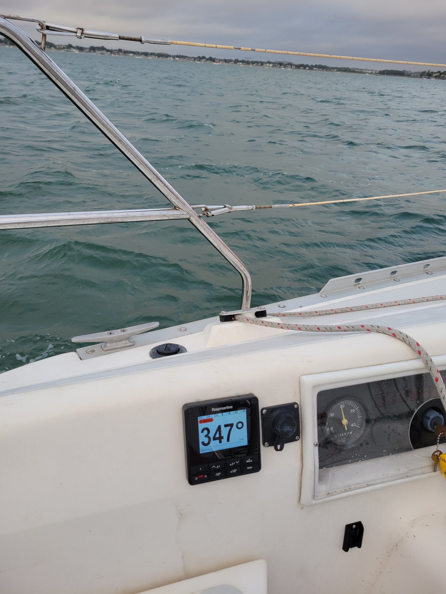

Last fall I installed an EV-100, replacing the existing ancient autopilot. I installed the control unit next to my engine panel and was able to install the rest of the gear (computer and heading sensor) as high as possible in the aft berth. There's a little space there to run the wire into the lazarette and to the back of the control unit.
From the lazarette the wire runs down under the removable panel in the deck behind the pedestal. I had to enlarge an existing hole to feed it through. Then up the pedestal and out a hole in the side to the back of the wheel pilot.
Apologies for only having this one photo of the installation. I'm moving my boat to it's mooring this coming week if you need more photos.
