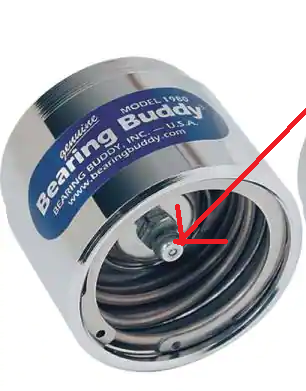

They are all fairly standard. If you go with the bearing buddies, you just need to make sure the tip of the gun fits over this nipple.

I am doing similar tomorrow (driving 12 hours round trip to pick up a boat) I have a grease gun with Zirk fittings I bought at Auto Zone @ $35 the fitting on the most hubs is Zirk.
You can pull the bearing buddy off by lightly tapping on the 9-3 o’clock positions. Wipe out old grease with paper towels and refill with new grease. After driving a couple miles and pull over make sure bearing buddy is only slightly warm with back of your hand. If it’s hot the bearing is shot and I wouldn’t drive it far or fast.
