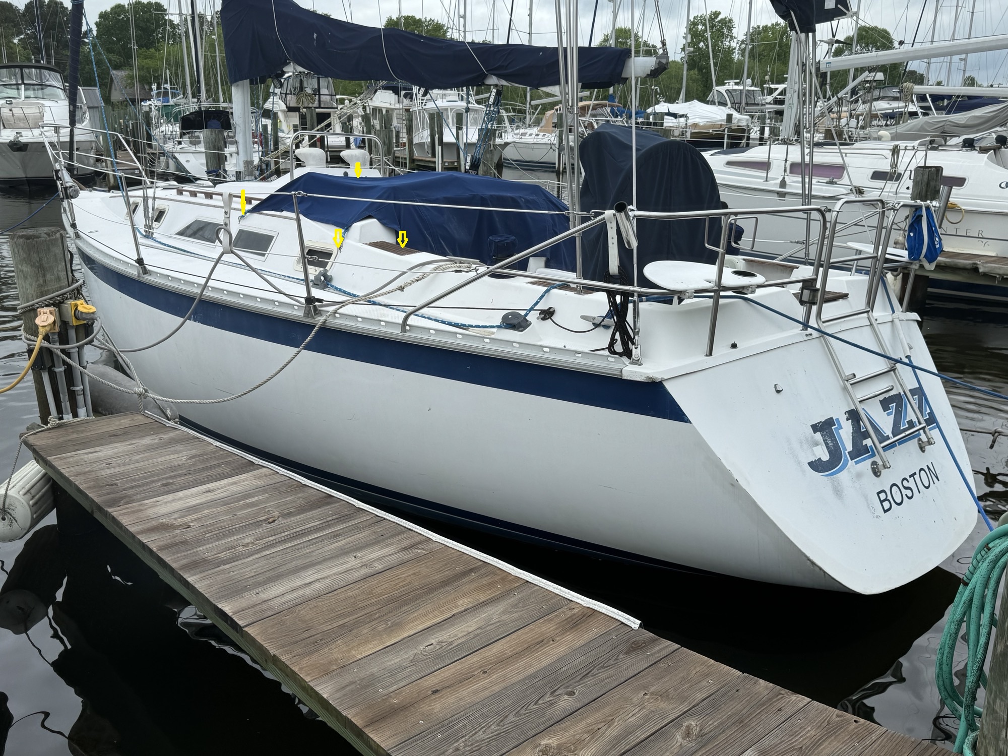

I would confirm absolutely and with out a doubt that is the path the water is taking. The water we alway found in the galley on our H34 always originated from water getting in via the sliding hatch. Even water had a tendancy to accumulate under that sea hood where the lines are routed and the hatch slides under found a way in over the headliner boards. A Sunbrella cover over the hatch and hatch boards solved that.

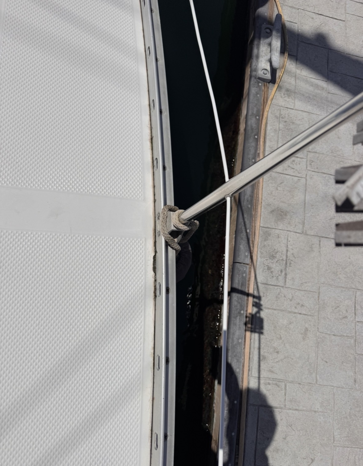

I don't see any obvious deformation of the toe rail that would make me suspect that was a cause of any leaks. Maybe a picture from a the side shows something different. Our deck had many hairline cracks along the toerail. That deck to hull joint is pretty robust and outboard. There is also butyl tape in between. Make sure the bolts on either side of that area are sufficiently tight. You may want to try blasting the area with a hose and see if new water migrates inside. I'd probably avoid a pressure washer as you don't really want to erode anything away. Scrub it clean with a brush, mask with painters tape and put a little white caulk down between the toe rail and the deck. Tool it with a gloved finger.

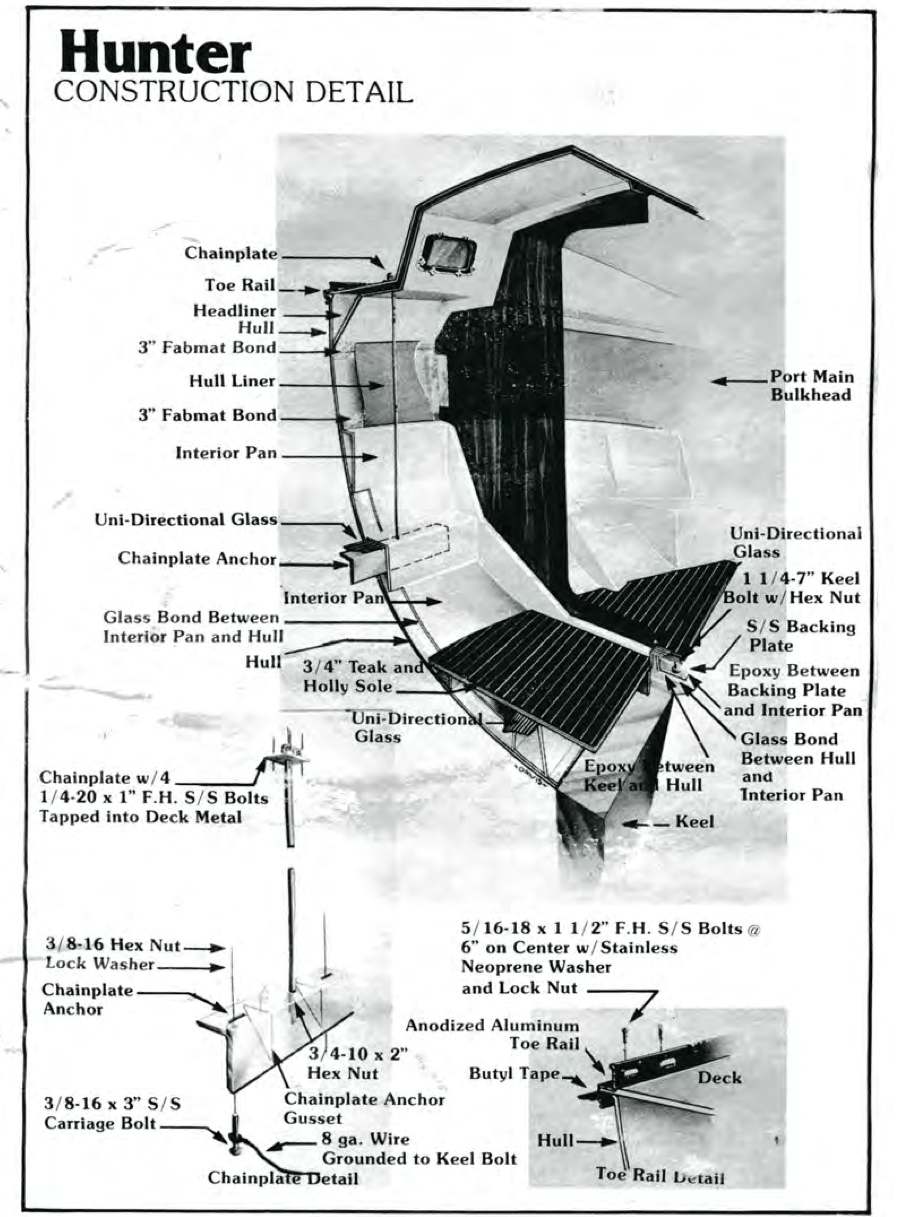

I'm with Allan on this one. The toe rail is a design that wouldn't let water in except through the attaching bolts and those bolts are sealed with a big strip of butyl sealant that remains flexible pretty much forever .. The bolts are outboard of the hull . If you see (previous notes for diagnosis) that the water is coming in there you can try snugging up the bolts by holding the top head stationary (to keep from twisting the butyl) and snugging the nut with a socket wrench.. There is no need to make those gorilla tight, just a good snug is great. (maybe 6-8 foot pounds of torque?).

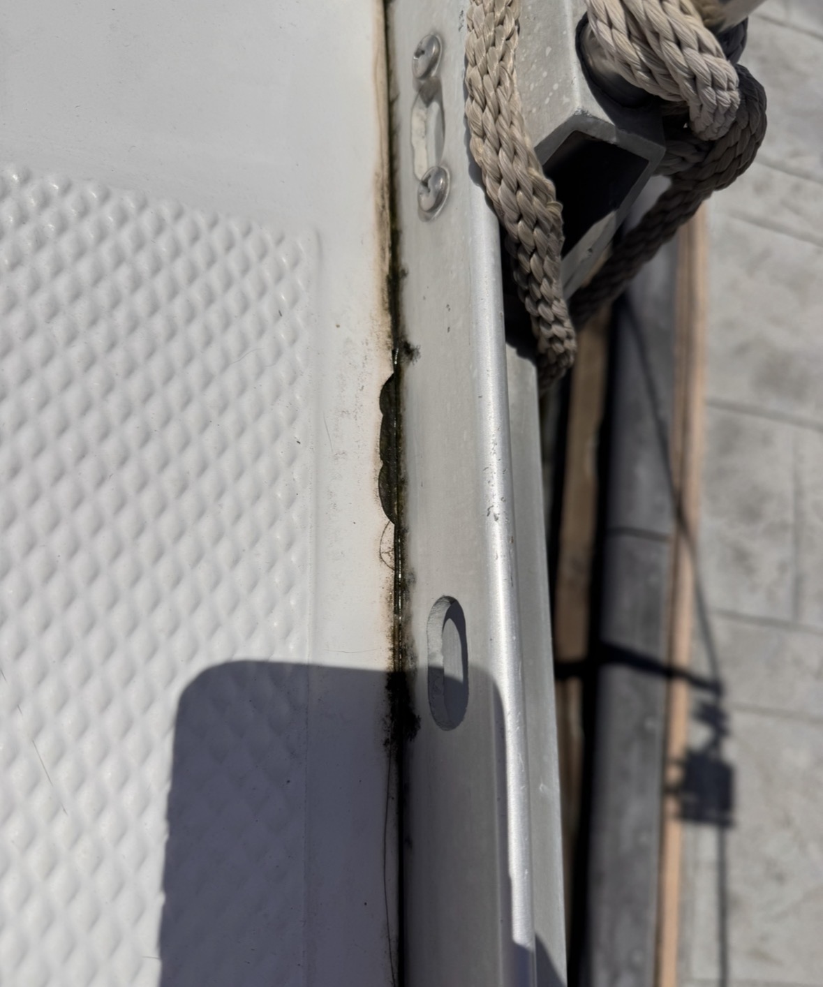

ok I am going to use the hose and see if any water leaks in from that point. I'll clean it and take another picture. Basically it looks like the outmost part of the fiberglass on the deck is cracked, the toe rail itself is fine.

The crack looks like it is only gel coat. On sharp outside corners gelcoat often cracks because there are voids between the gelcoat and the underlying fiberglass. This is a pretty common issue and is not structural. The void forms during the deck layup because fiberglass does not easily conform to tight 90° corners. After the mold is sprayed with gelcoat the glasswork begins in some places the cloth will lift away from the corner before the resin sets. Fiberglass likes nice gentle curves and will seek those curves unless forced into a tight corner. Since gelcoat is quite brittle and there is nothing backing up, it cracks and eventually the gap is exposed. The fix is to remove the unsupported gelcoat and use fairing compound to restore the shape.
If there is a port near the leak, that would be a likely source of the leak.

I have the same issues. 1) I pressure washed the deck and then caulked between the deck and the toe rail. 2) made a cabin cover that directs water away from the hatch cover. I leave two bumpers on the lid so that the cover forms a high spot and water runs off to the sides. 3) carefully remover each bolt holding down the toe rail and squeeze in some sealant and retorque.

Plus 1 for the sliding hatch. Even with a dodger I had this problem on my h34 when at the dock and wind blew rain from astern.
