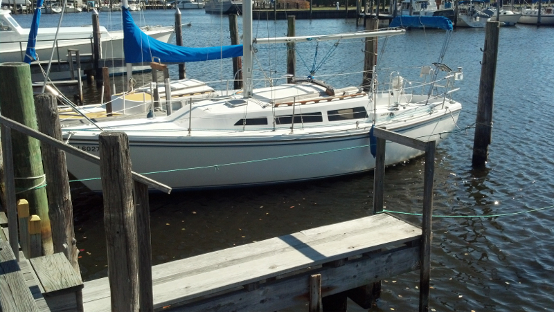

If your 1985 is like mine, the port lights are smoked Lexan adhered and screwed into indentions (no frames).
Removal is straight forward. Remove the external screws. Use a wide flat blade screwdriver to gently pry the windows from the inside using the flat blade to pierce the sealant. Work about three inches at a time. Be extra careful at the corners and edges. The edges are beveled so the windows set flush and are easy to chip/crack.
Consider tracing/measuring the windows beforehand. Could cut replacements or have them made. Cruising Concepts makes new windows.
Remove the remaining sealant from the frames and windows. A flat screwdriver blade works well. Once mostly removed, sand the frames to remove the rest. Wipe everything down. I avoided solvents as I didn't want them interfering with the seal.
Dow 795 is a great choice of sealant. Generously apply sealant around the edges of each window. Set into the opening, press around the edges, insert/tighten screws. I had to redo a window because I didn't use enough sealant in one spot.
To keep everything clean I applied painters tape all over. Made a nice edge when removed and avoided messy cleanup. Take the time to do the taping.
