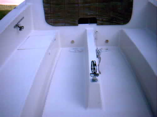

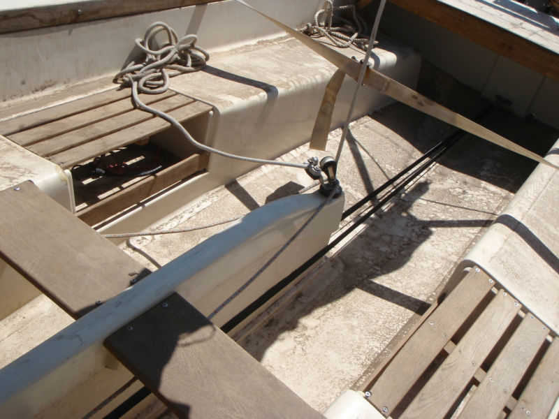

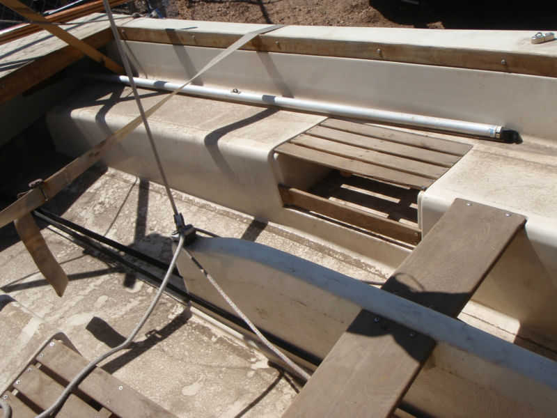

The problem is the question is in regards to a 1984 DS II, so the CB is line-operated, no lever. The CB trunk is also strongly braced by the raised cockpit sole (DS II has a "self-bailing" cockpit). So, I am baffled as to how the CB trunk could be "leaning to one side"?
Is this boat actually a 1984 "O'DAY", or is she a Rebel/Spindrift-built DS I (O'Day stopped building the DS I around 1977 and the DS I after that was built by another builder until last ones were built around 1987, DS I was replaced by the DS IV, built by Sunfish-Laser starting in 1990).
If actually a Spindrift instead of an O'DAY, then did someone remove the 2 seats/braces that connect the CB trunk to the seats? If so, that may be how the CB trunk flexed enough to crack and now lean to one side.
First 2 pictures below show a Spindrift DS I vintage 1984. Third picture shows a 1984 O'DAY DS II cockpit.
