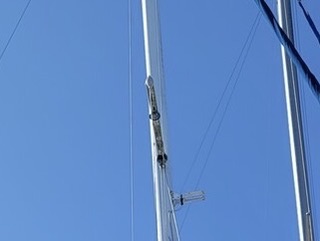

I copied this image from a 1984 Capital Yachts Newport 30-3 — For Sale
Does this look like your spreader?

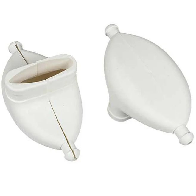

If so, it looks like a spreader boot offered by West Marine.
Spreader Boots
Model # 9113473 Mfg # SPRBOOTSL
Key Features
  • Provides chafe protection for sails that contact spreader ends
  • UV resistant synthetic rubber construction
  • Can be installed without loosening or modifying rigging
  • Available in three sizes to match spreader tips and wire diameter
  • Sold in pairs
It's a pretty standard design. If you don't send someone up the mast, you may have to guess at the spreader tip size.
