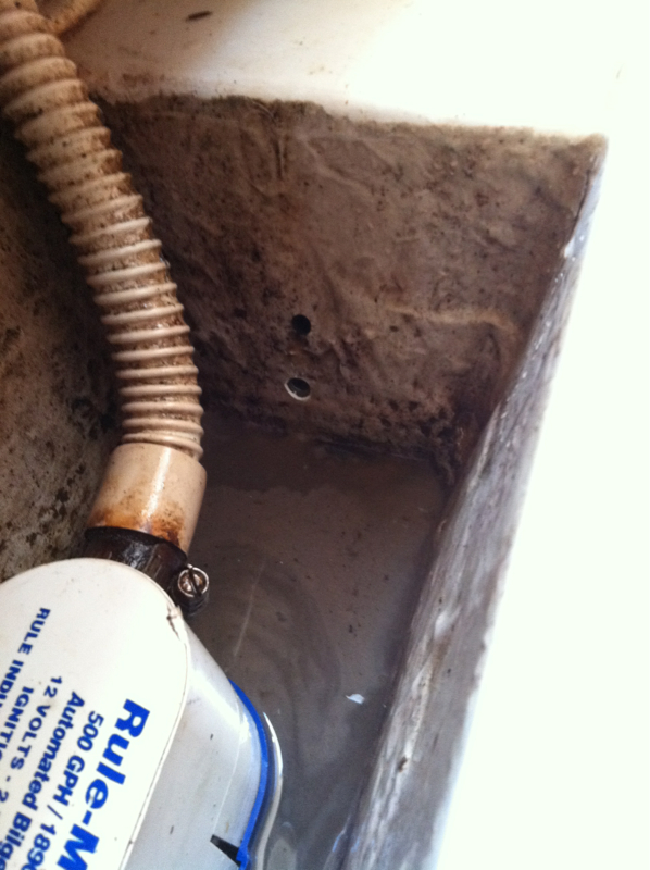

Yes, you are correct there is a liner. A bilge within a bilge. people have water stuck between the two and that is the cause of there odor. Many people drill holes in the bilge (forward & aft) to drain the water. Mine had trapped water I drilled a small hole because I didn't want to sink. About to gallons of water came out. There is about a 1/4" of space between the liners. This is my hole. But it should have been lower. Hope this helps.

I discovered that one of the previous owners drilled limber holes for and aft from the bilge pump chamber. I also discovered that sucking out the bilge water using a wet/dry vac reduced the odor in the cabin.
