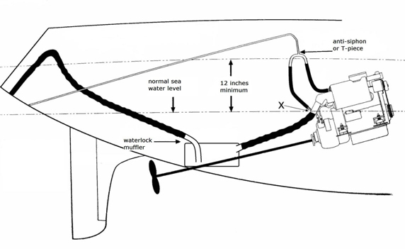

your diagram shows antiphon t terminating above water line. if so it's a good idea to inspect and clean your antisiphon valve . while you are stored on the hard it can get clogged up with insect nests .

Did you disconnect the exhaust hose from the exhaust elbow and fill it with the water hose or did you disconnect the raw water intake hose? If it was the exhaust hose, the water should eventually fill the muffler and hose and spill out at the disconnect unless you somehow sealed the connection between the water hose and the exhaust pipe. This is because just before the exhaust hose leaves the boat it is looped very high.
But if you connected your water hose to the raw water intake system, there is a chance that water will fill the exhaust hose and muffler and then back into an engine cylinder if an exhaust valve happens to be open when the engine was shut down. I found this out years ago on a 3gm30. Luckily, I discovered it before restarting the engine and was able to dry out the cylinder after removing an injector.
