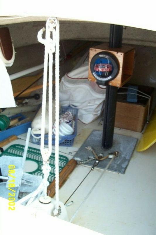

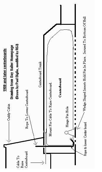

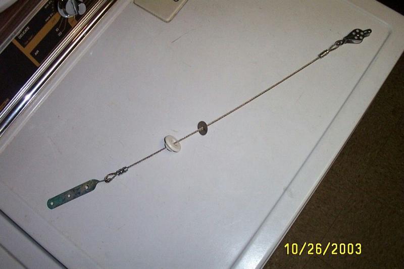

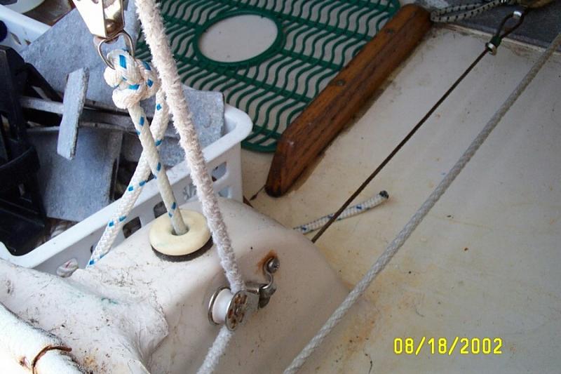

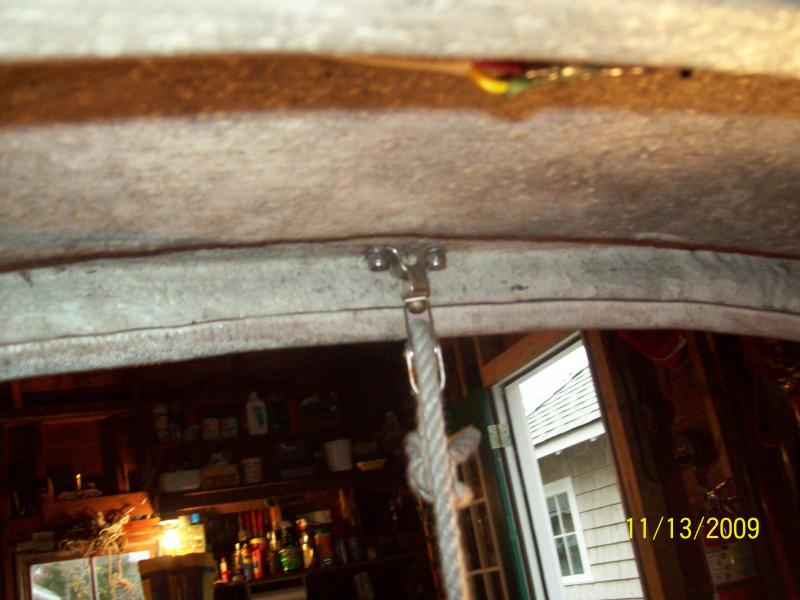

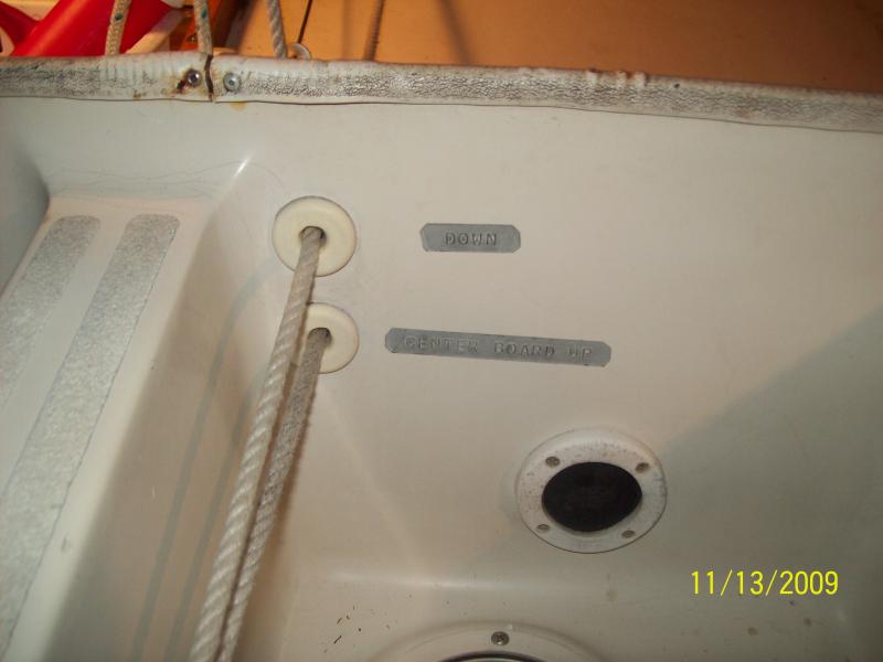

All years of the DS II came from the factory with both the upline and downline for the CB. So, it is just a matter of restoring what was originally there. I don't have a good pic of the CB rigging on a 1984 model, but the pics of my 1979 model should be close enough (basic rigging of CB did not change)
