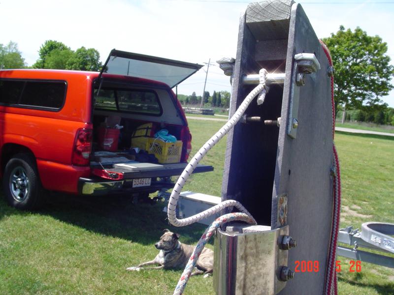

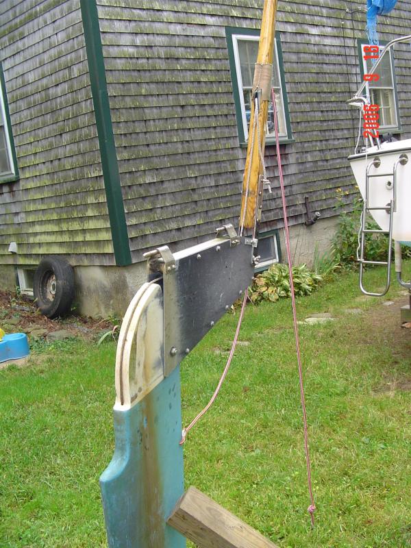

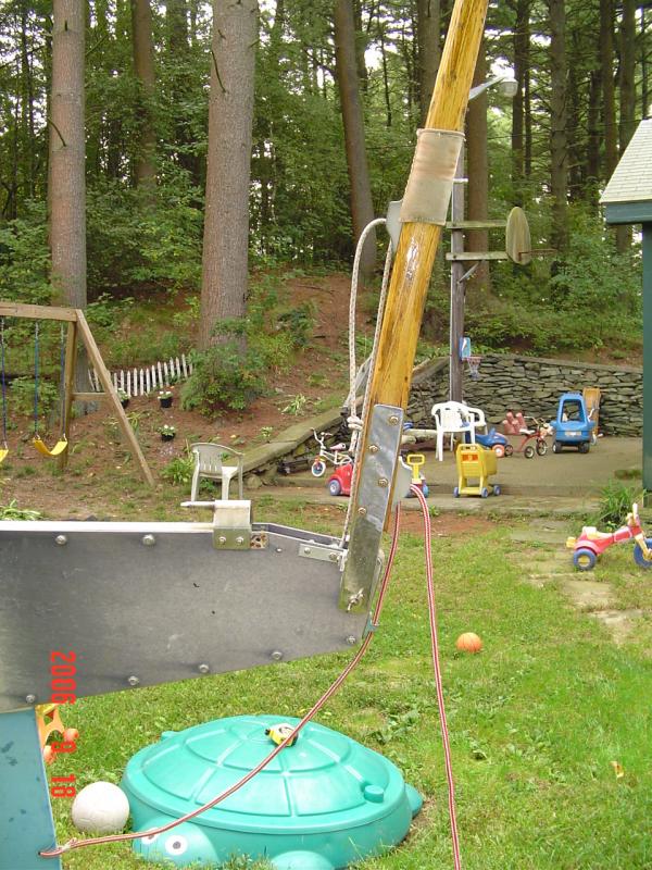

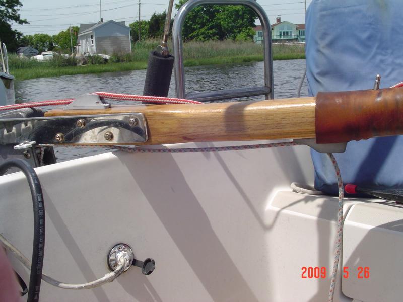

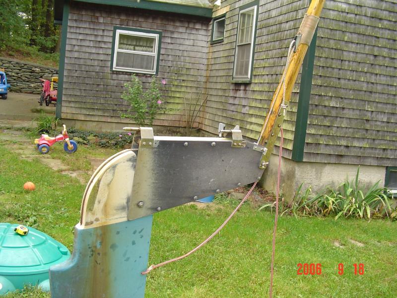

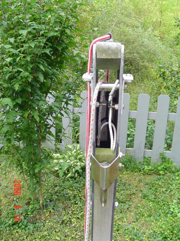

I modified my rudder years ago by lowering the pintles which provided more area at the top of the rudder head to accommodate an O'Day 25 tiller. I added a couple of stops to the sides of the head to support the tiller from rubbing against the top of the transom of my boat. I made up the stops from a couple of Aluminum storm door "L'' brackets that can be found in any hardware store. The tiller clears the top of the transom with enough space for the rudder blade hold-down pendant line that runs to a fair lead clam cleat which is attached to under side of the tiller.

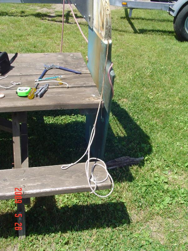

The biggest problem with the rudder hold-down pendant line is that it can sometimes get caught in between the inside of the rudder head and the blade when the rudder is up and you try to pull on the line to get it down.
This can be a pain because the rope gets caught and you need to reach down over the transom to free it and get the rope on to the upper bout of the blade in order to get it to work properly.
O'Day knew of this problem and what they did to solve it was add a 12"X 3/16" bungee cord to the pendant line by crimping a hog ring to it. What this does is; it puts tension on the pendant line on the upper bout of the blade to center it when the blade pops up. This may or may not alleviate the problem altogether. I had to do a lot of adjustment on the rudder head to eliminate the problem altogether.
One of the other mods I did to my rudder was to provide it with a rudder blade hold-up pendant line.

Anyway, here's some pics plus a pdf of a sketch that I made that you can check out and if you have any questions just fire away.
