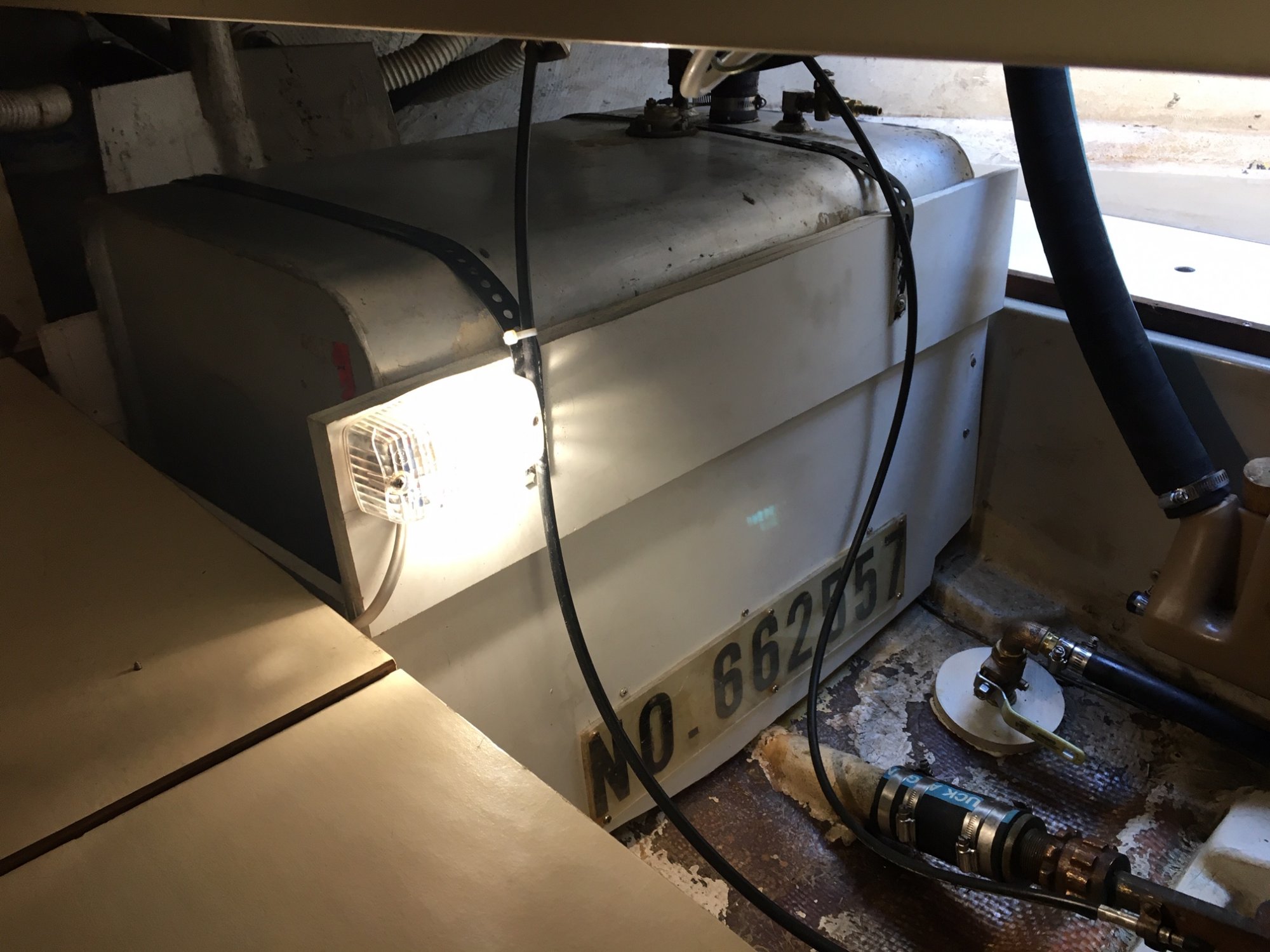

For all of you that might be interested:
So I think the fuel tank is put in place via the engine access when the boat was built.
How do I know this. I really don't but it would make sense as that's the only possible way in or out.
My plan to clean and rebuild the area has been bugging me, so yesterday, I tackled the challenge.

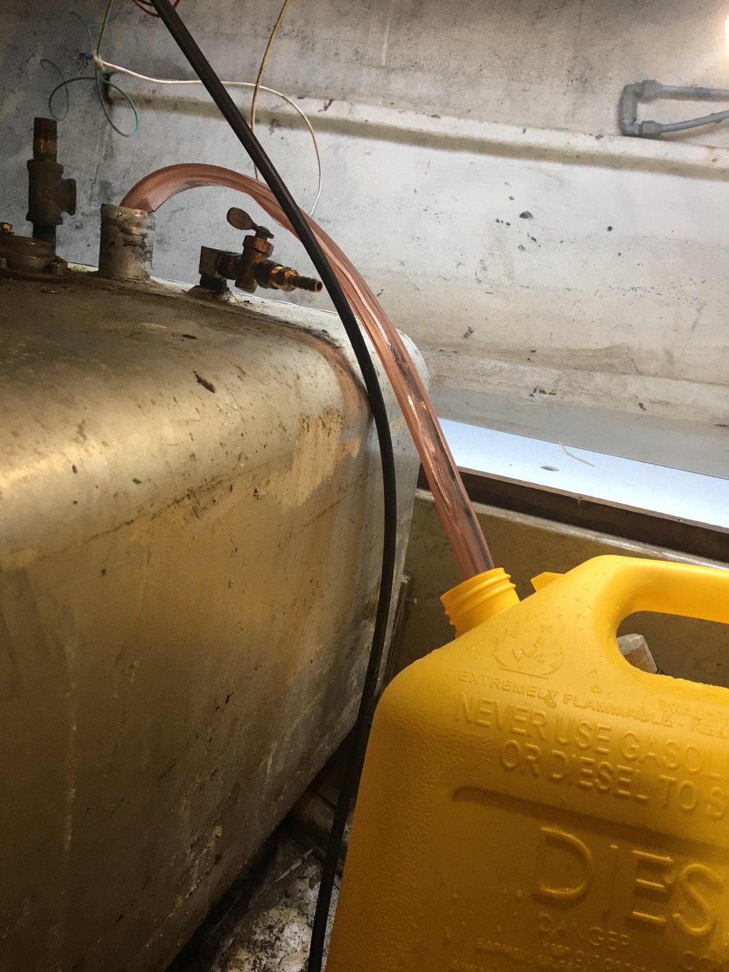

In advance I had removed as much fuel as possible, using an electric fuel pump and a filter set up.

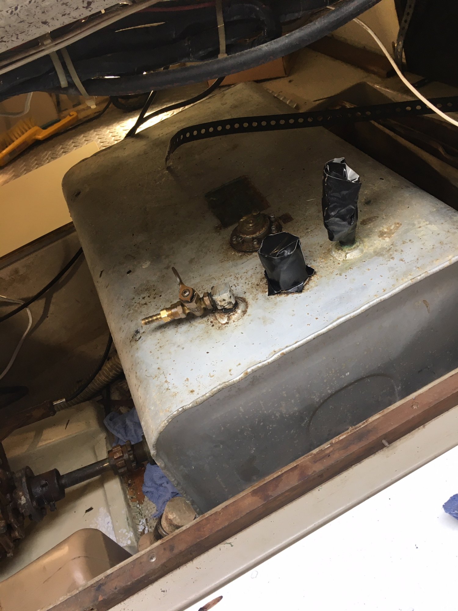

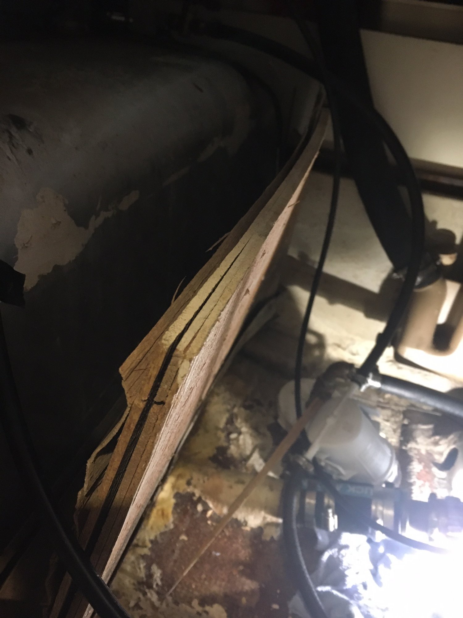

Yesterday I reviewed the task at hand. The plywood frame around the tank is totally shot and the tank has sunken past its base supports. After a good cup of Tea, I siphoned out as much fuel as I could, to make the the tank as light as possible. I started removing the flow back line, the filler hose, the wires to the fuel sending unit and the fuel line. Last of all, the hold down
straps.
Then, very carefully, I removed the crappy and disintegrated marine plywood, trying to preserve it to use as patterns.
I then lifted the tank out into the lazarette. But it would not come out through the opening. The filler neck was in the way.
So I drained the remaining fuel and crud out by tipping the tank into a shallow basin, multiple times, pouring the bad fuel into a fuel jug. (I'll deal with that later)
To try and remove the crud and clean, I poured two cans of brake cleaner into the tank, swished it around, and drained. What came out was disgusting. But its done. Allowing air to enter, the rest of the break cleaner will evaporate.
The area was cleaned and checked.

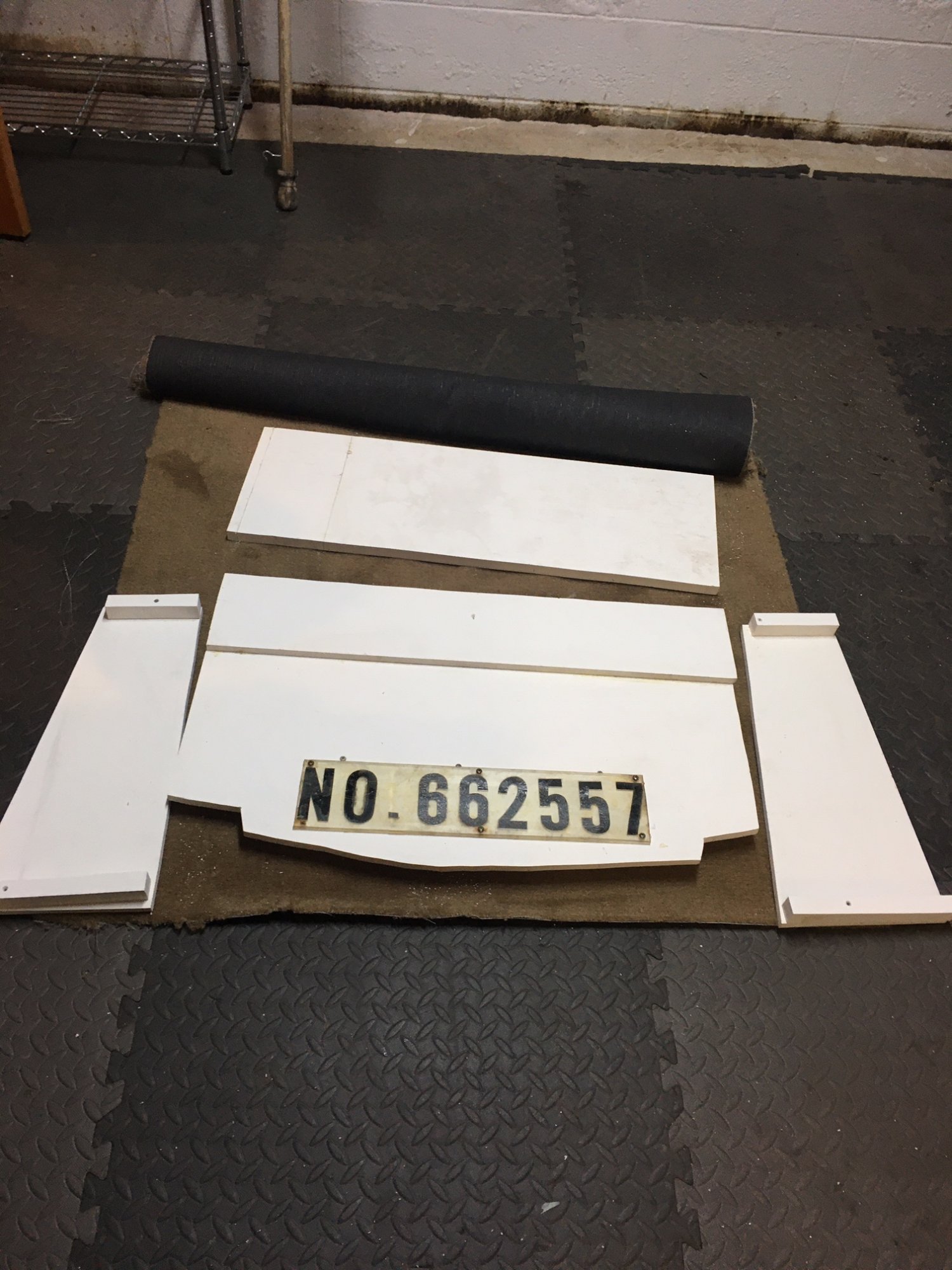

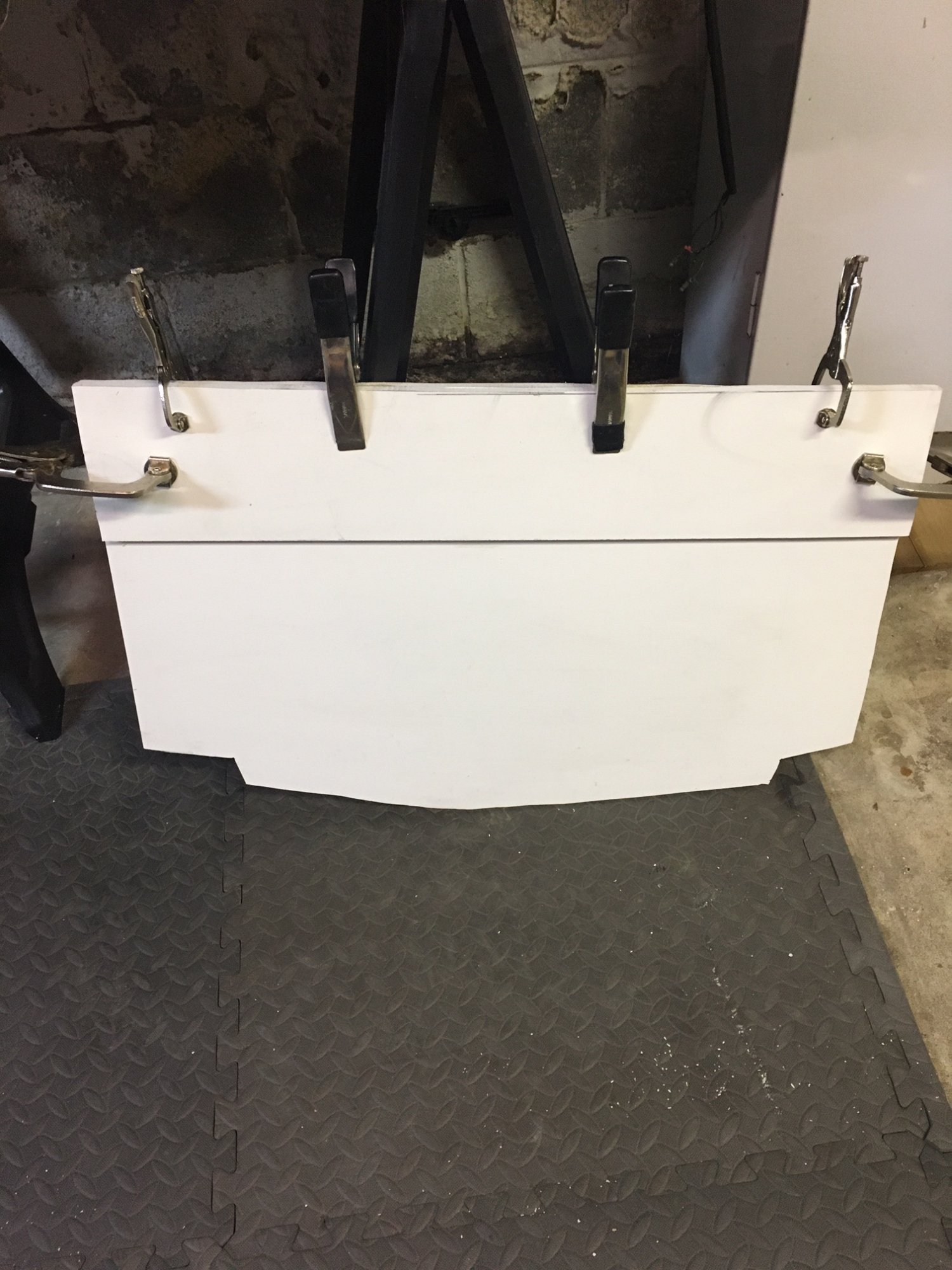

I then created a new tank holding box out of all the left over PVC board I had from other projects. (I did this at home in my work shop)
The US Boat Documented numbers have been put back on.

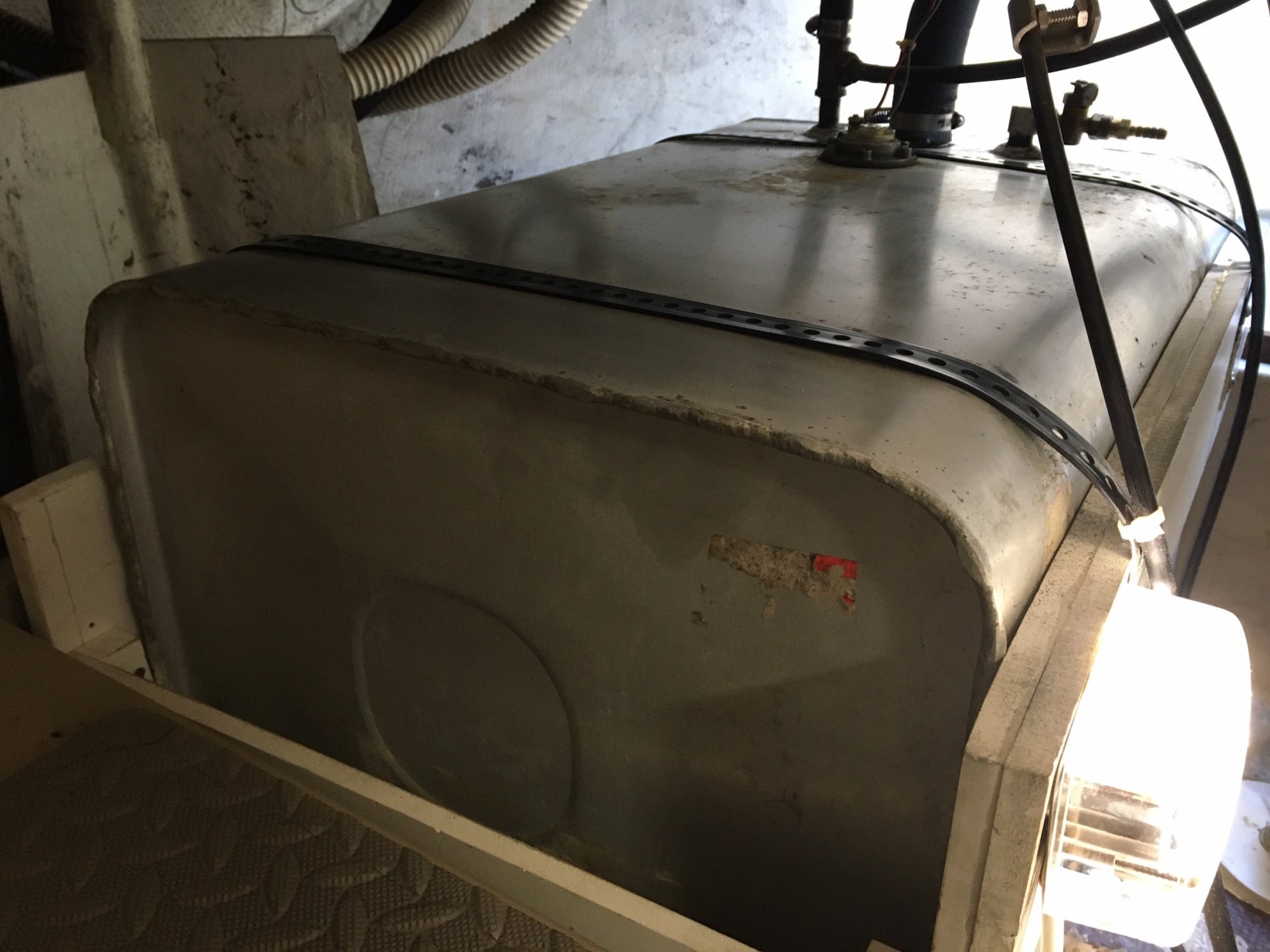

Today I took the disassembled, box down to the boat, made some slight adjustments and then re installed the tank. I'm going to leave it empty till the spring.
Sorry about the pictures, I am terrible at photography.
