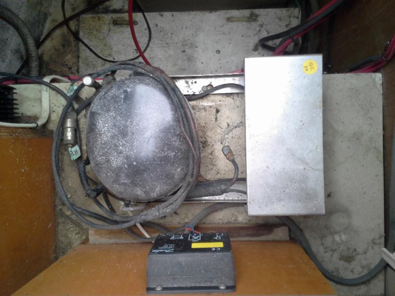

Hello everyone,
Today my fridge stopped running. Anyone ever had this type of fridge stop working?

Your refrigeration unit appears to be a standard simple reliable design with either a Danfoss BD2.5 or a BD3 compressor. Both compressors inside are fixed speed and motor rotation is controlled by an electronic Module through a 4 pin plug on compressor. The control module is a 102N3030 or a 3031 with an exterior fuse on bottom under a gray plastic cover. Question in picture, at left side there is part of a cooling fin what is this and is it connected in anyway to refrigeration unit?
There are a number of reasons why compressor stopped running: Module failed blowing fuse, Fan drawing more than 1 amp but still running, Someone in the last year has tampered with refrigerant, Thermostat or its wiring not completing a closed circuit and the most likely problem is a voltage spike do to age of boats wiring or DC power grid resistances.
If you follow troubleshooting below you will avoid an expensive service call.
Troubleshooting 4 pin modules consists of the following:
Check module fuse and refrigerator circuit breaker first.
1. Place jumper wire across thermostat terminals, Compressor still does not run.
2. Disconnect black fan wire from electronic module, Compressor runs replace fan. Compressor still does not run after fan ground wire is disconnected. If one of the 10 transistors in this fan fail it can cause module to prevent compressor from running.
3. Run correct size and correct polarity fused jumper wires direct from a fully charged battery to module in order to bypass all boat’s wiring. Volt meter readings are of no value, Compressor still does not run electronic module needs to be tested on another unit.
