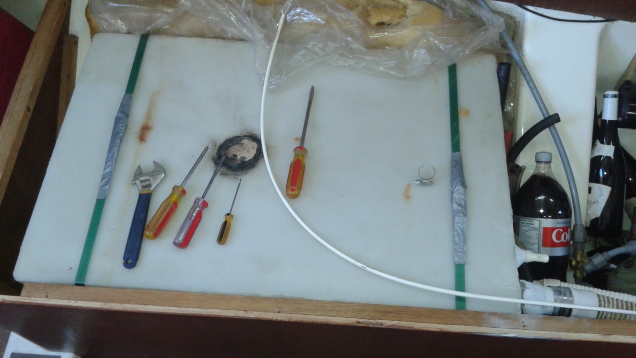

Hi Robert,
There are definitely screws & they are probably covered with paint ! They screw into a piece of hardwood near the edge of the side as per pix with the tools showing on top of tank. The diagram you refer too is probably this one which shows approximately where the crews are located on my boat (84). Furthermore, there are jams which need to be unscrewed in the little storage areas on the backside of the settee as shown on the diagram. 1983 was the first production year of the 34 and I doubt that Hunter would have made a change there. Feel for the screws around where shown on the diagram and scrape the paint off. You could also carefully insert a putty knife or a small flat blade screw drive in the joint between the sidewall and the seat itself right at the aft corner and try prying the seat up softly. You might then locate the corner screw. Scrape off the paint above it and remove it. Pry up a little towards the next screw and repeat the procedure. It's not hard but it is a PITA. Good luck.

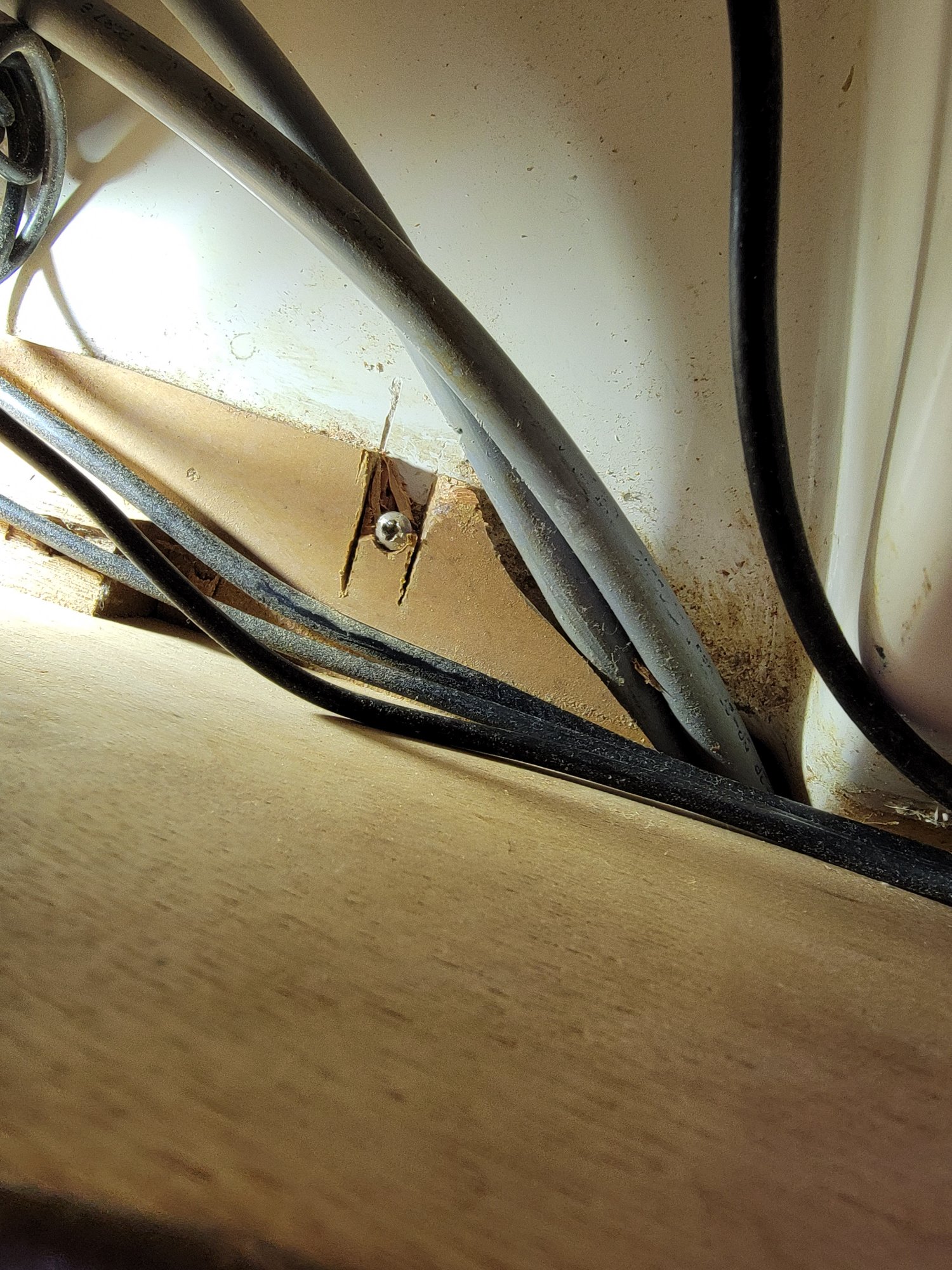

I used a mirror to locate the screws which unfortunately were put in from the underside going up. I can get to a few from the two openings but the ones near the tank will have to cut or pried . I guess Hunter changed their construction after 1983 so owners could get to the tank easier
Thanks for your guidance

When I removed the portside tank I found the screws were holding the top on but a couple were holding the face plate of the oval hole cabinet, I was able to remove all but 1, I used my multi tool to cut the wood away from the remaining screw. Then I removed the screw, and replaced it and a large washer.
