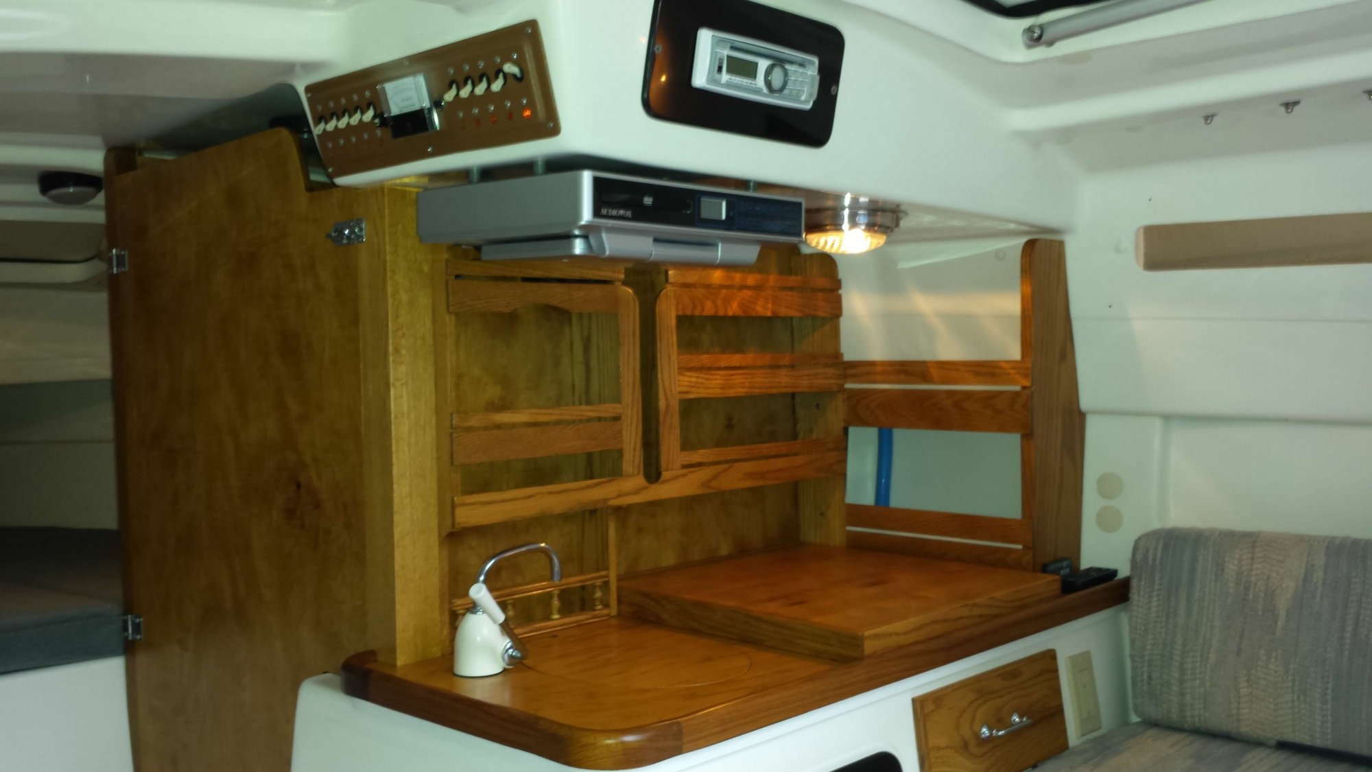

Baltic Birch is a good choice. I used it on my Macgregor 26S. Baltic Birch has very few voids, making it very solid and strong.
12,776
You could tongue and grove some 1-by pine boards into a solid wide piece. Pipe clamp with gorilla glue and then sand it smooth ... stain ( I’d go cherry) and varnish. If you already have the tools, that would be the least expensive and it would produce the best looking result. You would need a good table saw. A set of pipe clamps and an orbital sander.
