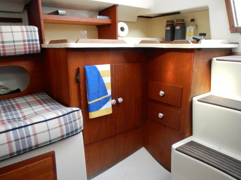

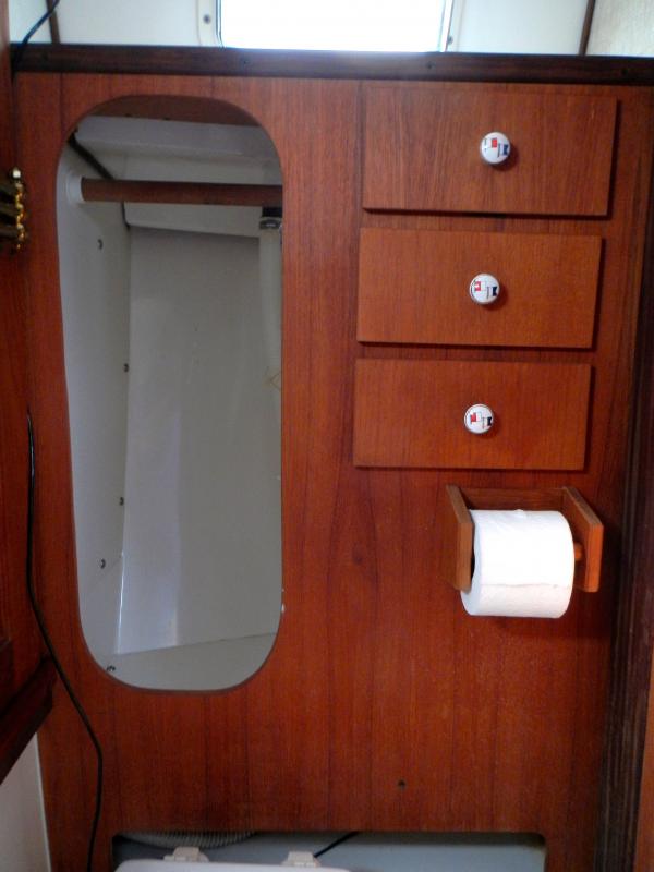

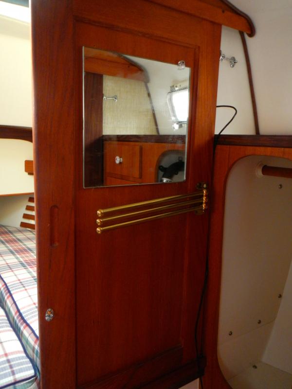

Wow that cabinetry around the head looks great. A lot cleaner than the H27 I bought a couple months back. How did you treat / clean your wood and it looks like oil on there now, is that correct? Again, looks great !

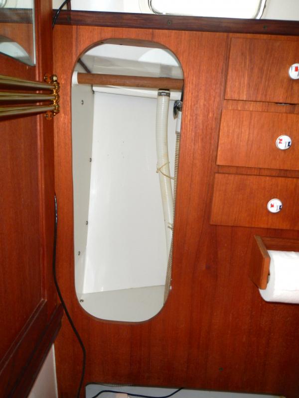

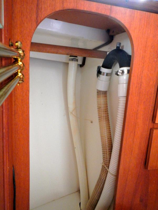

That hanging locker looks great! I have the same, but it is filled with head plumbing. Where are your head hoses?
May 11, 2014
30
Hunter 27 Traverse City
The only hoses in the hanging locker are the ones that go to/from the holding tank. The raw water intake runs through the wall between head and v-berth. Changing the hoses is on my 'to do' list..... they are nasty!

Thanks! I can't take credit for the cabinetry. My wife scoured the interior of the boat when we took possession. She used Murphy's soap on the wood and it came out great. Haven't done anything beyond that at this point. We do have a couple areas where there is some water damage that we will tackle at some point.

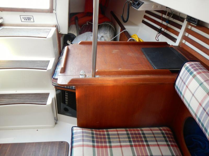

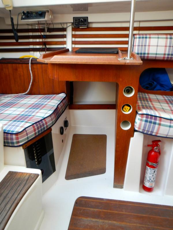

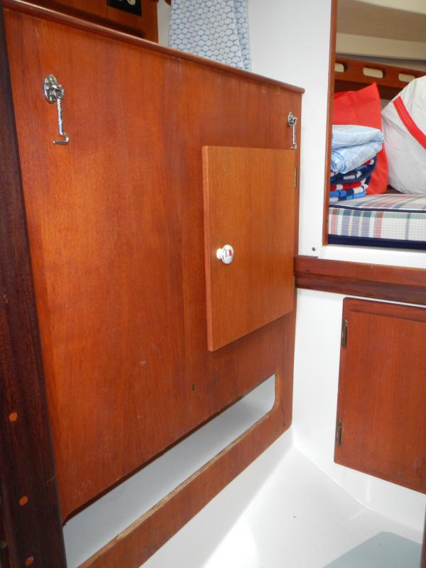

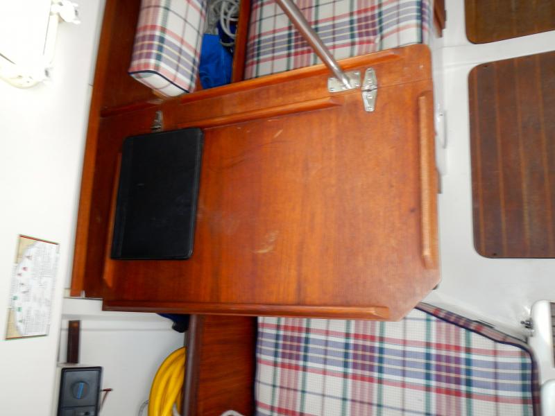

May 11, 2014
30

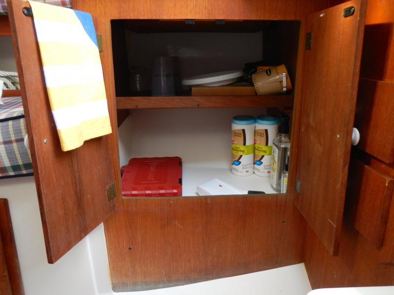

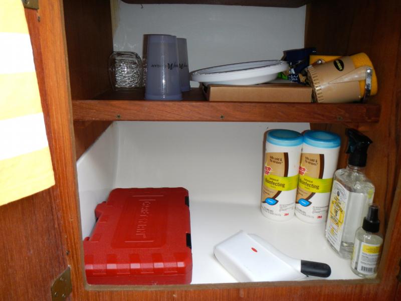

Each door is 9.5" x 18.75" and 10" up from the lowest part of the floor.
There is one shelf that is about 11" up from the bottom of the cabinet. It is either 17" or 19" deep (can't read my own writing). Hopefully the pictures will make sense.

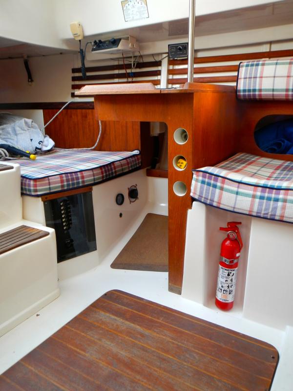

I also took a few photos of the nav station. Let me know if you need measurements.
As for a locker on the port side. Are you talking about the quarter berth??
Hope this helps!
