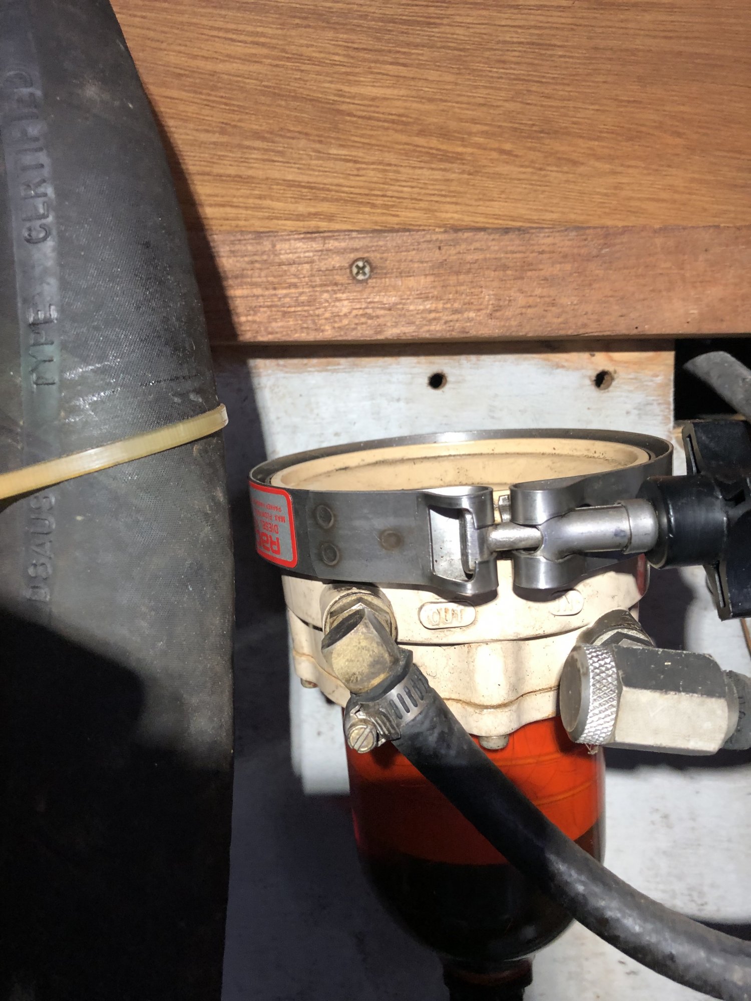

My recently acquired Universal 5424 powered Tartan 33R has a primary Racor filter that someone that I reached out to with a picture said may be a 200FG. There is also a BF940 spin-on filter on the engine. The boat came with a survey from 4 years ago, where the surveyor mentioned the lack of flame arrestor on the filter bowl (or something like that, I don't have the document in front of me). Should I just replace the entire filter assembly in order to become compliant?

A metal bowl is required for USCG inspected commercial vessels. There is no such requirement for recreational vessels.
Thanks, I guess I'll put that down to the bottom of my priority list. The overall tone of the survey was quite nit-picky for what I consider to be an excellent boat in very good condition. I suppose that's to be expected when he's getting paid by a buyer.

Flame arrestor is probably the wrong term. I believe the issue is with the clear plastic bowl meeting some flame resistance specification. The compliant Racor 110A has a metal bowl and the Racor 500MA has a metal heat shield under the clear plastic bowl.

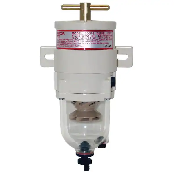

Pictures might help.
Here are Racor 500 series filters.
The Racor500FG

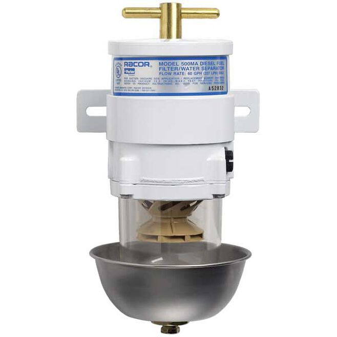

and the Racor500MA
The M designates that it meets the CG design requirement to be installed in a boat's engine room.
