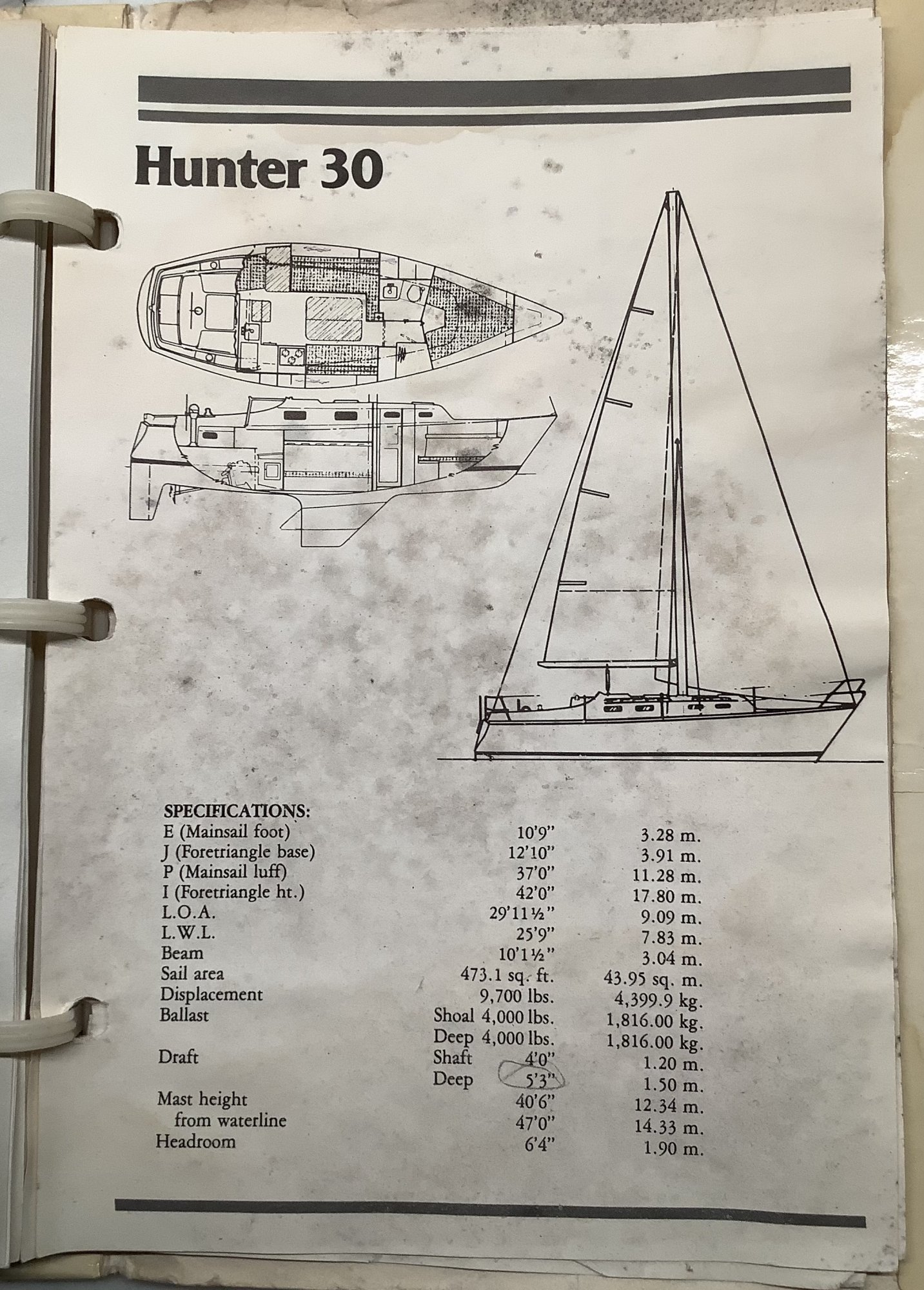

My deep keel ‘82 H30 has a skeg mounted rudder and I always assumed, based on the owner’s manual diagram, that all the Cherubini H30’s did. Maybe I was wrong. Do the shoal keel H30’s not have a skeg? Is this boat deep keel or shoal keel? It would be impossible the bend the rudder stock without seriously damaging the skeg….if it has one. Or used to(?).
It will be interesting to see photos.
May 27, 2004
2,059
Yes, the shoal draft version has a skeg just as the deep draft model.
We'll have to wait for the OP to report back as to what the actual damage is.
But, if the rudder moves freely except passing the centerline, I doubt the
rudder stock is bent.
