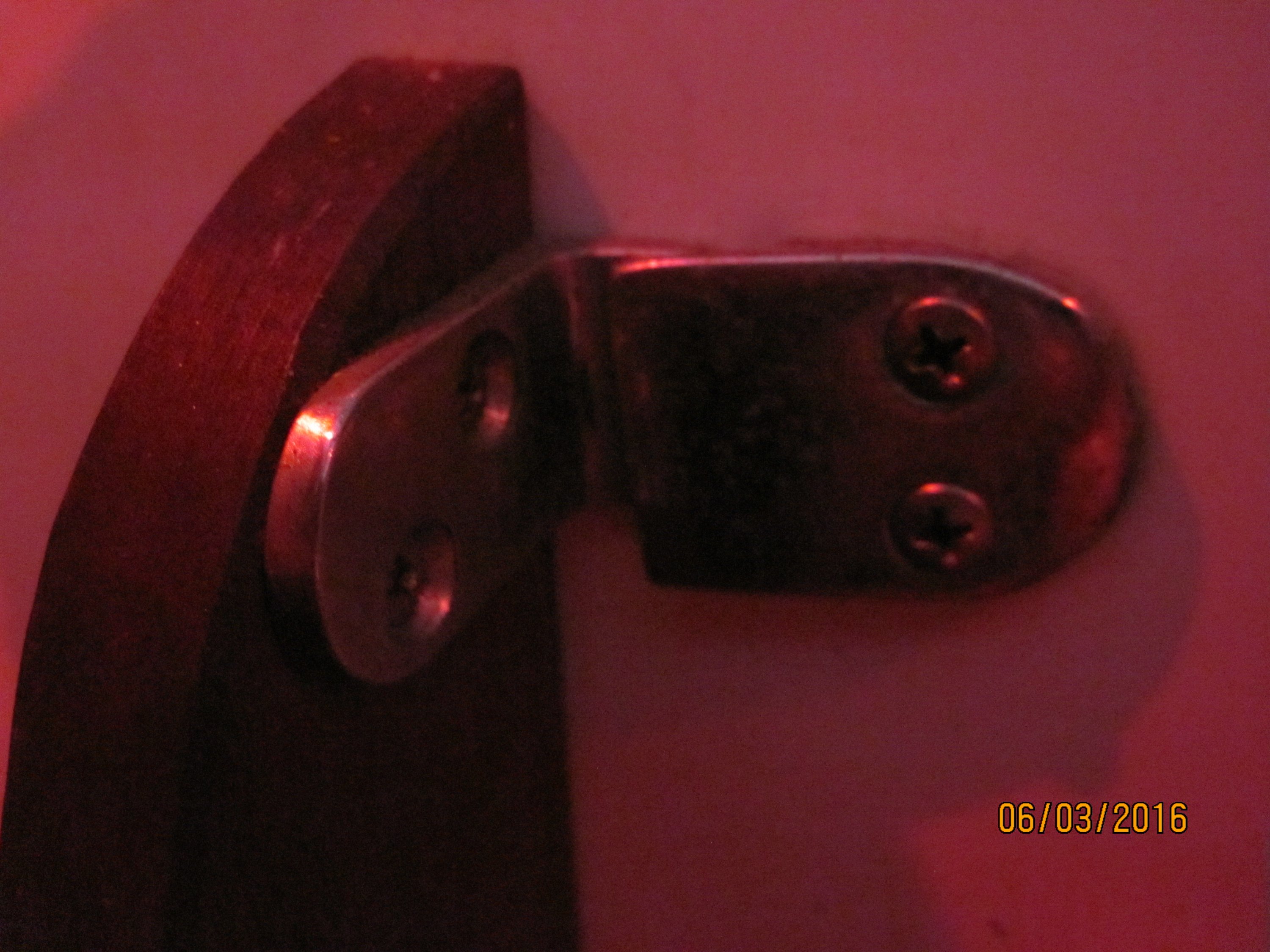

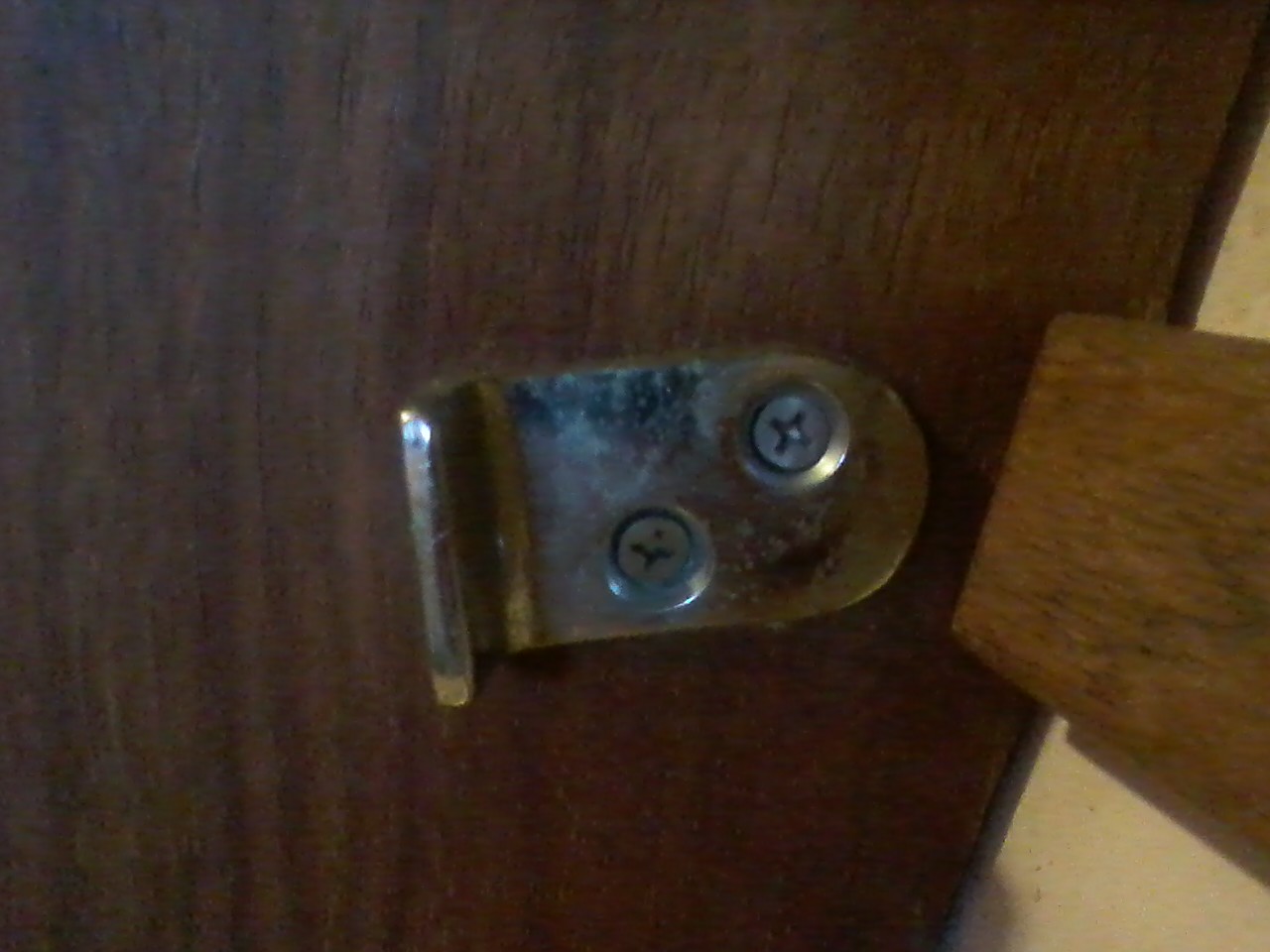

I'm slowly restoring my salvage 1981 H22. The next job is cushion replacement. I have all but one of the original cushions and they are in TERRIBLE condition. A local upholsterer is doing the labor, I supplied all materials.The missing cushion is one of the two salon backrests, which was lost when the boat sank at the mooring under a PO's watch. I can not find the matching mounting hardware for the replacement backrest in any hardware store. Seems pretty unique.
This type of mounting also allows for removal of the backrest by sliding off of the cabin-mounted brackets. The cabin-mounted brackets for the missing backrest are still installed (See the bottom attached picture), but I can not find the hardware mates to install on my replacement board for the backrest.
Similar brackets are used for the companionway steps (see the top attached picture).
Does anyone have / know anyone that has a salvage boat with these OEM parts available ?

Thanks bunches Peggie for your prompt reply !
But....the bracket in the pix may be a little misleading as it is only ~ 1" tall by ~1" wide.
Not much of a surface area on which to apply velcro, BUT you may be suggesting... drilling holes in the angled piece, adding some sort of extension bracket (not too big, not too small), then applying velcro...
I like it.

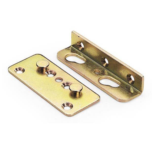

I'm also thinking along the lines of an angled bed frame corner bracket (see below). It's removable, requires much less shop work by me, and would be painted to protect from salty air/corrosion....
ANYBODY have other ideas out there ??
It would be much appreciated.

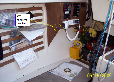

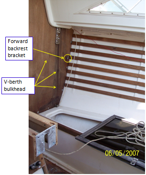

isaksp00,
Thanks for another idea, but I don't have shelving to hook to.
The older H22s (80s) like mine have no storage above the cabin seats, only the bulkhead to the v-berth (see TOP pix attached) and another mini bulkhead aft next to my VHF (see BOTTOM pix attached)
