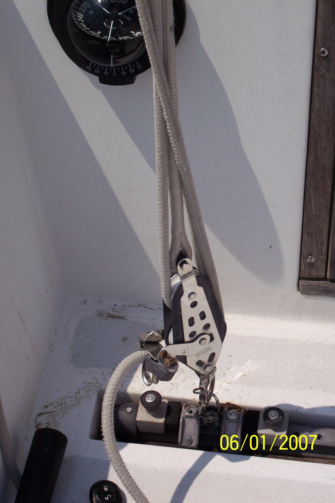

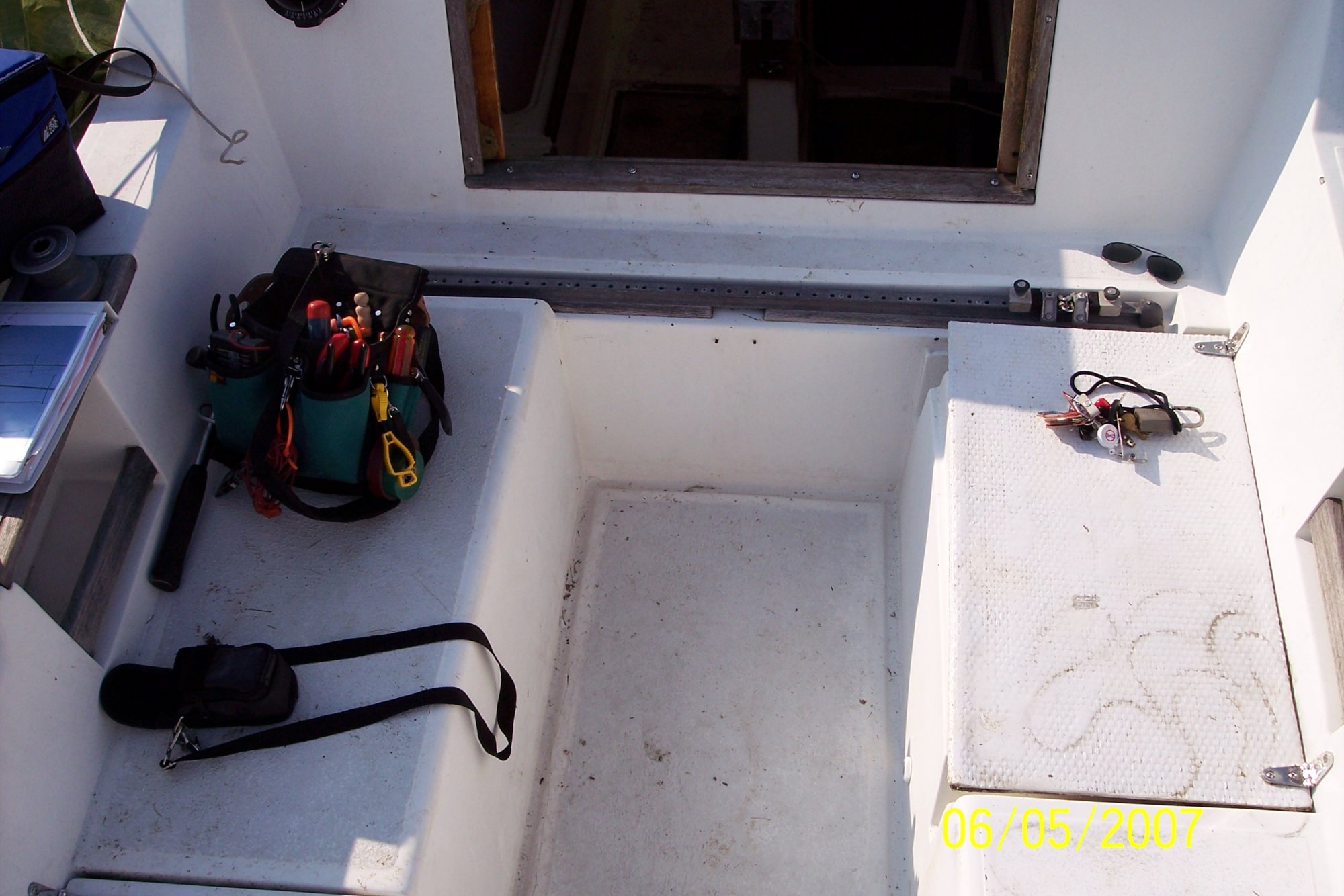

Howdy,
After 13 years of work / sail, I'm (finally) looking to change out the OEM main sheet traveler for my salvage 1981 H22 sailboat.
Has anyone out there swapped out that original pin stop track for anything else?
See the attached pix taken back in 2007 (...still unchanged).

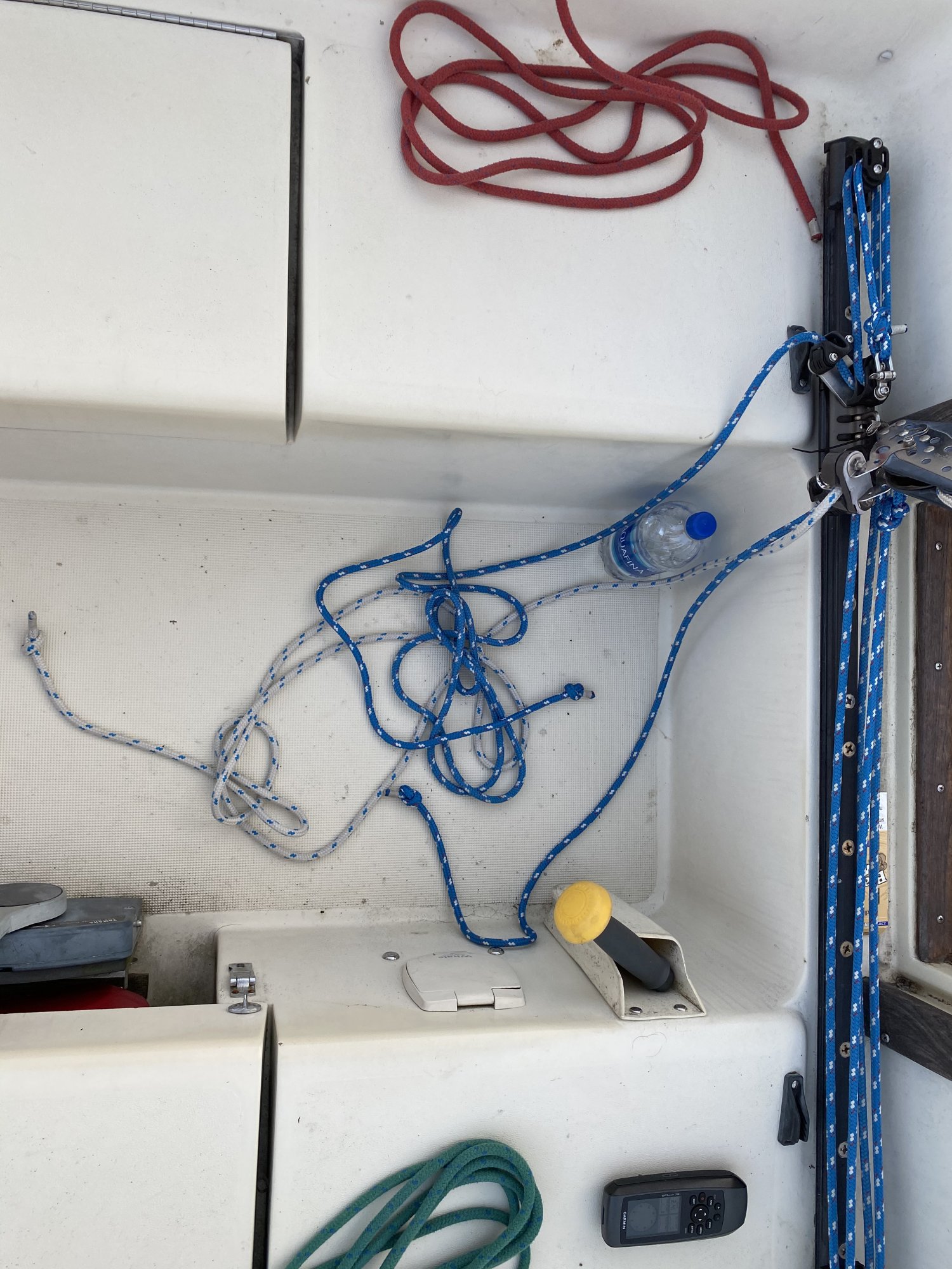

Looks like you have a Kenyon traveler.

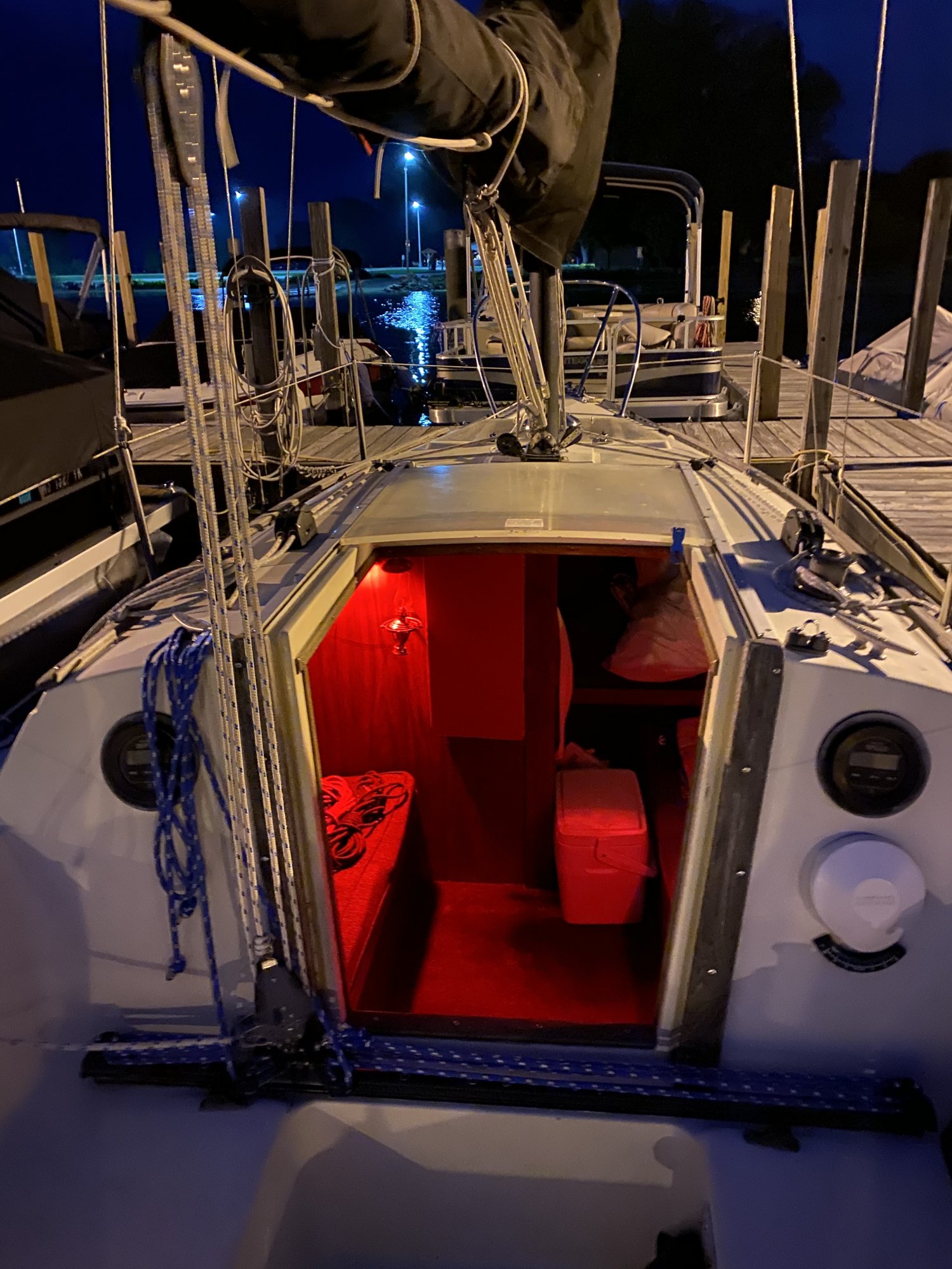

I don’t have a Hunter, but I replaced the Kenyon traveler on my S2 7.3 (23’ 9”) with a Lewmar size 1 (4:1 purchase) traveler kit a couple years ago. A size 1 is a bit of overkill for the size of my boat-a size 0 (2:1 purchase) would work, but I wanted the 4:1 purchase of the size 1 because I single hand and don’t want to fight my traveler. You should be able to use the same mounting holes for the track.

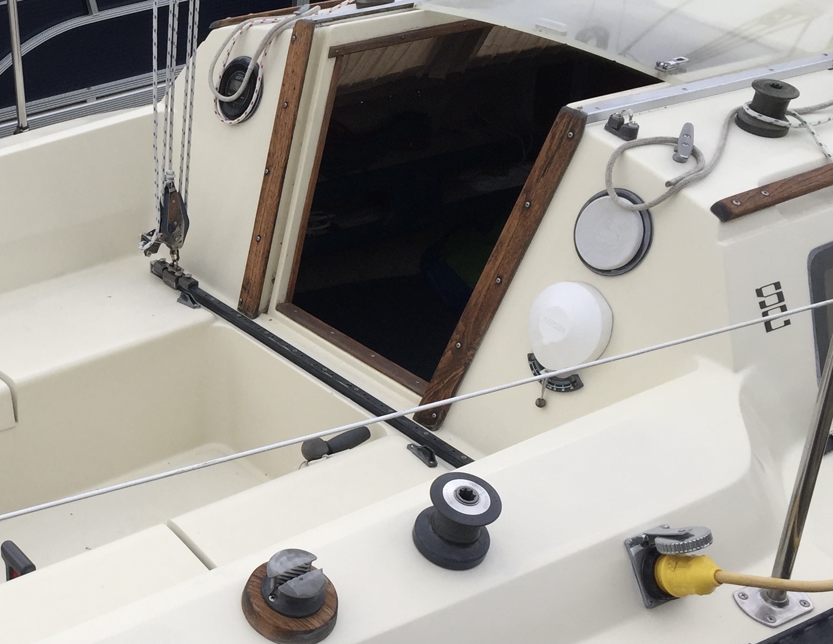

I set up something like the post above for my H23 but did not replace the entire track. I found a couple of the fittings that are at each track end online, used. On mine the cam cleats are on the end fittings. You can rig a single line fed through each end. I think there may be more details in the H23 owner mods section of this forum. I had to remove the track, grind the edges down a bit so the parts I got would slide on, and reinstall it. It is a lot easier to adjust the traveler position while sailing.
